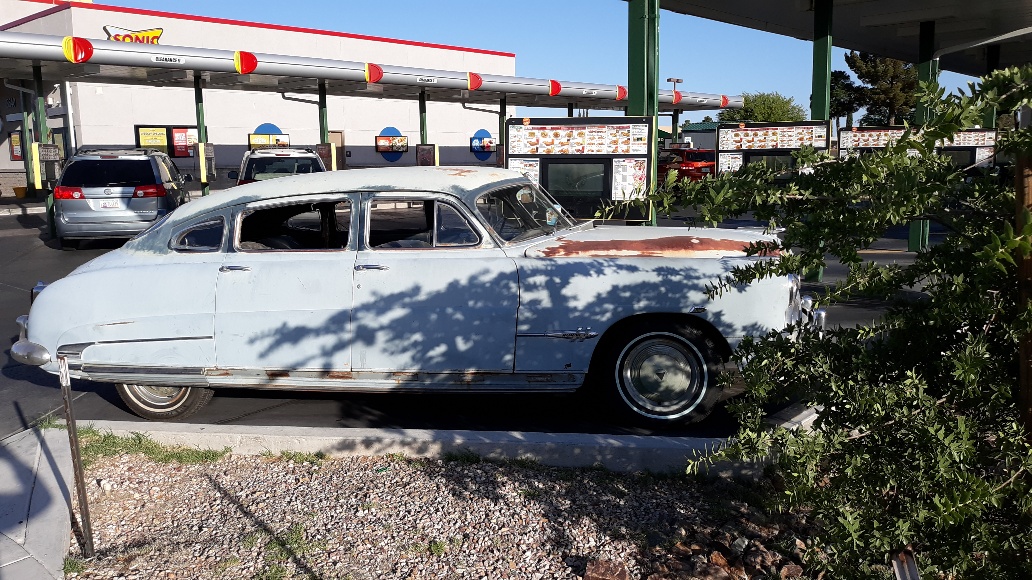

    It lives.
    This evening at Sonic.
