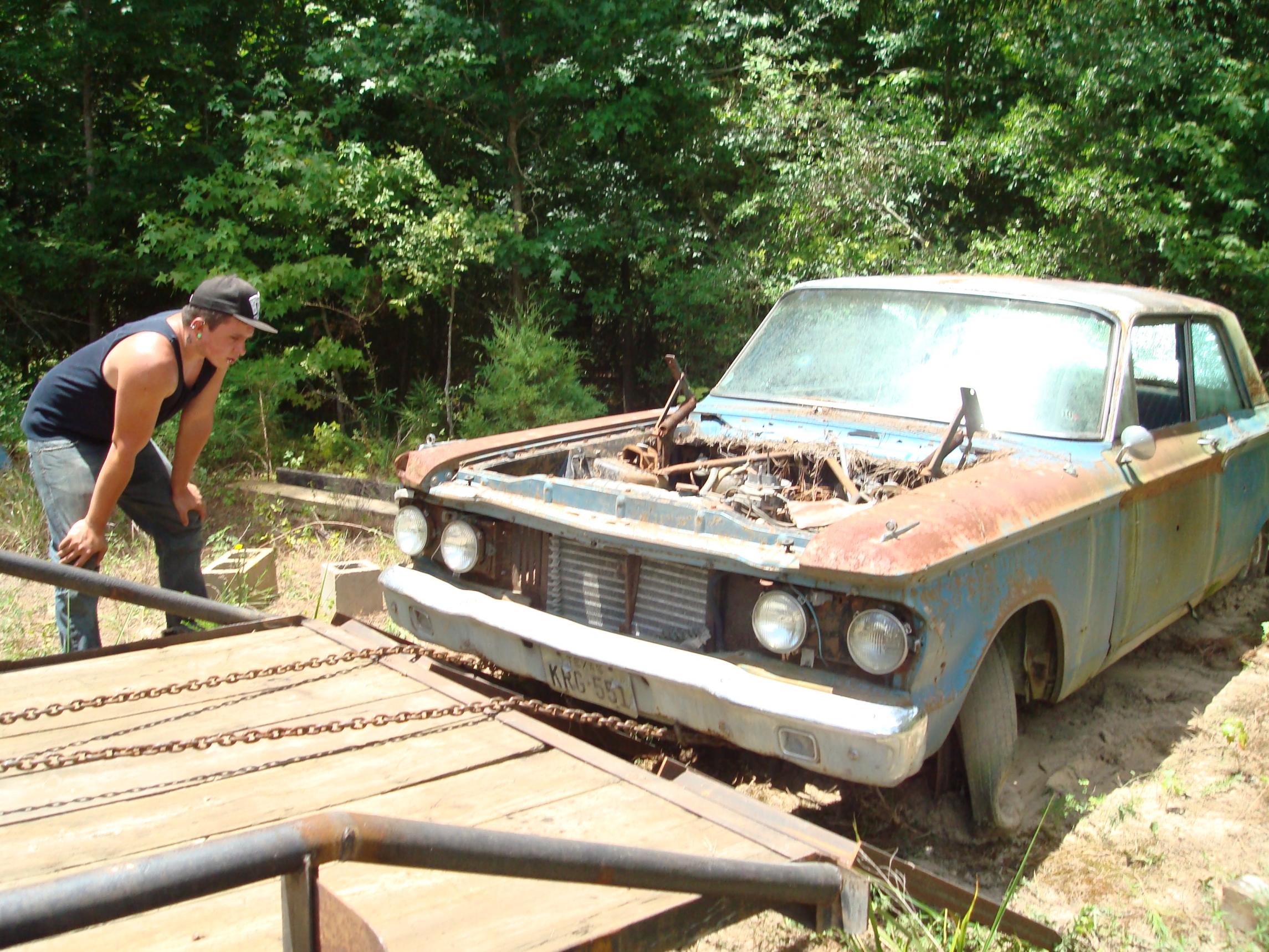

    here are some pics of me & my son loading the fairlane up .It had flat tires and the brakes were locked up.blocks,jacks,comealongs,water or gateraide save the beer for when you get it home. it was hot as all get out. bring some chains and tie downs too.

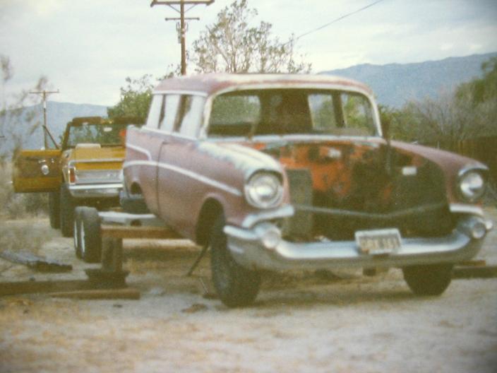

    This one had front wheels but same principle.
    Jack car up .
    Throw some wheels, blocks, firewood etc on the ground
    Stick a chunk of lumber across wheels, firewood, blocks
    Back trailer under car as far as possible.
    Come-along, winch, lever into position.
