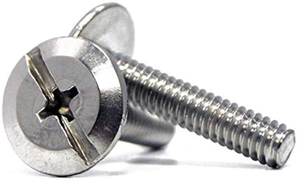

    I thought he was looking for washers to use with bolts. I agree with the comments about using good quality lock nuts when possible.What I have done is make some nut and bolt bins and then buy stock off of Ebay to fill them up. I save all the hardware I remove from any vehicle if its decent. I find that for building cars and trucks I need a lot of shorter bolts. While I visit Tractor Supply and buy bags of quality bolts for projects, I also like to stock up on "washer head" bolts that have serrations on the bottom of the head. They spread the grip out over a larger area and the serrations bite well enough to prevent loosening You can't hardly find them locally and if you do, they are expensive. I looked on Ebay and you can get 50 5/16-24 (fine thd) for about $20 and free shipping. These happen to be Grade 5. I buy lots of these bolts and keep the bins full. Really handy and I like them on my projects. Some of these should hold a fan in place just fine.
    Something else HAMBers might find useful is a "Concrete Bolt" supposedly for securing things during Hurricanes. It has a large head compared to the thread size and can work well for areas where someone might like a little extra support behind a panel or something.
    Here are some shorter ones with co**** threads to show what you can get.
    https://www.ebay.com/itm/200-Serrat...991574?hash=item41ffd48356:g:oLcAAOSwh8dcxFnf
    Serrated Nuts
    https://www.ebay.com/itm/600-1-4-20...lVQSFg:sc:USPSPriorityFlatRateBox!40109!US!-1
    Some Grade 8
    https://www.ebay.com/itm/200-Grade-...hash=item2ec33f88ad:m:m8u8rAPLmzDquuINRCs0MXQ
    Not that any of you HAMBers would ever need them, but its a good place to stock up on Metric nuts and bolts too.
