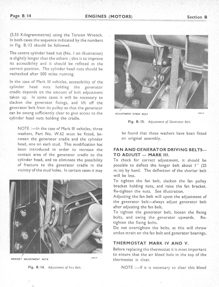

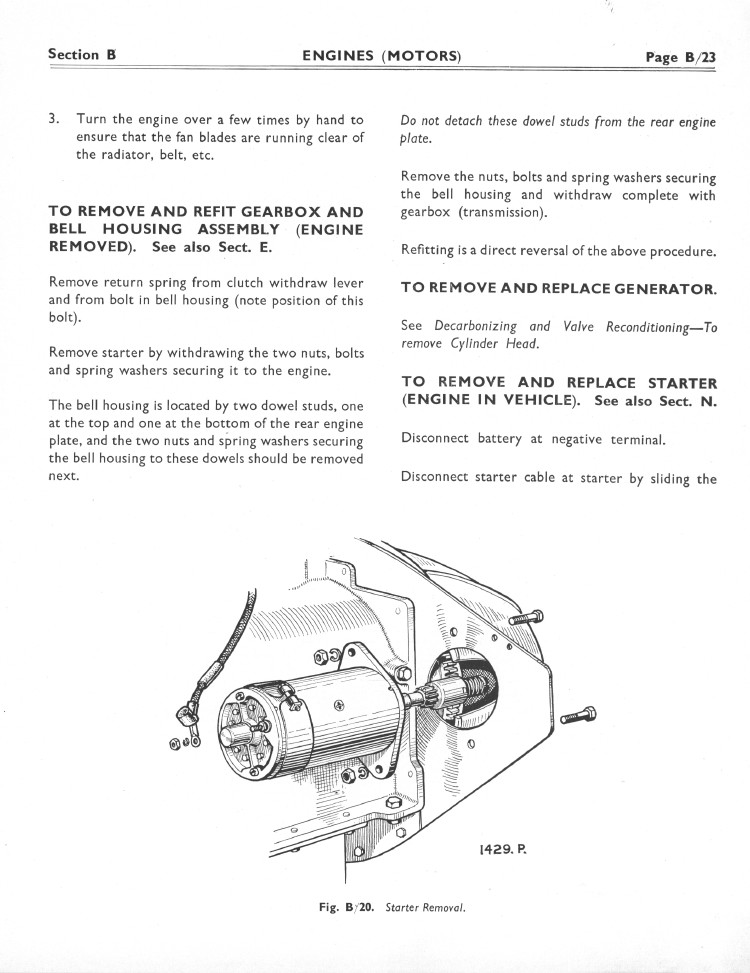

    Was it private or mechanics cutting corners...dunno but Janius I would suspect your generator had the ole split washer so perhaps a new one, some loc***e and proper torque for size of bolt would suffice. Loc***e would have been an extra thing perhaps as it can make dis***embly a bit more difficult.
    One thing to consider is where the bolt or nut sits on a slotted surface a heavy flat washer would be appropriate on lock washer side to give a full surface to seat and lock to.
    Again find a mechanical diagram or seek out a car of your type...Just gleaned this of the net this will point you in the right direction. Very thorough manuals...albiet a little difficult to find the info you are asking...o_O No mention of value for torque on gen bolts however you can use a general chart to determine a value to suit. Perhaps a GM generator bolt stackup diagram could be found as they look very similar.

    OMG, those are shop manual pages for a Hillman Minx!!!

    Hey Janius I was snooping around the net for repair diagrams on your generator and found that Hillman site with scanned manuals and happened into a past auction that I posted late yesterday that had a Hillman and numerous other cool potential rod custom material.
    The HAMB team here has given you lots of help in what to use to keep your generator tight. So yeah glean from the info here and git er dun.
