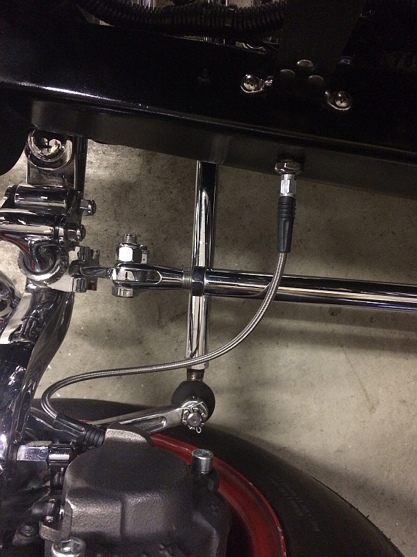

    I thought about the hose (uses stainless braided lines like shown) and I did consider that, I guess that's where I start.
