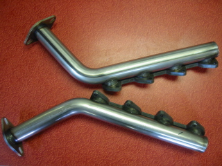

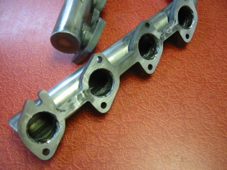

    So my project of swapping a 302 into my 1954 ford has reached the point where I need to put some exhaust on this thing. Now due to my lack of planning, I have extremely limited space to run headers. I need to fabricate them myself so I bought the kit from speedway. however, I don't think that I will be able to run individual pipes for each cylinder. So i began creating something similar to a "lakes header". Except mine is made entirely out of 1 5/8" inch tubing. I noticed that on most "lakes" style headers the big pipe that the primaries join into gets bigger as it goes back. (stick with me here I know this is probably hard to explain without pictures). Today I did more research and found something called a "log-style" header which I think would work as well.
    My question is, how much performance will I lose by making the entire design out of the tubing which is the same diameter? If I build my "lakes" style design without the pipe increasing in size as it goes back, will this harm my engine/cause strange things to happen?
    -Also, has anyone used a "log-style" header before? It seems like this design wouldnt have very good flow, but it would fit perfectly and be relatively easy to make. I'm pretty new to header fabrication techniques so bear with me. I'll try to post some sort of pics here to provide a visual aid. Any help is appreciated!
    -I'm attaching some photos of "log-style" headers below. Would these cause backpressure issues or redce horsepower a lot?

    This is my home made flathead header. 1 3/4" then it steps up to 2". A 2" log manifold will work just fine on the street where you rarely go above 5 grand. You could increase it to 2 1/4" between 3 and 4 but that's as large as I'd go if you want 2 1/4" exhaust pipe. An 1 5/8 log is too small. IMHO
    All the racers design their headers for WOT. The log type won't perform at WOT as well as racing headers.
    Hedman made headers back in the day for engine swaps and not for the highest HP. Many were a log style. I like them because they look old to me. Looks are more important than an extra tenth in the quarter mile to me.
    Stabbing the primaries directly into the side of the log at a 90* angle creates a lot of turbulence inside that restricts the flow. A "Y" connection coming in at an angle is better. Besides they look prettier.:D
    Don't get tempted by the bigger is better mantra but there is a good street compromise. You don't need huge pipes for a street 302. IMHO

    All you have to do is look at 352-390 stock FE exhaust manifolds to see that it won't hurt the valves or the engine. I like to call them bricks. The exhaust will find it's way out. The idea is if you are going to make some, make them as graceful as you can. Nobody was born a fabricator. You have to start somewhere. Use U-bends for the primaries instead of straight pipe. Tin snips can be used to work up to a good fit. The more you try the better you will get. You might end up with some scrap pieces but that's OK too. The experts never show them.:D
    These sure are not the prettiest headers but I did want the home made look and they HAVE to be better than the stock 352 bricks. They look pretty descent after blasting and painting. I wanted them to look like they were made in 1964 and not 2004.
