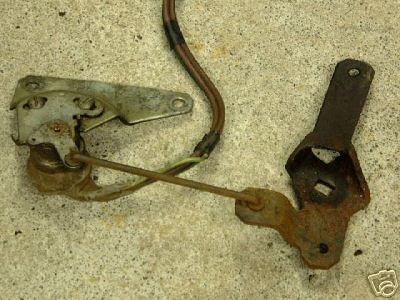

    Maybe one of Lokar's neutral switches that mount on the pan rail and have a trigger on the shift shaft would work.
    Ron Francis has a kit that uses normally column mounted switch on a bracket off the pan rail.
    Looks easy to duplicate.
    As another do-it-yourself alternative: you could hook a rod to the shift arm to link to an old Chevy van neutral switch.
