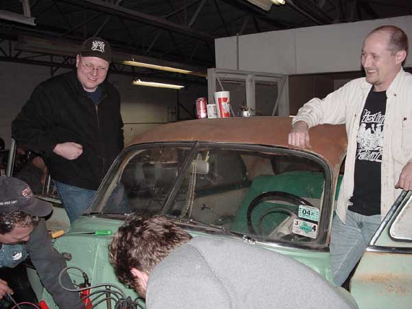

    Three shots from Tuesday, Feb 17th, 2004. Worked on putting in an entirely new wiring harness. Also spent a lot of time scratching our heads on how to make headers clear the steering box on the drivers side. If anyone has some junk SBC stock REAR DUMP style headers, I'm positive Mark could use 'em!
    First pic shows "the mess"

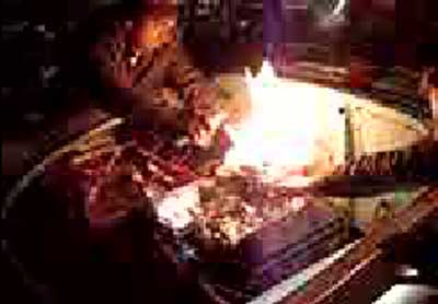

    The wiring is all in the car. We tried for about an hour cranking the car to get it to fire. We finally found out that when the ignition switch in just clicked to on, we have power to the coil, and the points fire, but when you turn the key to engage the starter, power to the coil is cut, and the points don't fire while the motor is turning over. Temporary solution was to put a jumper wire directly to the coil, so that we could crank the motor, and the coil would have power to spark.
    This is when the BALLS OF FIRE began. Damn, that starter fluid makes for a great light show. I took some small video clips with my still camera, but don't know of a place to host them. Here are some stills from the video.
    The guy with the striped Beenie is MarkX. Here he's wedging the throttle open.

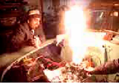

    Now he's spraying starter fluid down the throat as Flt-Blk cranks the motor over, and WOOSH! We have lift off!!!
