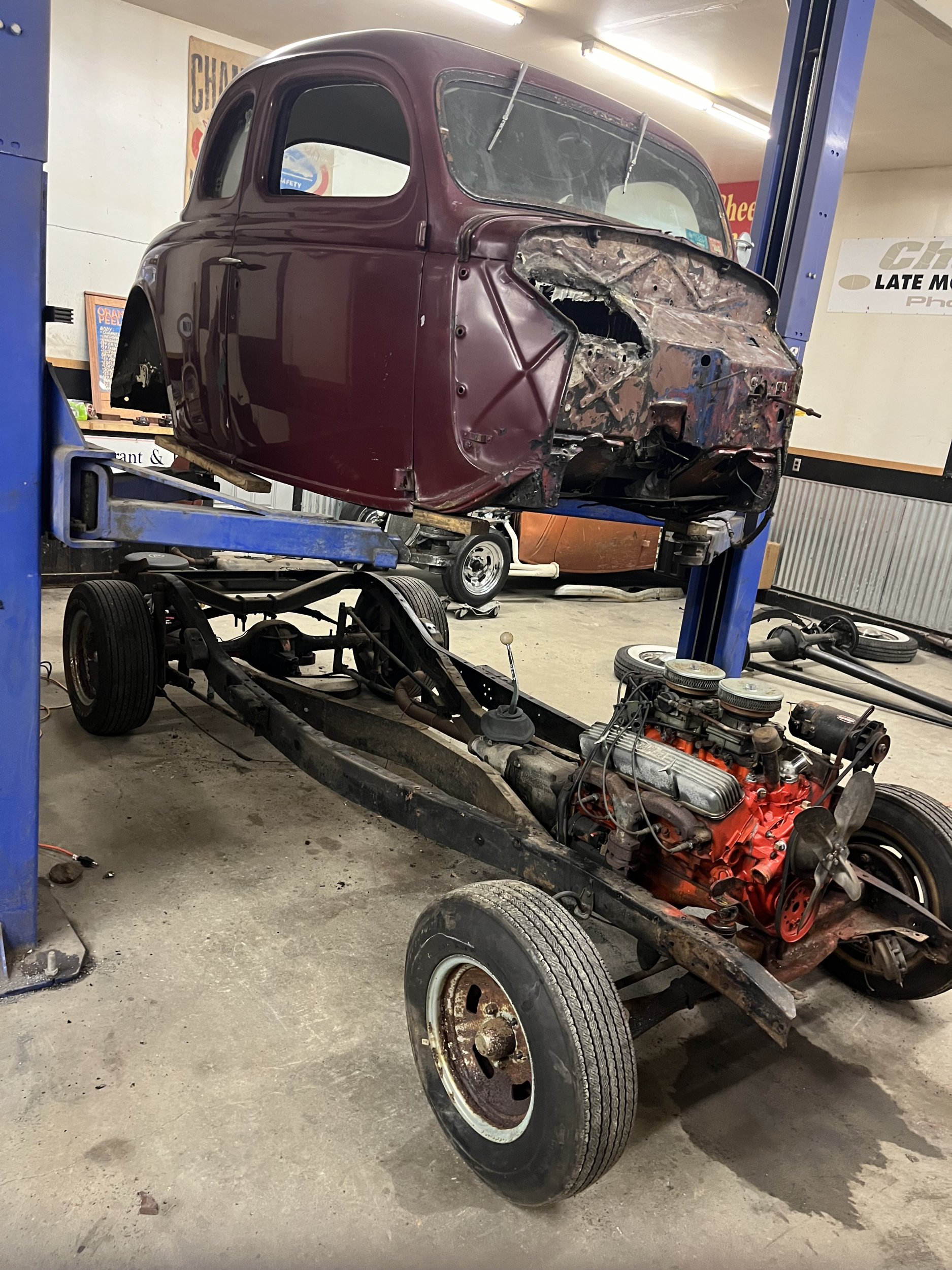

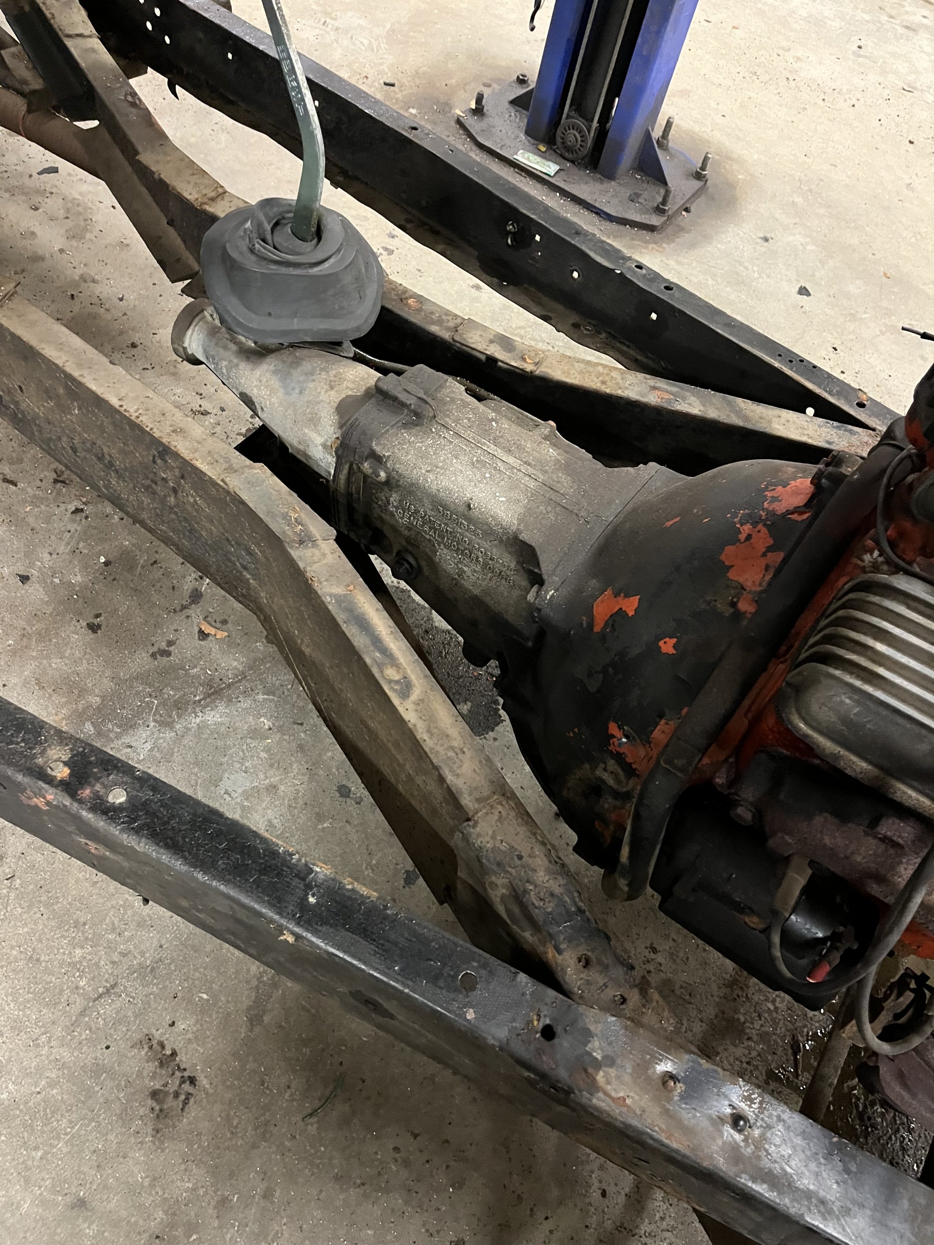

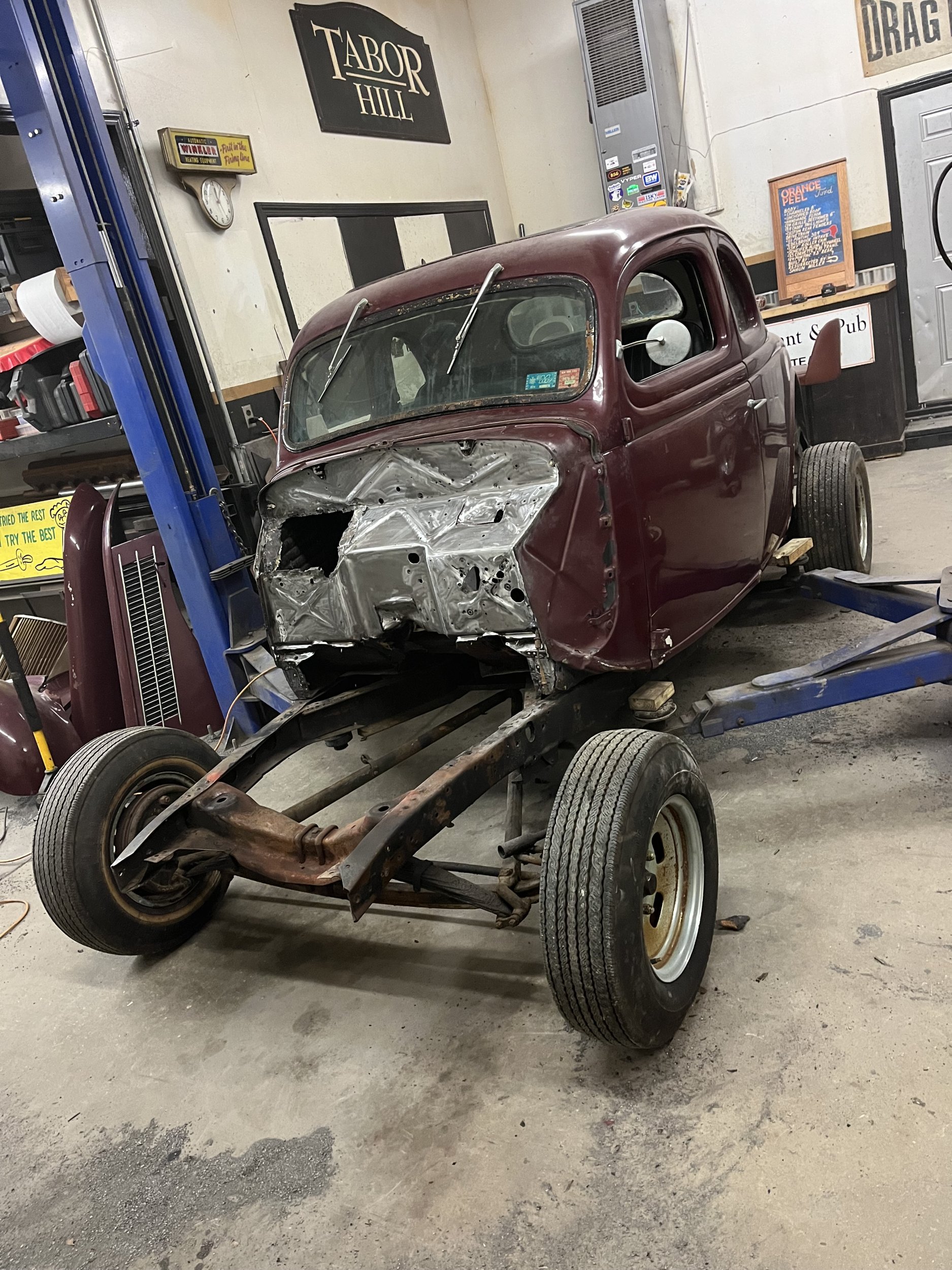

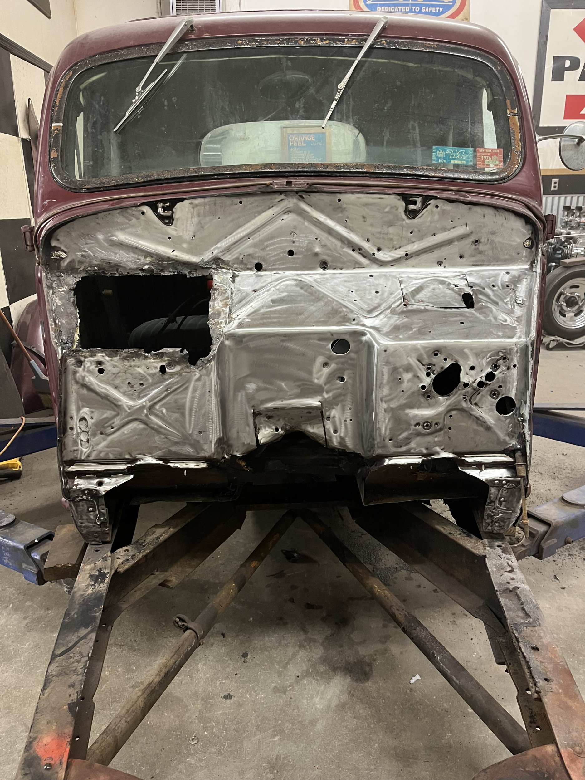

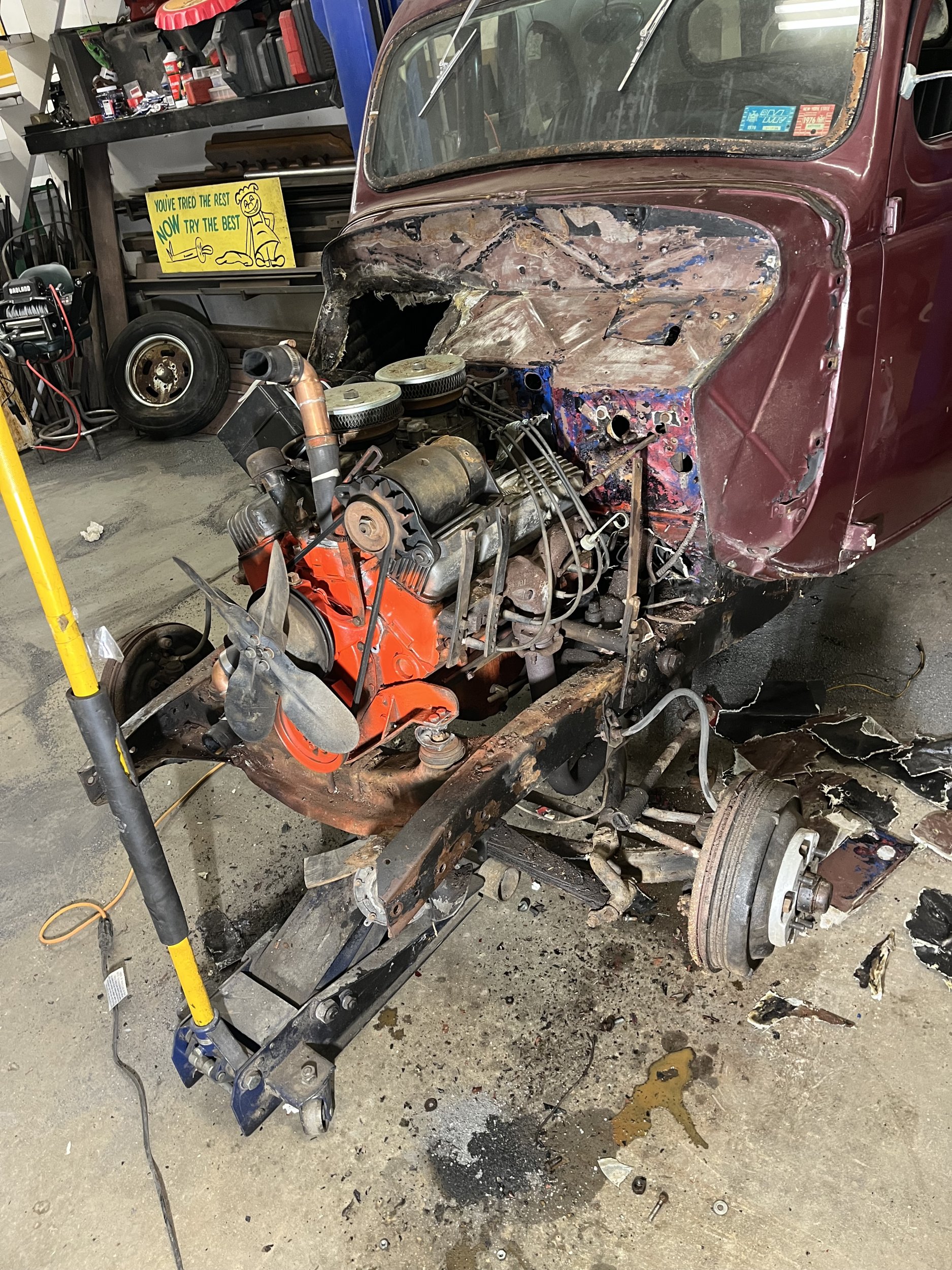

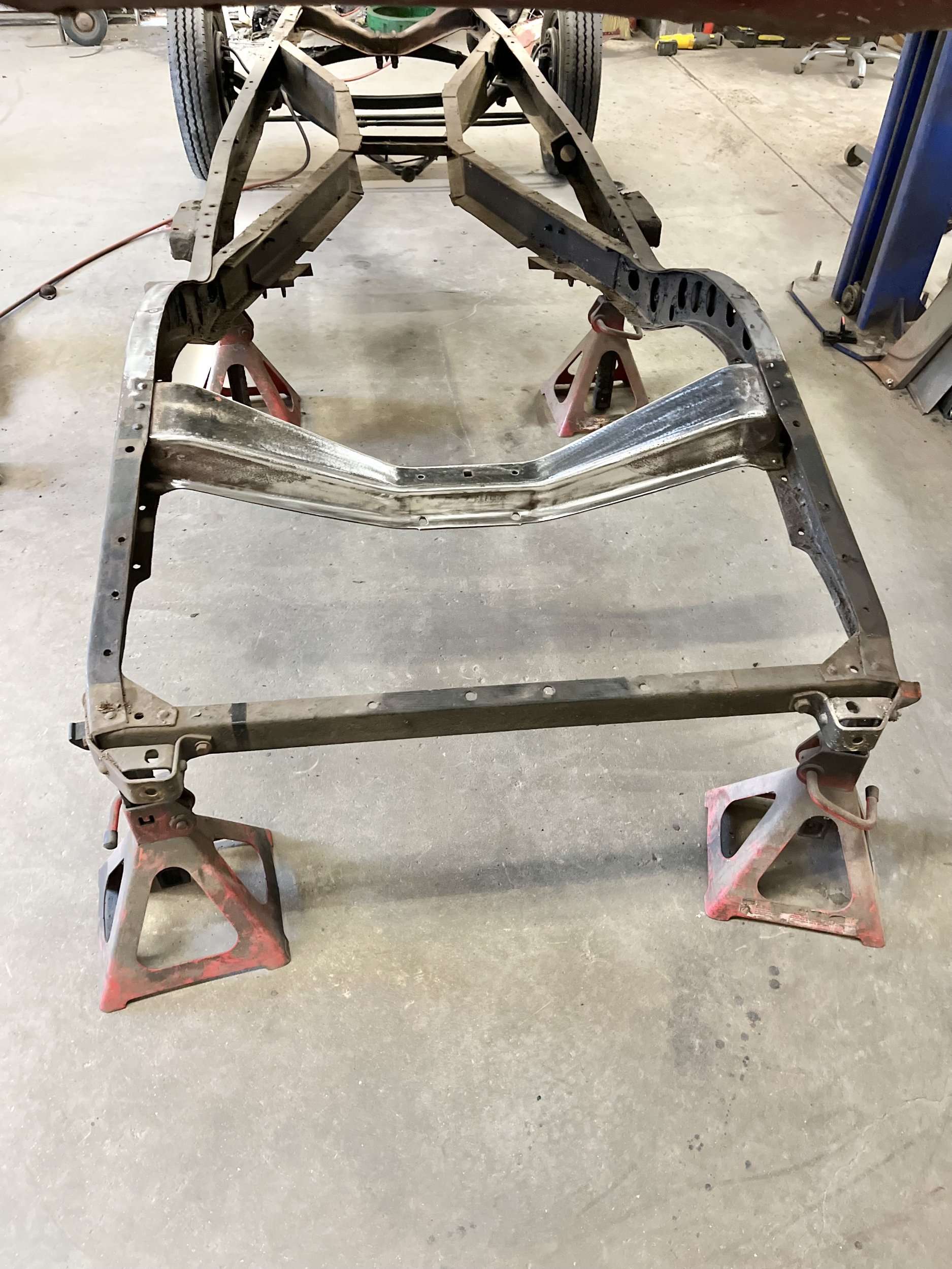

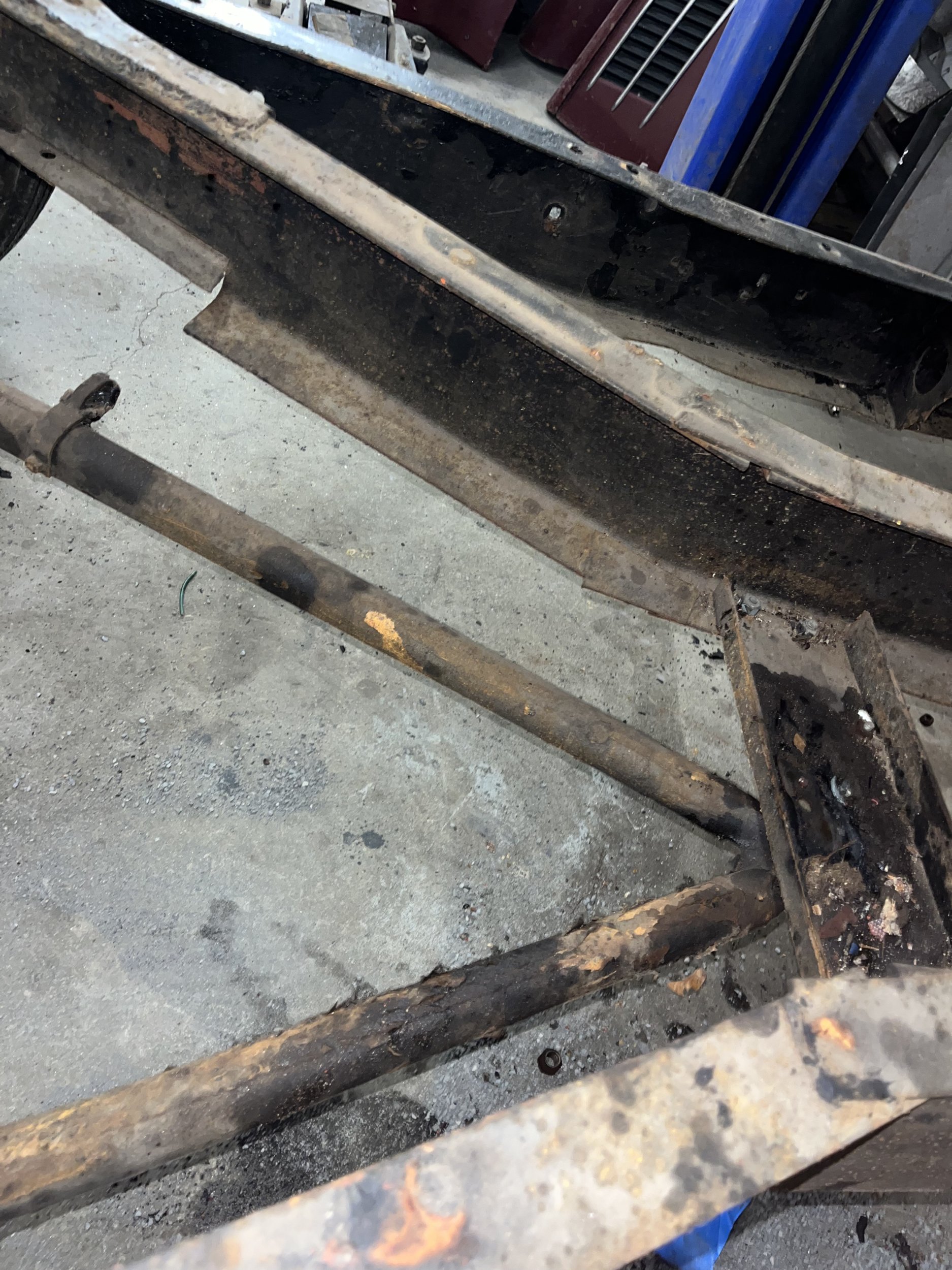

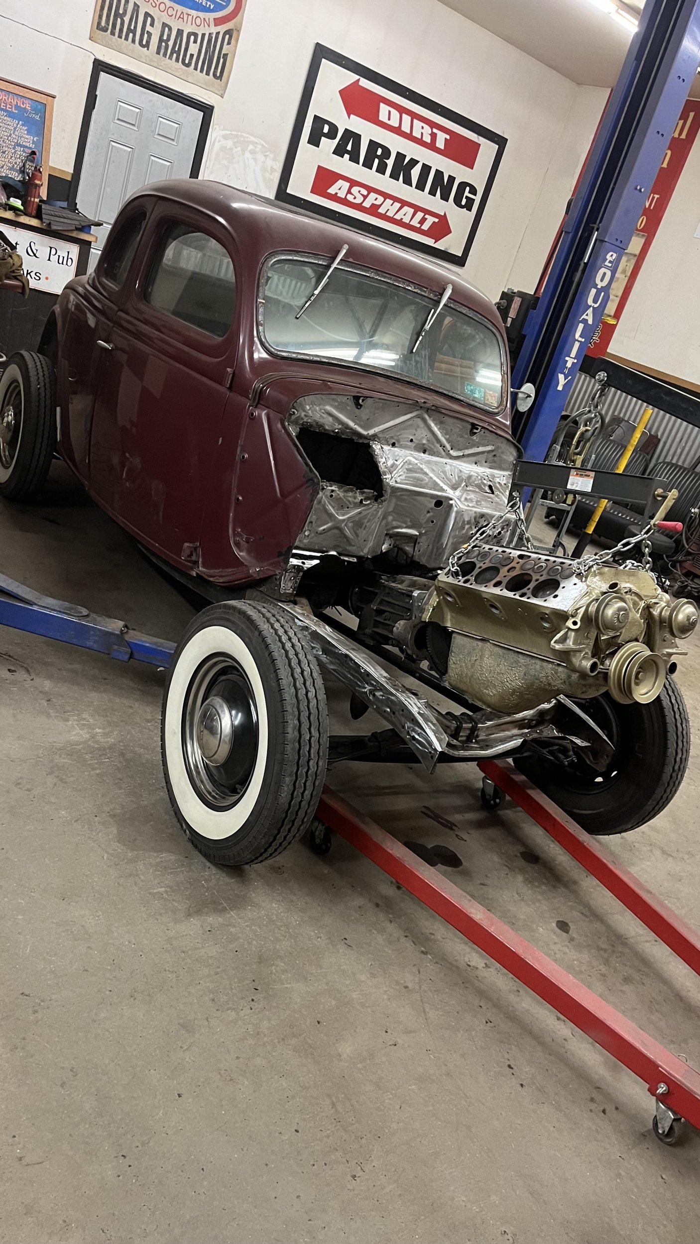

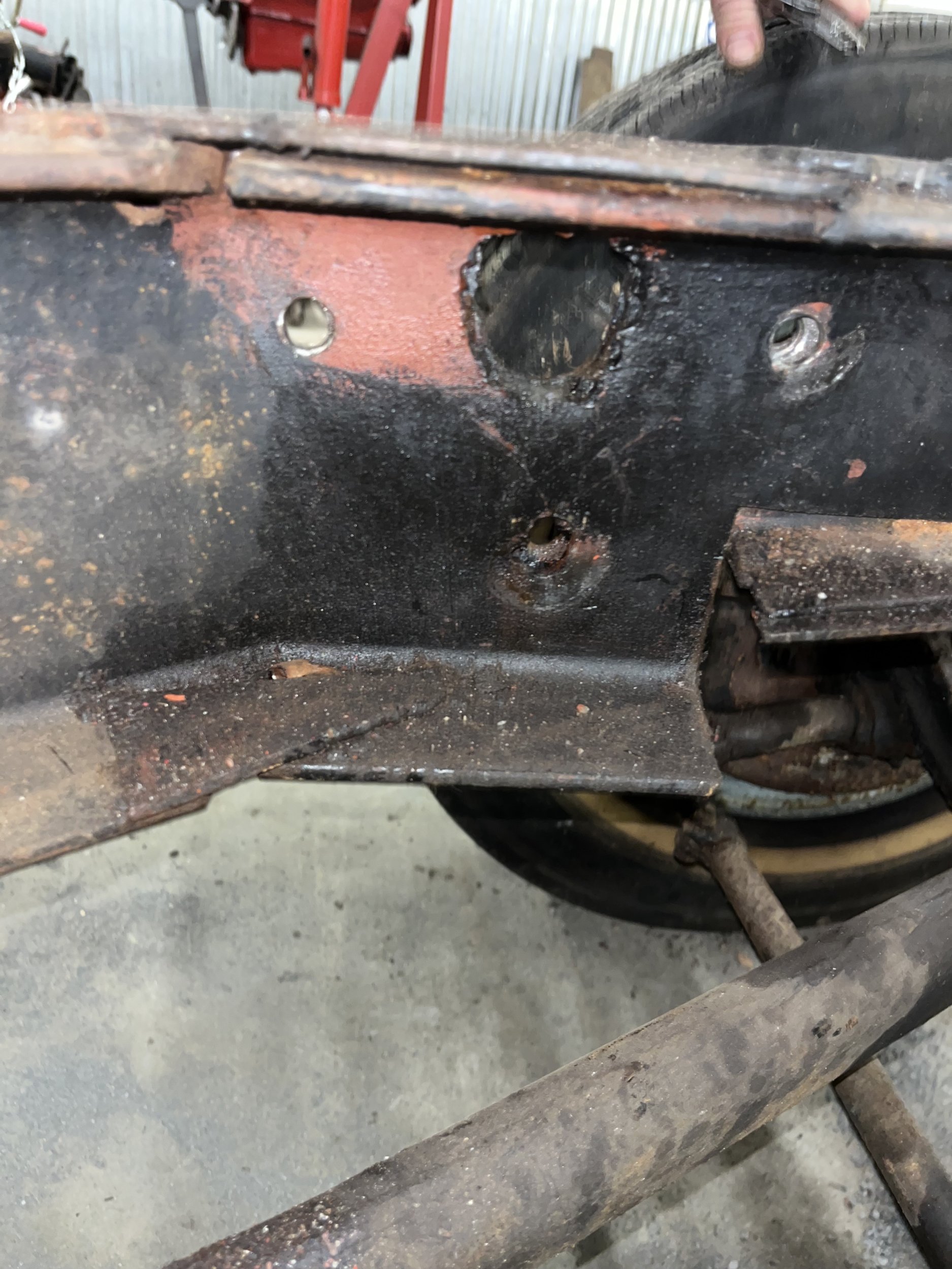

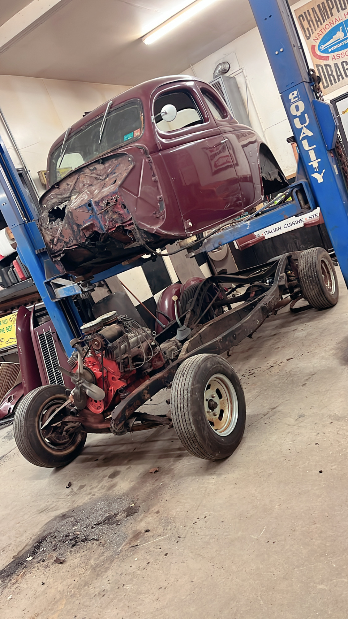

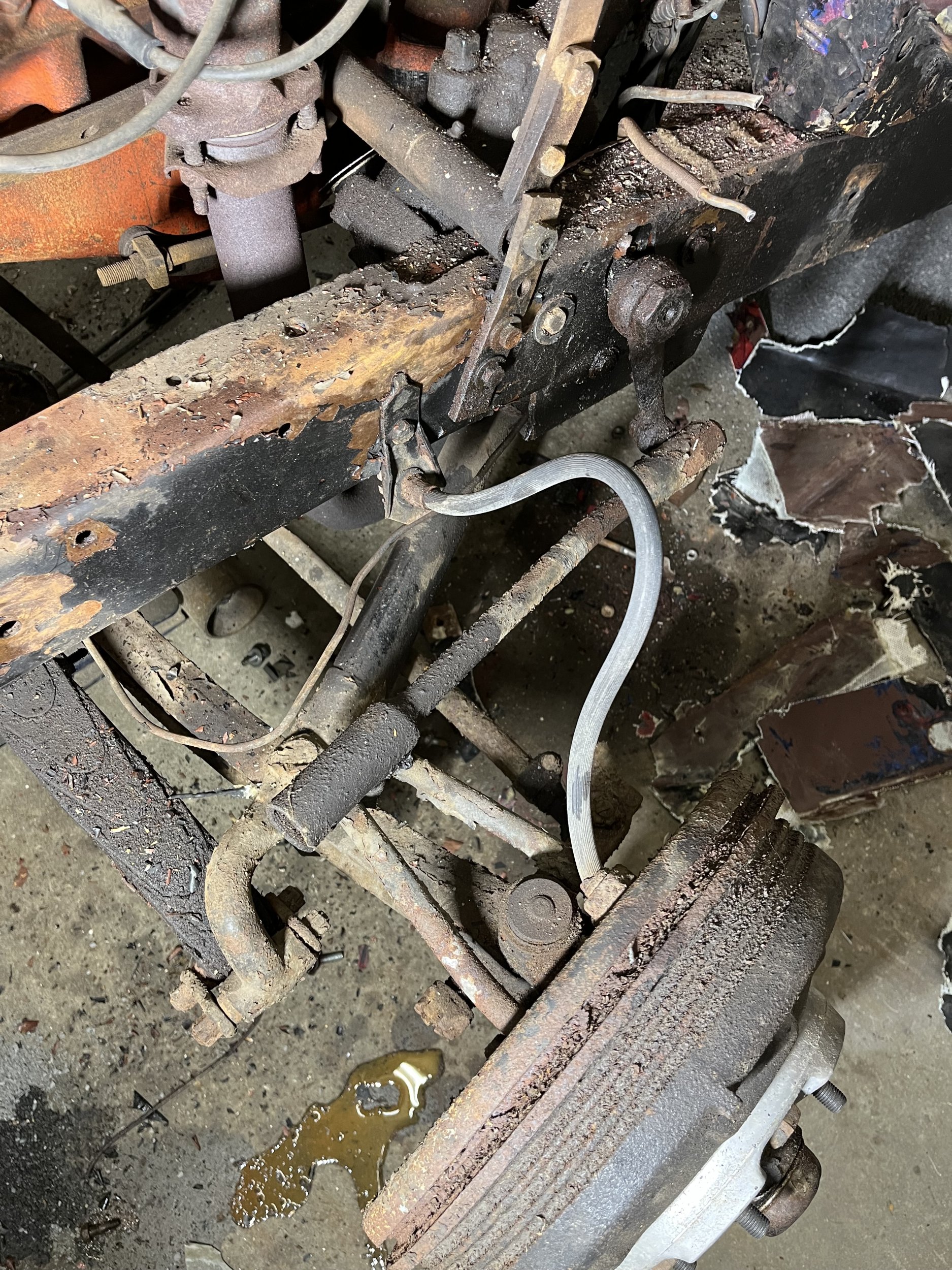

    So here’s where I’m going to lose some of you guys…

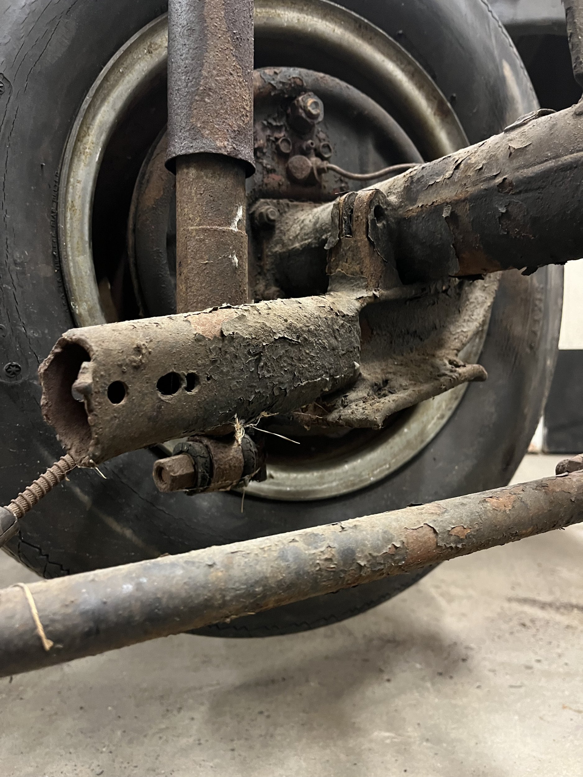

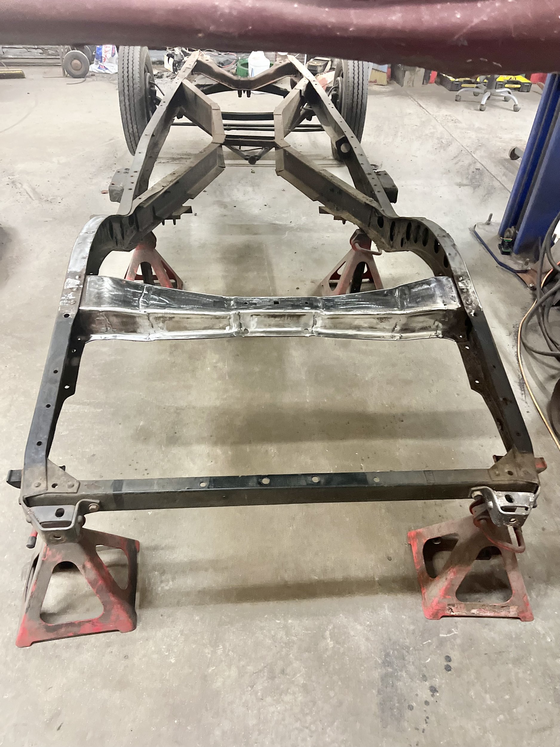

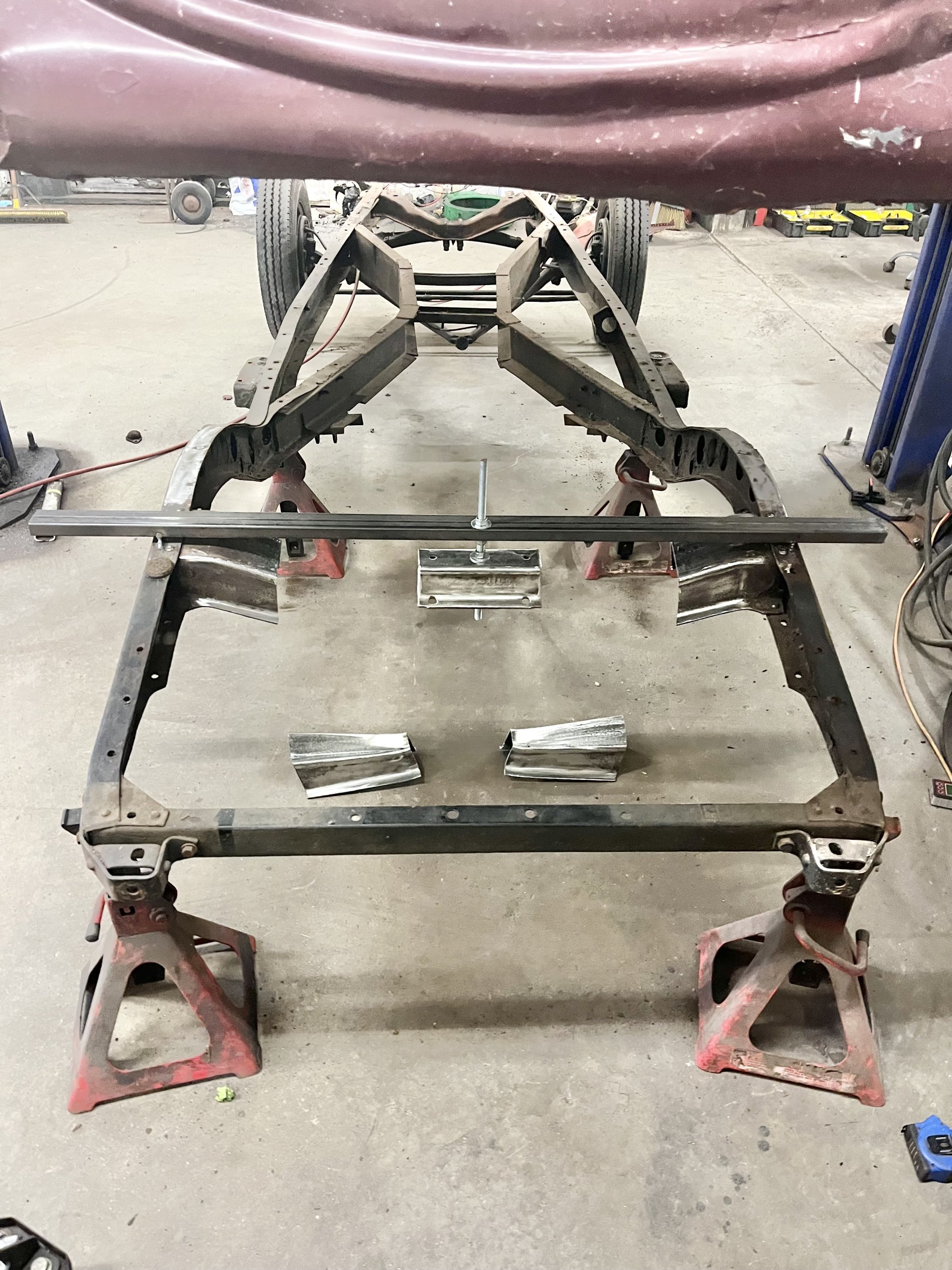

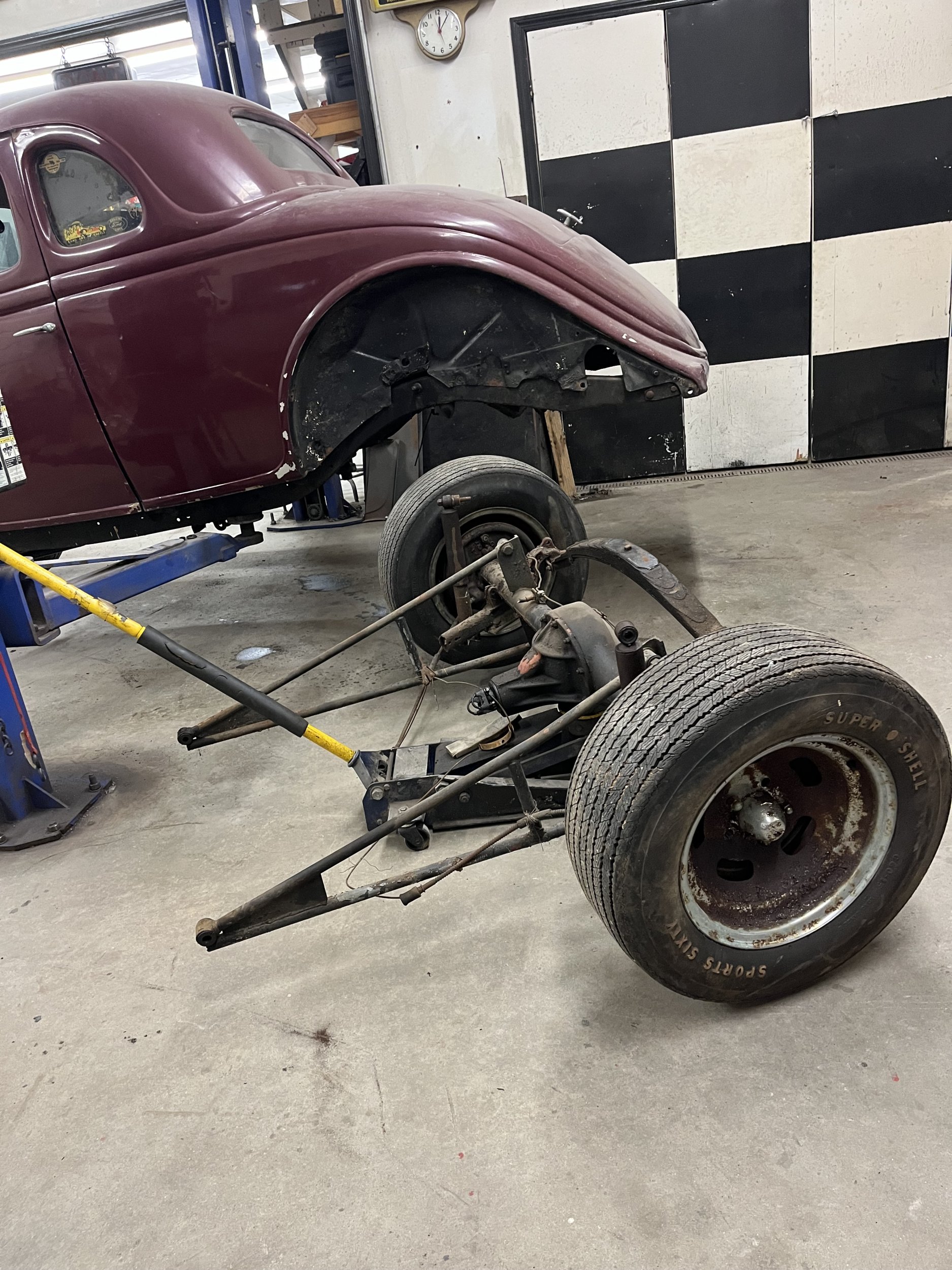

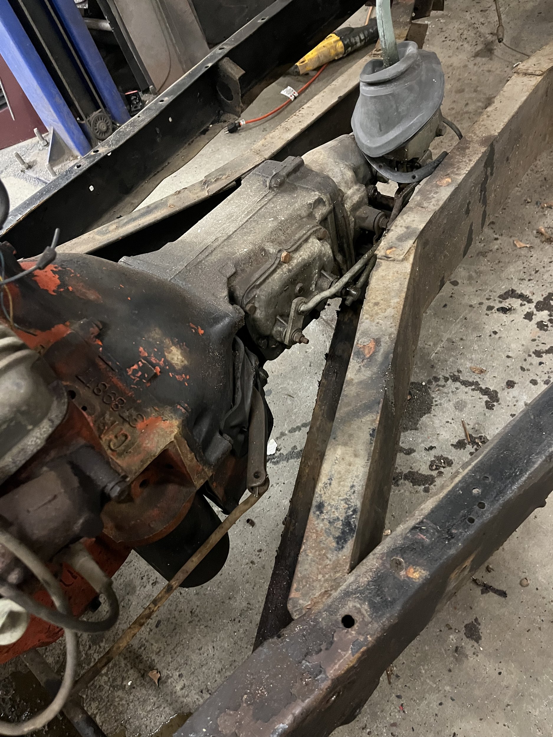

    My initial plans were to just go through everything, and kinda leave it how it was built. But the more I kept digging, the more apparent it became that the car needed to come apart.

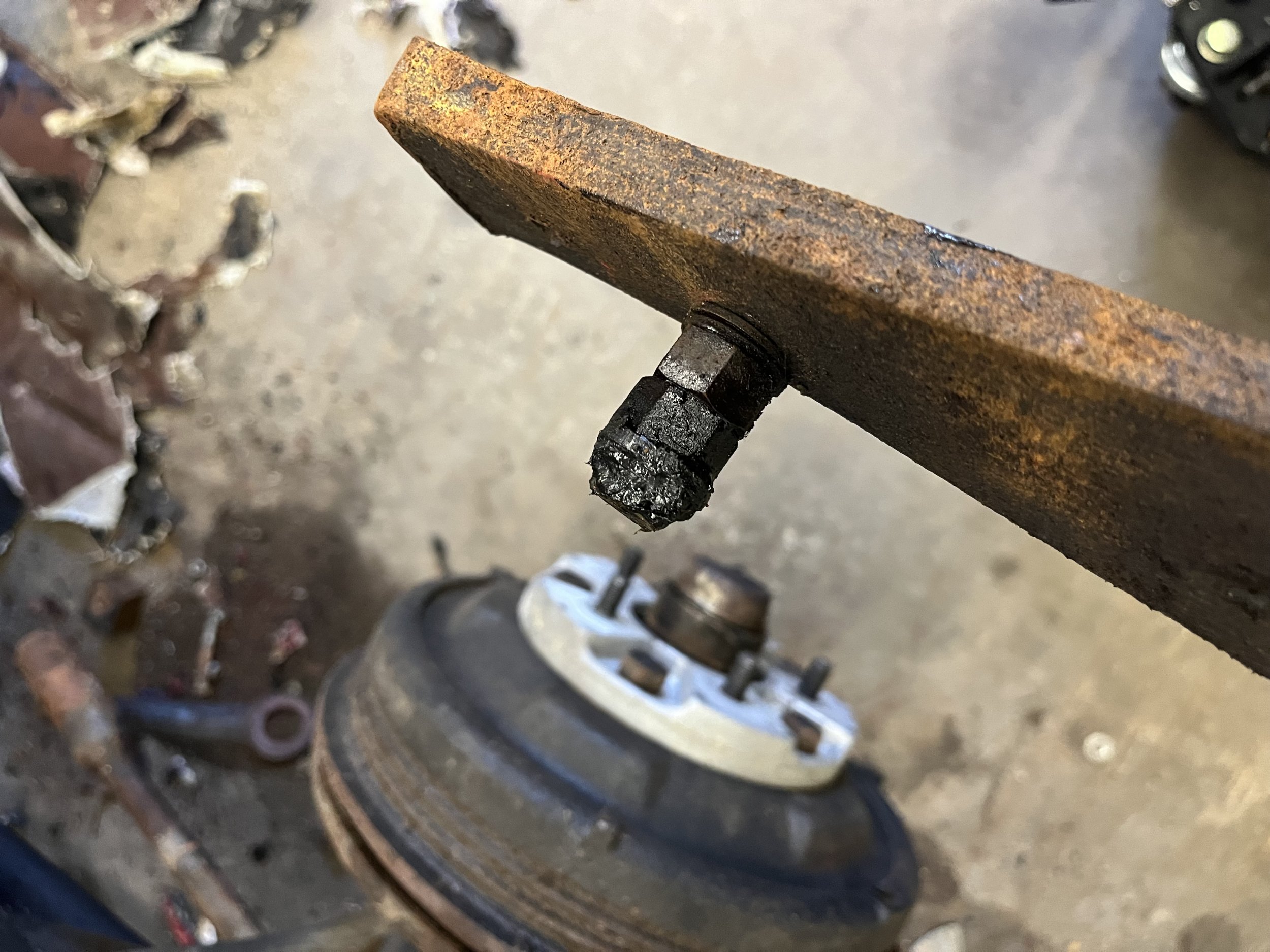

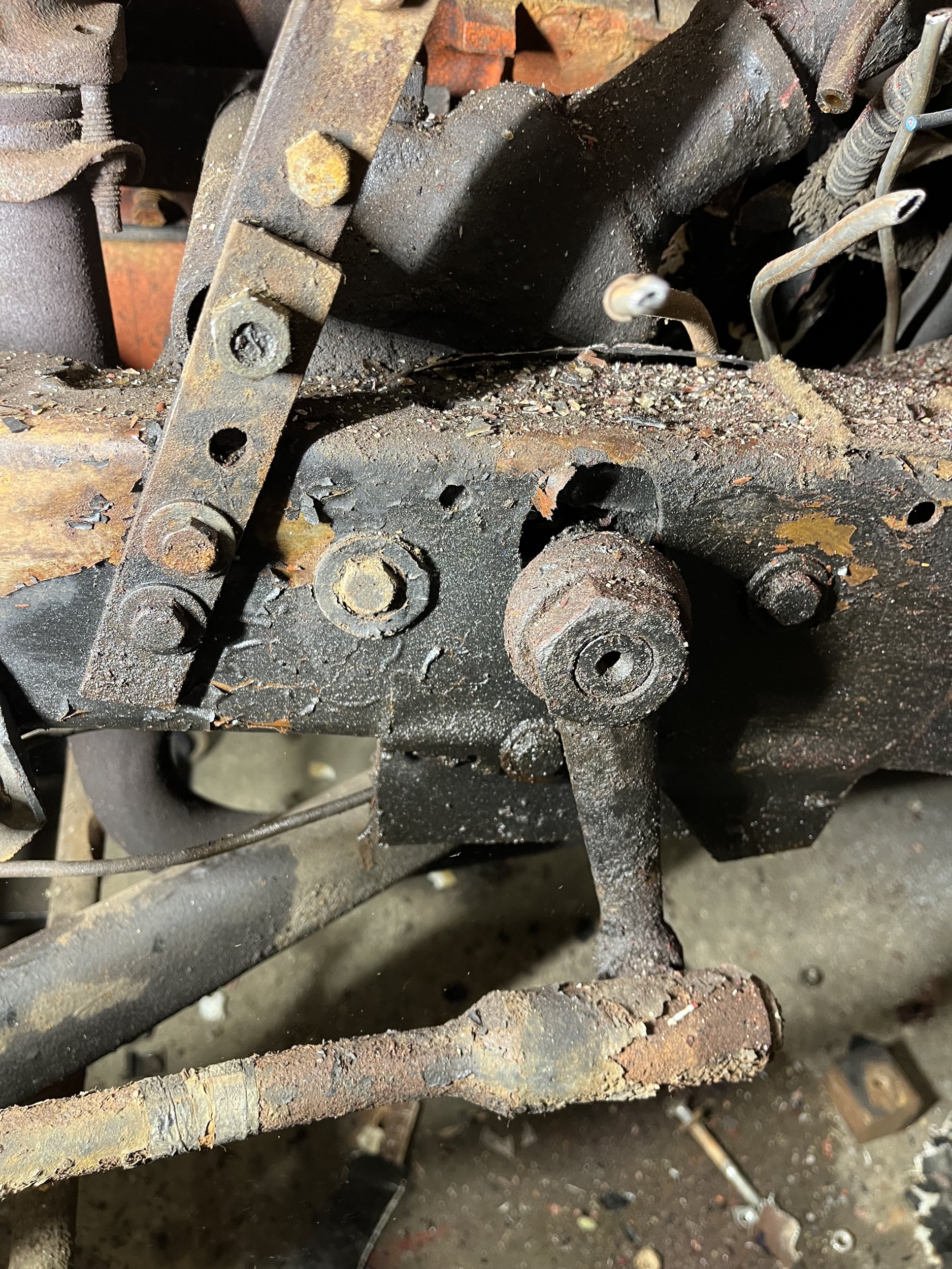

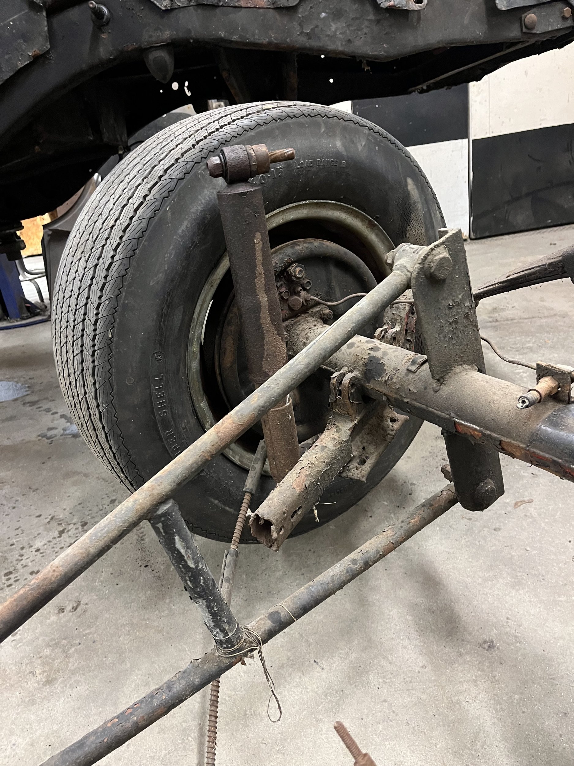

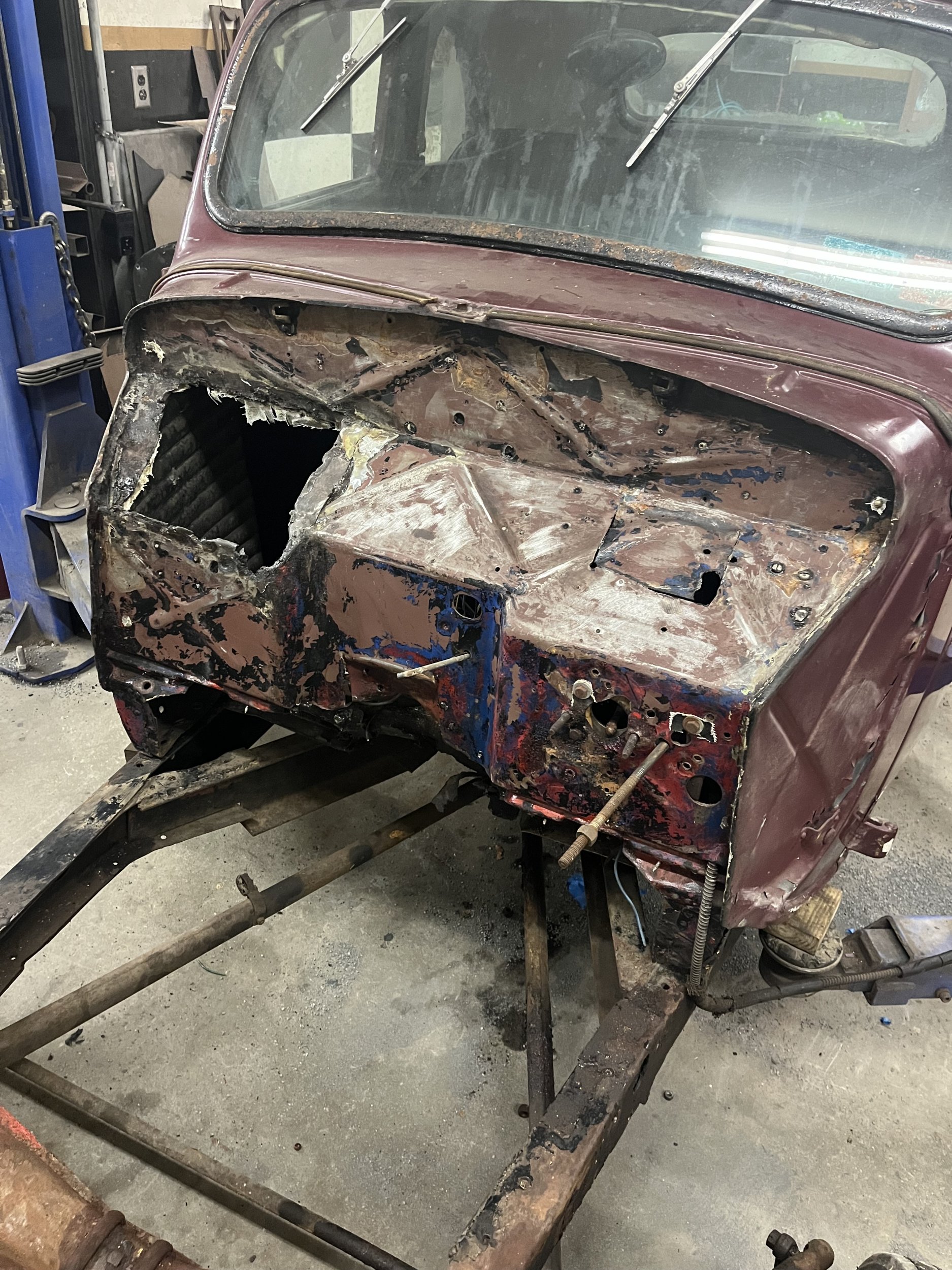

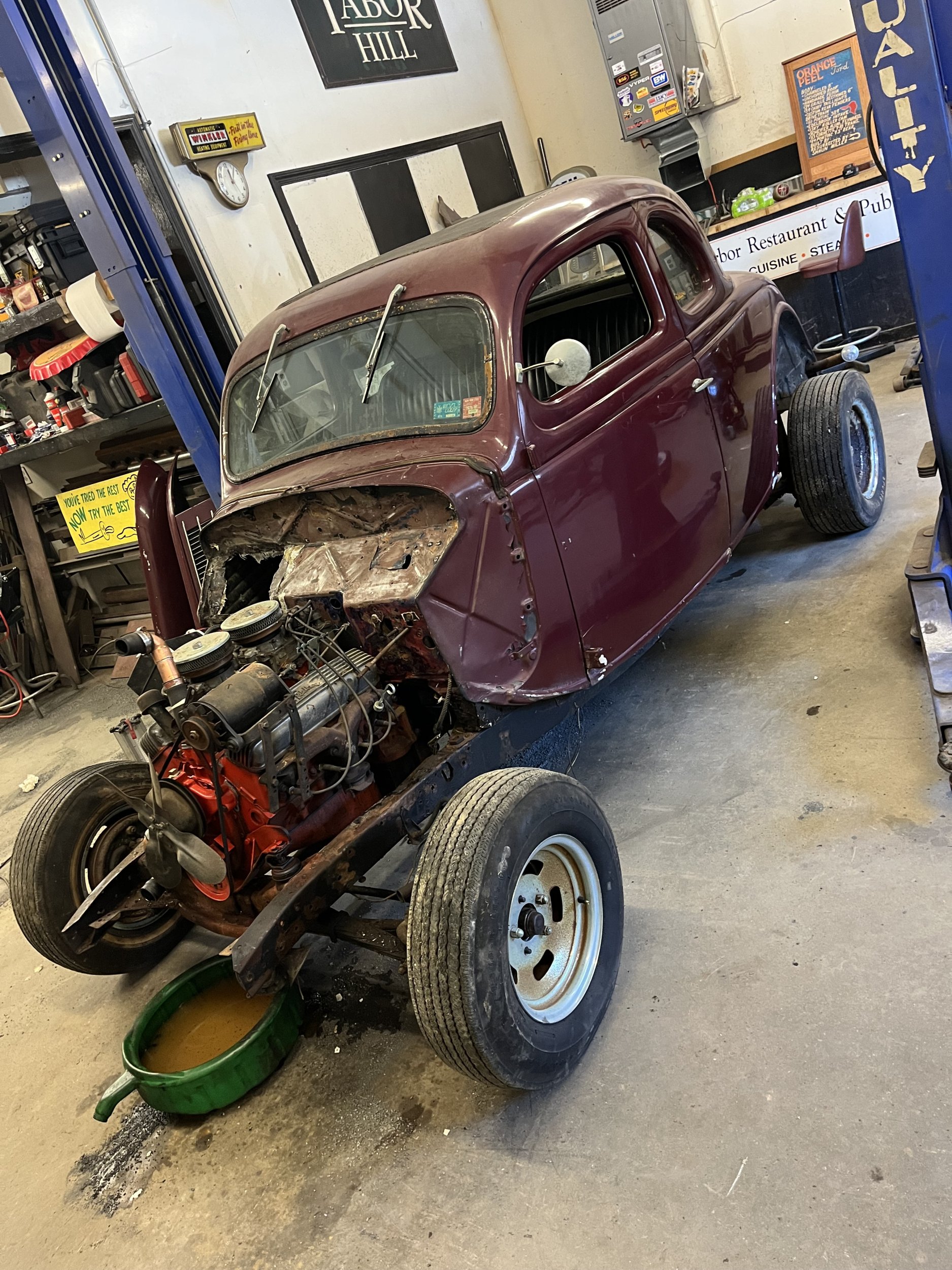

    When I first saw the car I was impressed how solid it was, until I crawled under and checked the ch***is. While the outer rails are pretty good, the X member had been hacked out, and huge, heavy channel iron used in its place. I think this came about during its drag racing days in the 60’s.
    A little further back, the rear suspension was a little…. Wonky. Someone had welded stock radius rods onto a 55 Chevy rearend, but then torched them off about a foot out! At that point some m***ive ladder bars were adapted on. The top bars were actually bent down from where they hit the body… Quite the bump stop!

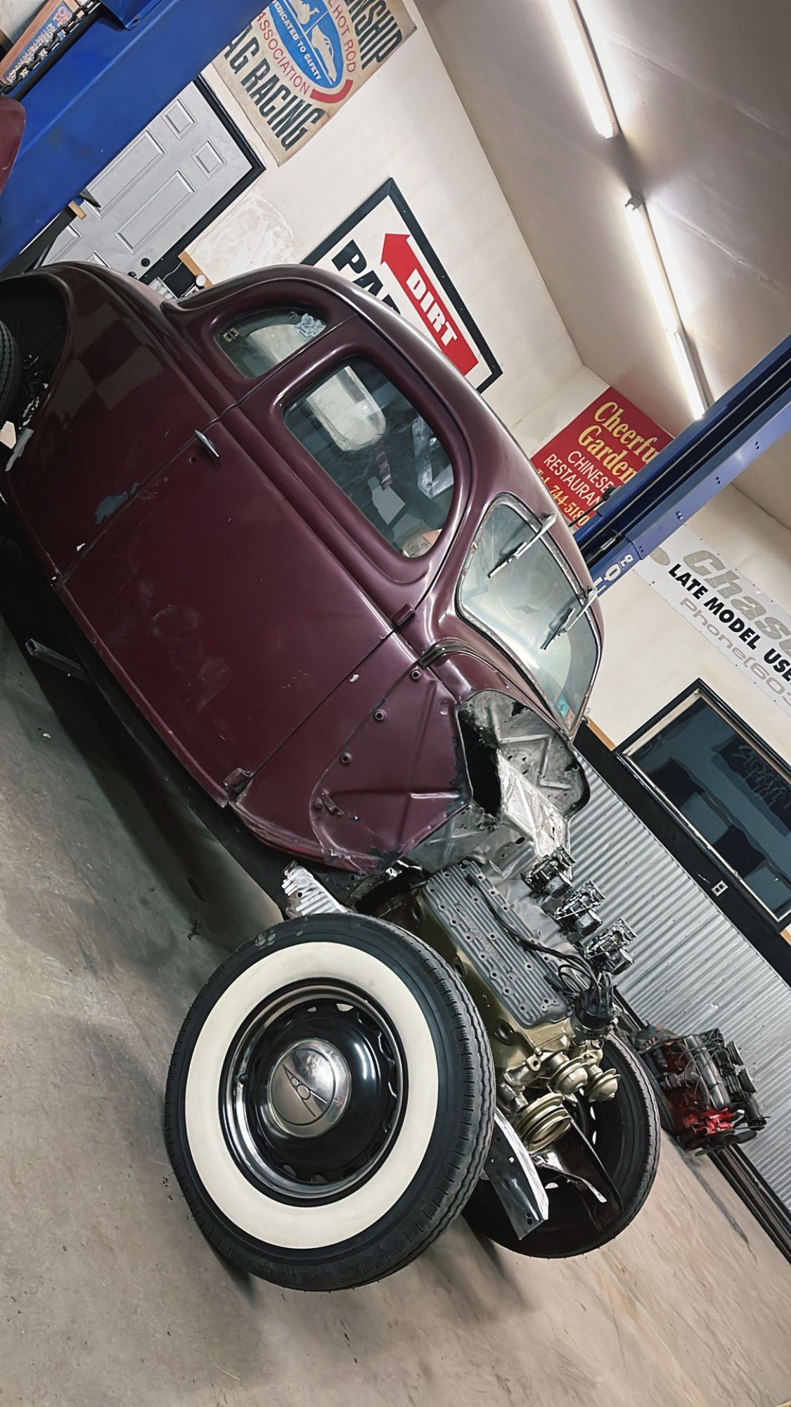

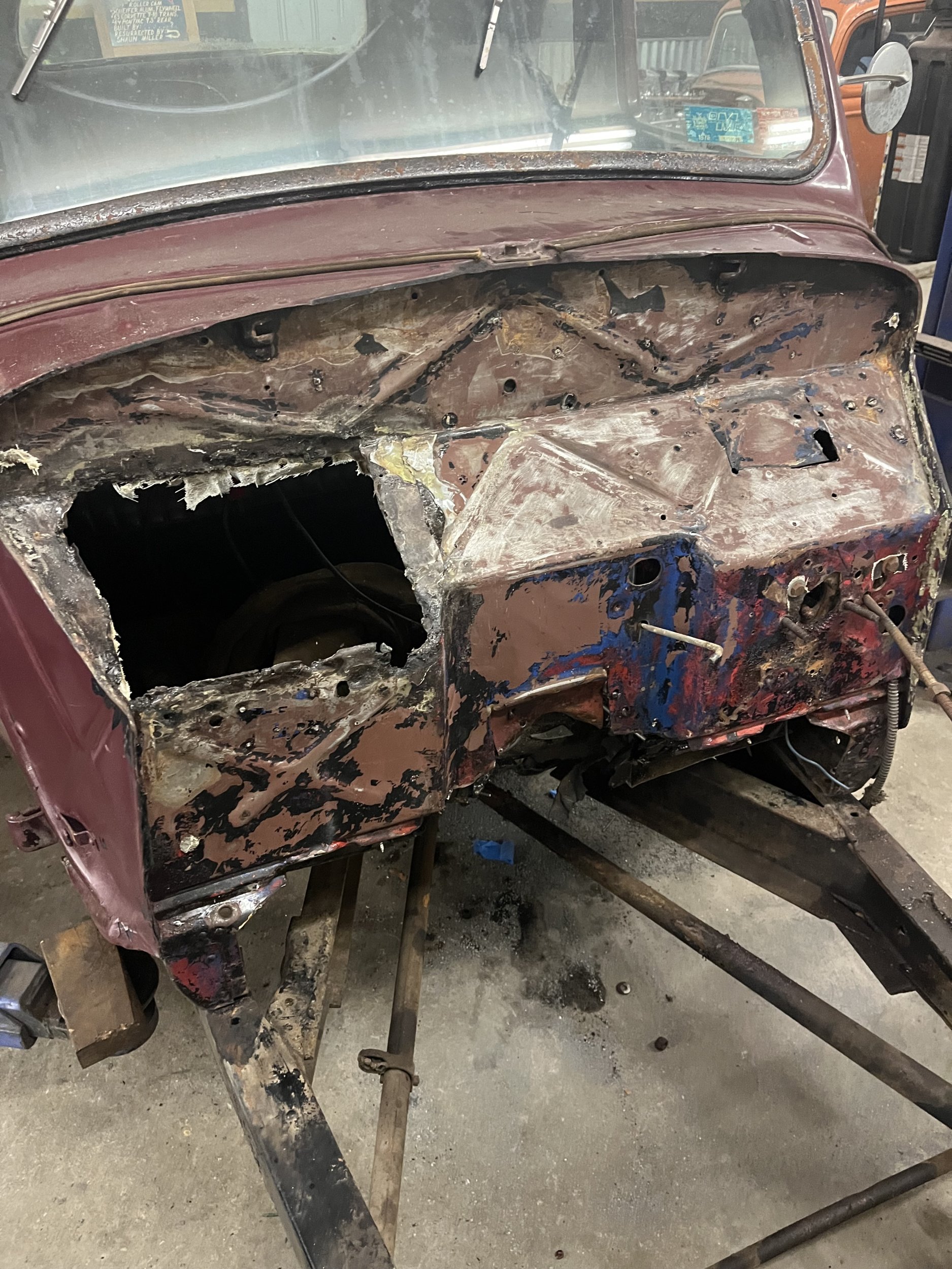

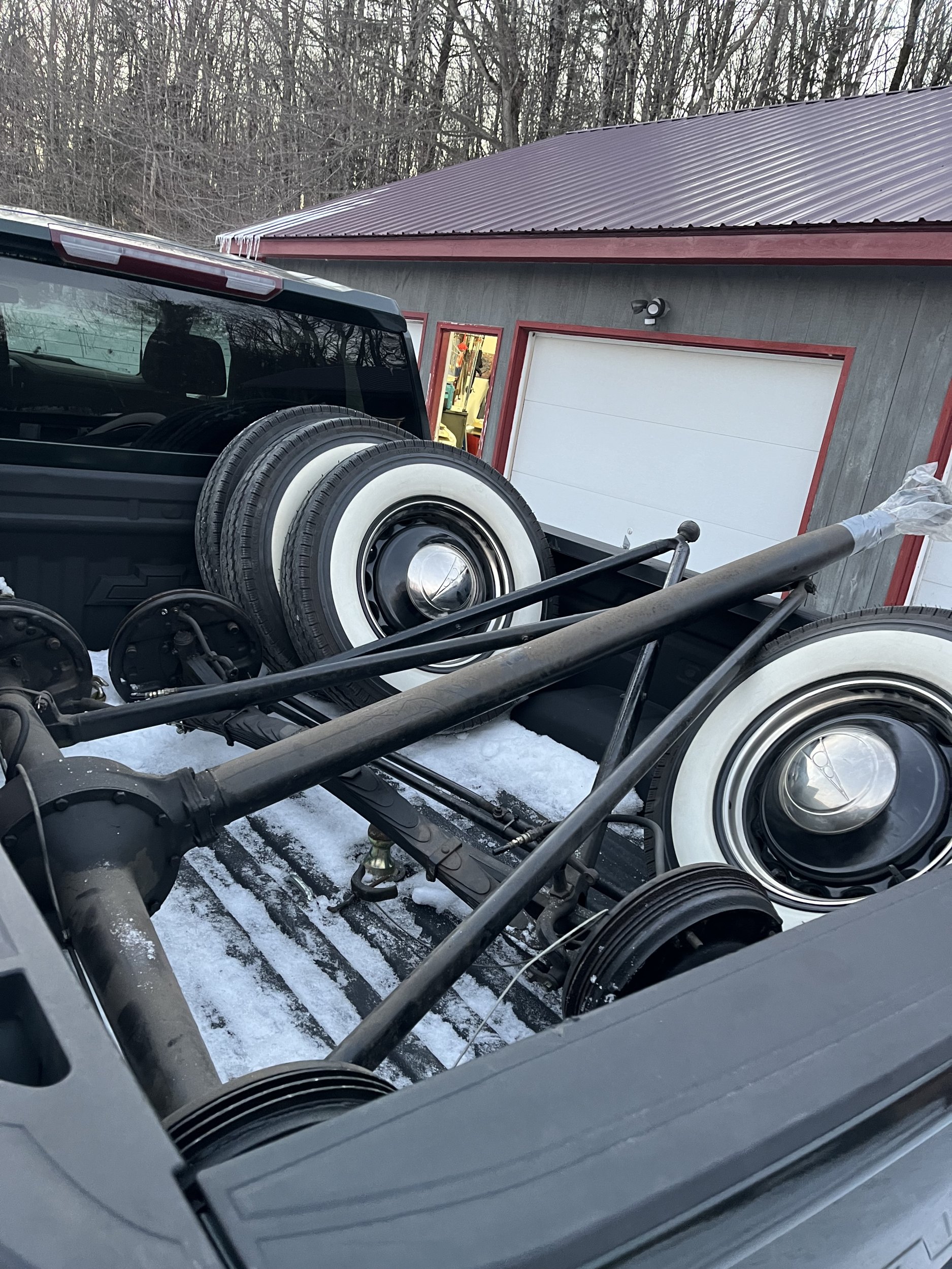

    So after getting the coupe running/driving, I decided to take a step back and think things over. When I think of my favorite ‘35/‘36’s, I always gravitate towards 50’s style customs, with Flathead power. I’ve had a hopped up 284 Merc stroker sitting on a stand, ready to go in something so I decided this would be a perfect candidate. After finding a rebuilt front end, rear end, nice tires and wheels, and recored radiator out of restored ‘36 Tudor, I decided it was time to tear things downs and build it how I wanted it!

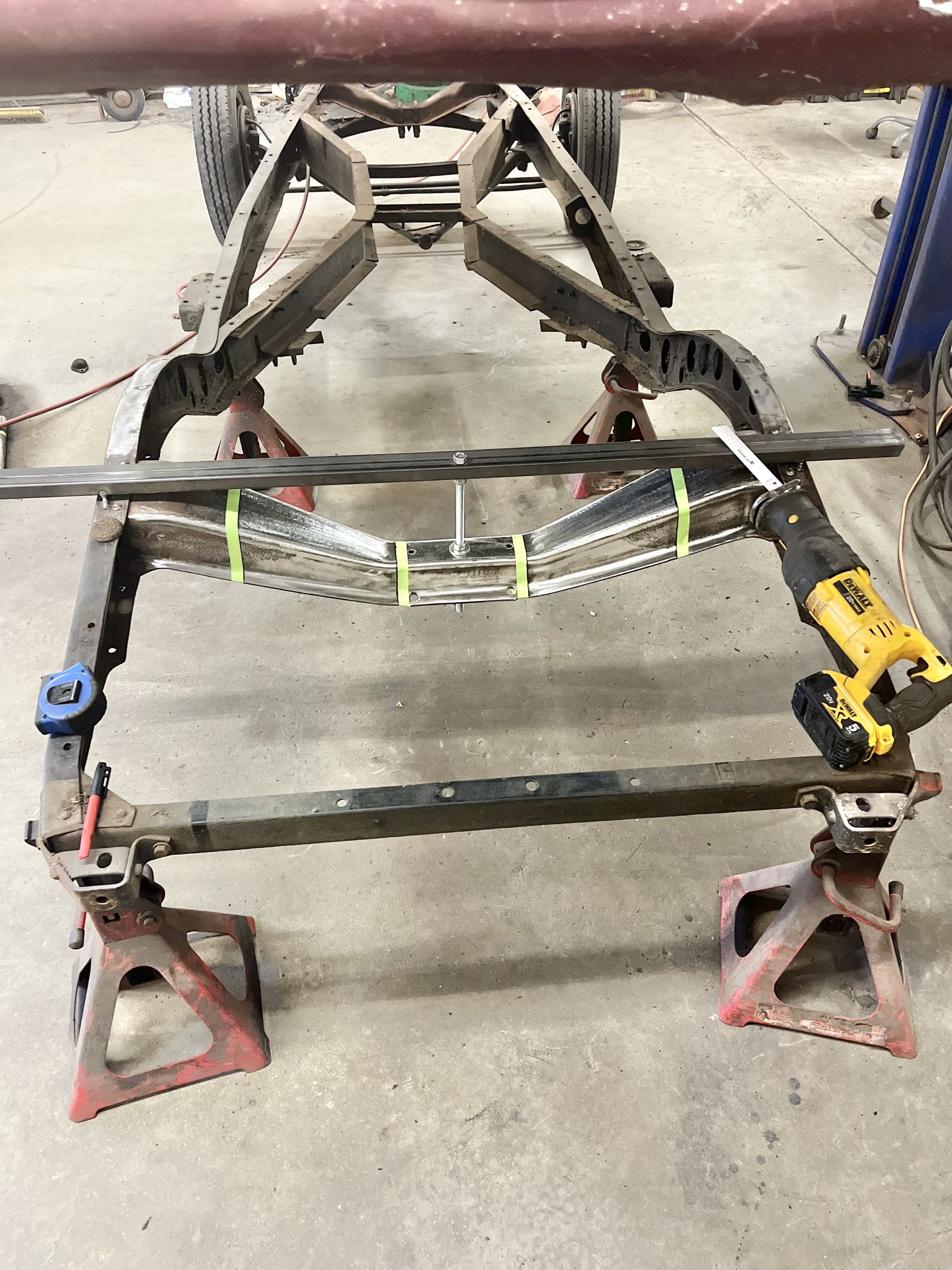

    Here’s where I’m at after putting in the stock ‘36 axles, a mock up 8BA and flattening the rear crossmember. I reversed the main front leaf, and tried a drop axle, and Carrillo lowering brackets. Think I may have gone a little too low. May end up reversing the rear mai leaf and not using the brackets. Also had my friend Dylan Hill photoshop some skirts and running boards on!

    Congratulations on a fantastic barn find and wicked cool car. Unfortunately old hotrods aren’t always built to today’s quality and great to see you addressed its shortcomings. Love the new pictures and how she sits…

    Good call on the re-do. That was scary before.:eek:

    Wow! Great makeover and well deserved. Admire your tenacity and "get 'er done" approach. Alot of that old **** was often hastily done and on the edge of being really scary.

  21. Your purchase reminds me of some of the cars I've looked at. There was some really wonky and unsafe fabrication that was done on a lot of old hotrods, race cars, etc.. Folks used metal, welders and tools that they had available - and things were thrown together as best as they knew how (or in a hurry). In many cases the whole dang drivetrain needs to be redone . . . along with all steering and suspension related components/work. You'll have a great car in the end. Hopefully you can find a different 36 frame for it . . will make the conversion a LOT easier!

    I had the 283 listed, but I think I’ll keep it. It’s all set up so I could swap fairly easily with the flathead. I did however sell the Muncie trans.
    Planning to go with a T5 trans out of a Jeep CJ, and using an adapter to retain the torque tube.
    As to the wheels- the drivers front was OK, but all the other ones were pretty rotted. Big chunks of steel flaked off, a little more than surface rust. Another deciding factor in taking this old hot rod a different direction!
