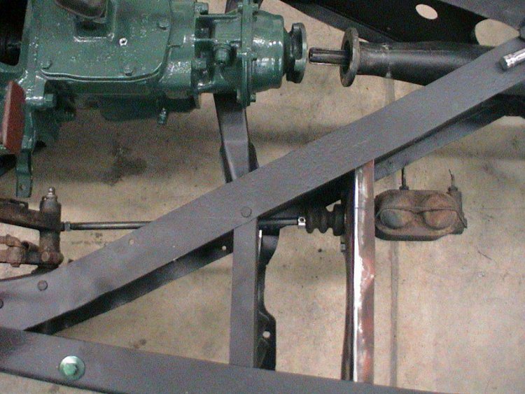

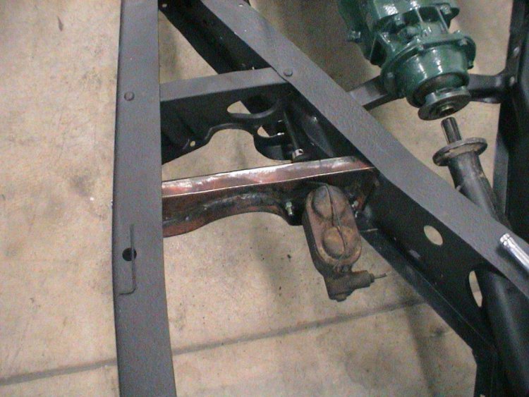

    I have the system assembled, I need to clean it up. I used the old master cylinder I bought today and piece of threaded rod just to make measurements. I bend and mounted a plate to mount the master cylinder one. I was able to sandwich the cup that the rod goes through between the plate and the master cylinder, there is a recess in the boss of the master cylinder so the mounting ears of the master cylinder are flat against the plate. This will prevent the rod from falling out. I have a push rod from a '40 Buick, which is a lot longer than the one for the one used on a '37 at 11", unfortunately, it's about an inch too short. It's made of 7/16" rod so I feel it'll be safe to use a piece of 7/16" rod to make the rod I need.

  16. was the floor or exhaust going to be in the way if you put it on the stock bracket in front of the one you made?. that's one long push rod...:)

    Good point. Does it need to be so far back? IMHO if you use that long pushrod, I would beef it up to at least 9/16 heavy tube, drilled and tapped for adjustment. Better to be over cautious when it comes to brakes...

    The reasons I have it mounted where I have it is access to the mounting bolts and rod adjustments and I also want to install a rubber boot or some other form of protection over the shaft. I also didn't want to block access to the rear transmission brace bolts.
    I am trying to find out where the exhaust runs. The car didn't have an exhaust system when I got it. I'm not at my shop right now and only have the couple of pictures I posted for reference. The master cylinder has to stay in alignment with the pedal so it has to stay where it is, it could go forward if need be. I'm not too concerned about the length of the rod. I have the rod from a '40 Buick and it measure 11", I need 12". The '40 master is located forward of the pedals and pivot above the pedal pivot unlike the '37-39 which is on the bottom and goes back.

    Well, I guess I make a slight miscalculation, the exhaust runs in the general area where I have the master cylinder mounted. I'll have to move it over about 2".
    I looked into using the stock bracket but I couldn't get a straight shoot to the pedal. There wasn't metal to mount to where I had to mount it.

    Just an update. Thanks to 1oldtimer's observation I realized my original mounting bracket was in the way of the exhaust mounting. I built a new bracket using heavier metal and moved the master cylinder over about 2". I made the on piece push rod out of a 1/2" rod. I have an original rod from a '40 which was made from 3/8" stock. The rod I made is only a few inches longer and I am confident that the 1/2" will work find.
