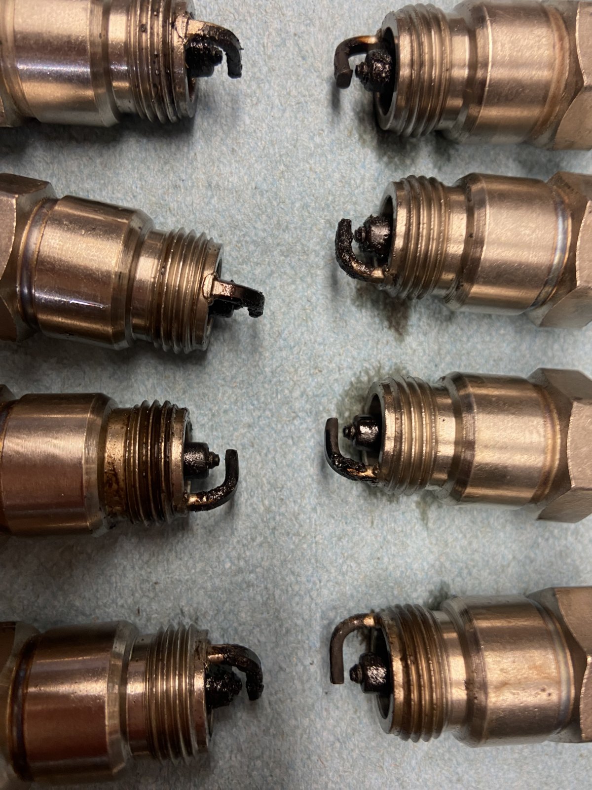

    IMG_7574.jpeg All fresh rebuilt 390 flat tapper motor for an upcoming project. Brand new plugs….On my test stand I started it up and let it run at about 2000 rpm for about 25 minutes…never ran over 200 degrees …great oil pressure timed it at about 34 degrees total. The next day I started it and turned the idling down and it wanted to keep killing. It would not idle.Took the plugs out and this pic is what I got? No antifreeze in the oil .All looked great there.Maybe just the carb? Ideas?

    I’d say that’s definitely oil.
    PCV stuck or intake leaking in the valley would be my guess.
    Compression check will confirm it’s it rings but that I’d say is unlikely with your idle issue.

    If you have the rocker shafts on backwards on a FE ( which is possible ) it floods the valve guide with oil which could cause what you are seeing. It has been decades since I have worked on one but I have seen it more than once.

    here's what I say. plugs got fouled during break in,... then wouldn't idle with the fouled plugs,,,, I just put a new set of plugs and see what happens.... looks like oil fouled plugs to me... but I don't know nothing about anything so beware

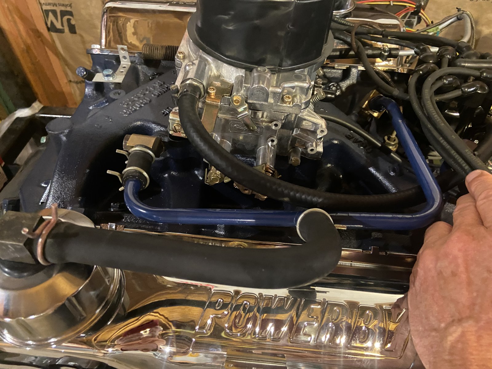

    Autolite AP45 plugs….oem IMG_7726.jpeg PVC system

    Pretty easy to disconnect the pcv and rule that out.

    I'd change plugs and run it again, I'm guessing break-in oil from the rings seating and I'd say probably some ***embly lube if they (like I do) put oil on the cylinder walls and piston skirts and rings when I install all new parts on a new motor.

    I had a friend that had the rocker shafts upside down on his FE, used oil because the valve springs were under oil all the time, We flipped em back and instantly fixed....

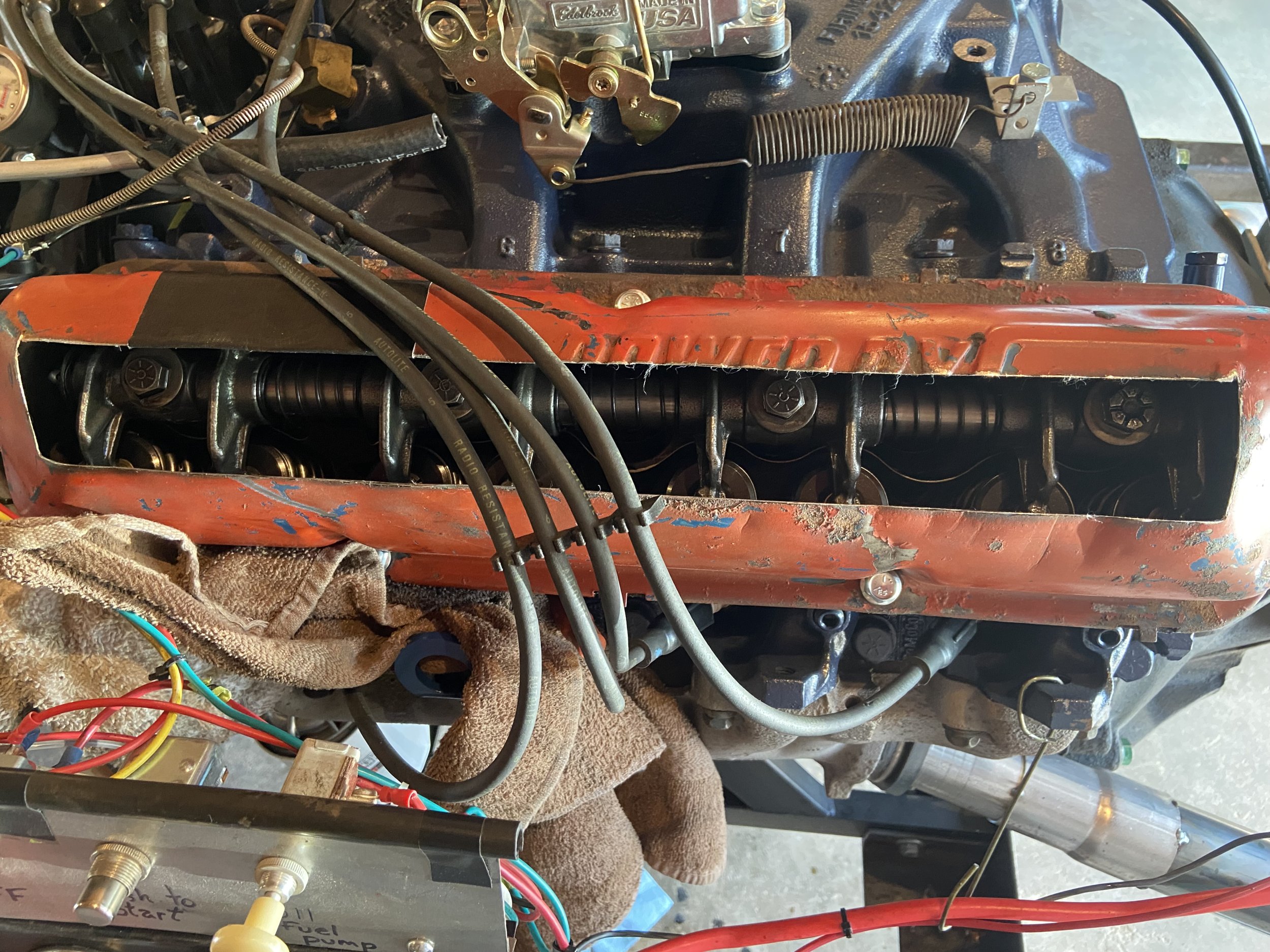

    Been stalled on this new break in 390 motor and have done everything you guys have mentioned ….except the last test .Today I ran the motor on the test stand with a good amount of the top of a valve cover cut to see if the springs are flooding with oil….,They sure are ….Now a few of you mentioned the the rocker shafts could be ( and according to my flood of oil test ) they are installed upside down….Now working only on 1 side after unbolting the rocker shafts do I just flip the front of the shaft over to the rear and of course realign the rockers and pushrods and bolt it down…Am I right on this technique if not please explain. Here is a pic of the valve cover cut I made. Anybody want to see the oil flooding? I can take s as pic of that also.

    Yep according to to the above link info both rocker shafts were installed upside down….shaft notch at 11:00 not 5:00 like it should be. Pretty easy fix…Anybody know the torque on those rocker shaft bolts?…..Also do the bolts get into the water( antifreeze ) jackets?

    Be sure second bolt back from front is installed in correct location also. Drastic things will happen if not in correct location

    Second from front on one head second from rear on the other bank . Sorry it’s early .
