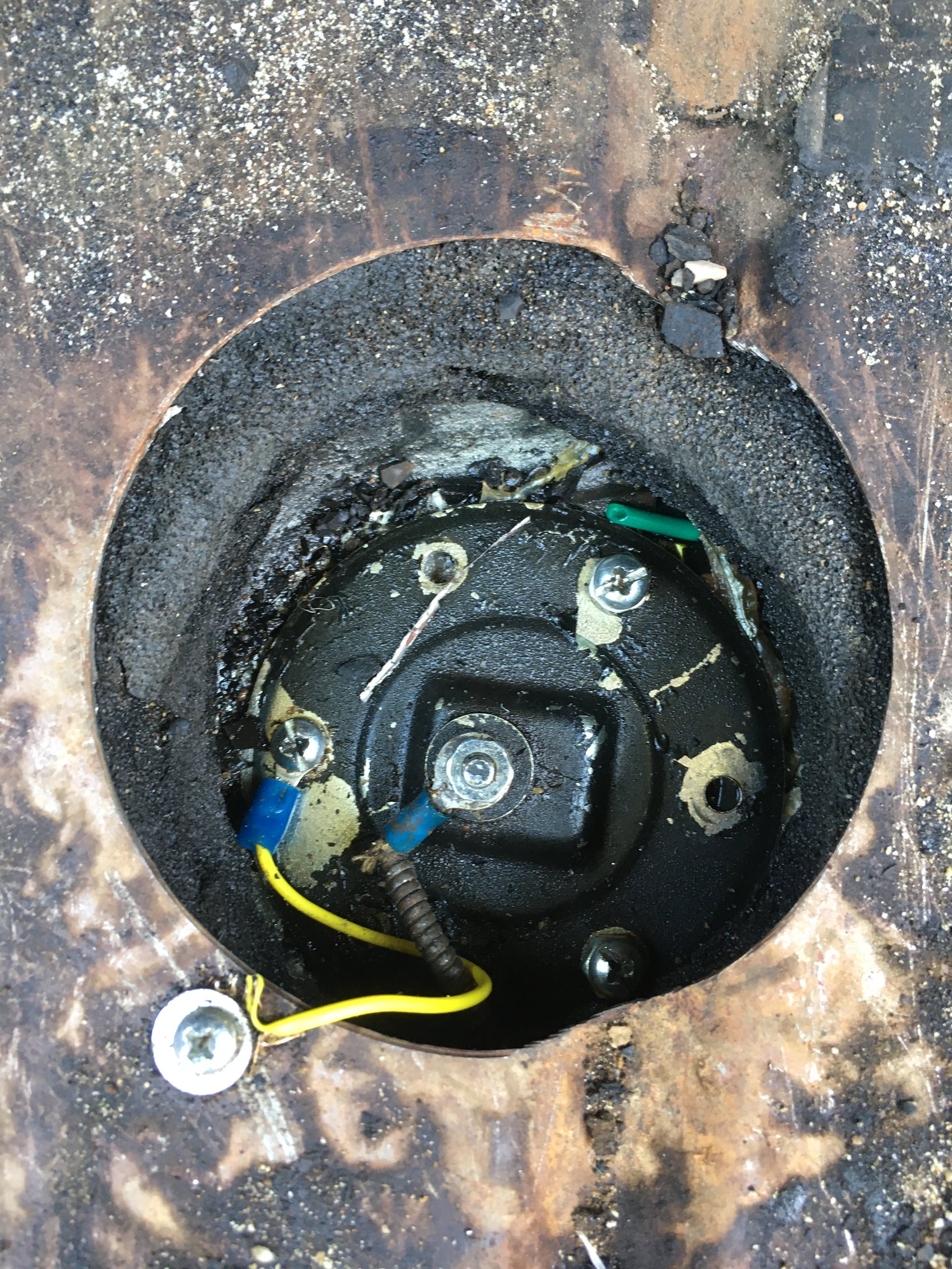

    My first though was the filler seal....No, this was coming from the top of the tank....
    [​IMG]Un***led by Travis Brown, on Flickr
    Just look at that Mickey Mouse BS.!!:mad:o_O:rolleyes: Now, I noticed this before but I truly did not see it......
    I did not catch it. Those screw holes looked like Old Faithful...WTF.
    They had a cute little foam cover covering this cut out with a pocket knife.:rolleyes:
    These cars go through many hands unfortunately some of these hands belong to complete and total dumb***es.
    The truth is I should have noticed this. I guess this makes me a dumb*** too.:rolleyes:
    I was all in the trunk last week working on the brake lights. I should have followed the clues....
    Clues...
    Anybody lazy enough and dumb enough to cut a big hole right square in the middle of a perfect trunk panel to wire up a used $3.00 flea market gauge, is dumb enough to leave it like they did. Open! WTF....
    The way the power wire for that ******** gauge was just d****d on the frame or whatever and ran to the back under the car is another clue. It was just cut loose and wrapped around and around the bumper bracket...WTF
    ^^^Here was the power wire for that stinking gauge....Hey there's a hole, lets run a wire through it.:rolleyes:

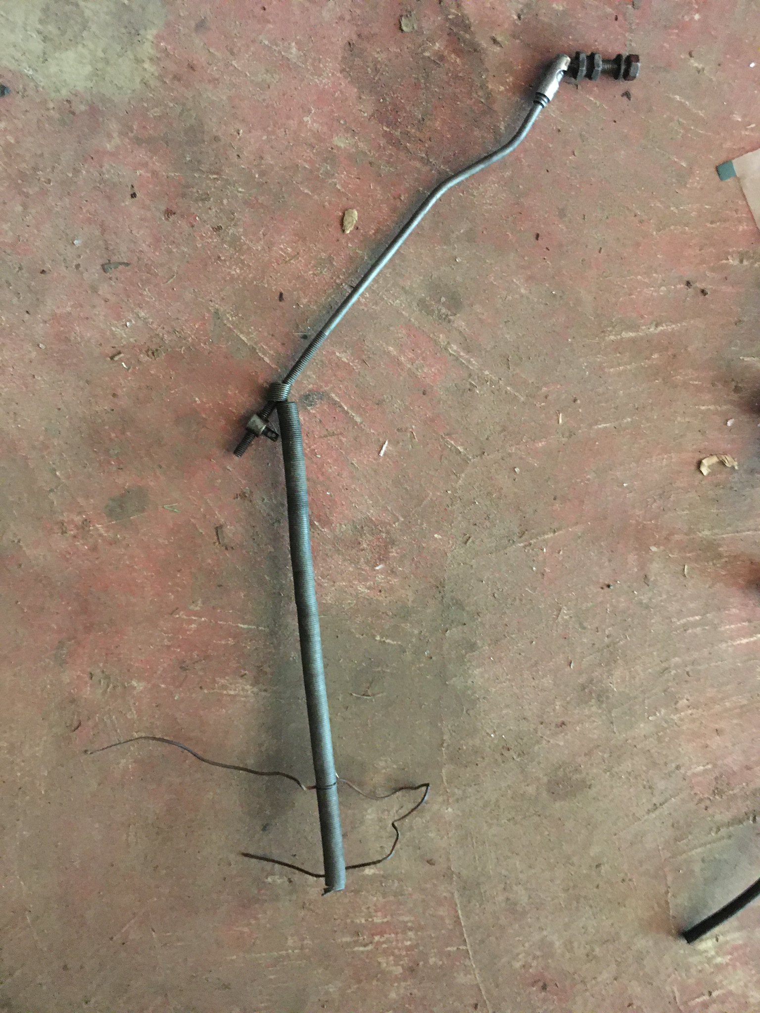

    Take a look at this little jewel.o_O The accelerator was flopping all over the place. It was impossible to drive the car in that condition. So they made this piece of ****. They took a piece of aluminum and a Plastic bolt and nut. They drilled through said plastic bolt to make a bushing for the pedal.
    Did it work? Hell No!
    They had no idea how the accelerator linkage works on a Shoebox. The problem was not the floor. It was the linkage. That, and the accelerator actually needs to secured to the floor. A self tapping screw ain't gonna do it....
    ^^^ Lets use a porch door spring. No place to secure it...No problem, we'll just use bailing wire wrapped around the Generator mount.:confused:

    I never dreamed that the top of the gas tank would be open.
    ^^^ It could have been bad. It could have been bad bad.
    Now I have to fix it. The thing is....It's ****ed up. The tank is FUBAR. To use that tank, I'll have to out "Mickey" Mickey Mouse....
    I'm not going to do that. It looks like a new tank is in the future.

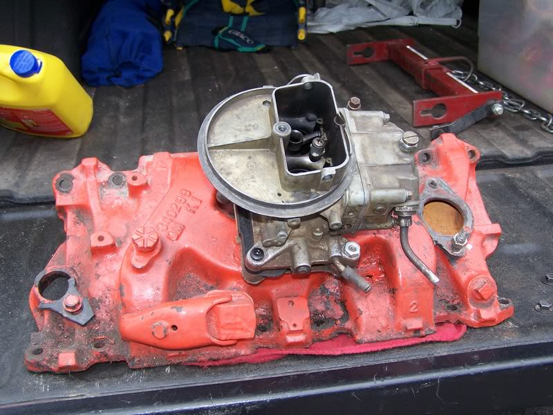

    Just never know what you'll find
