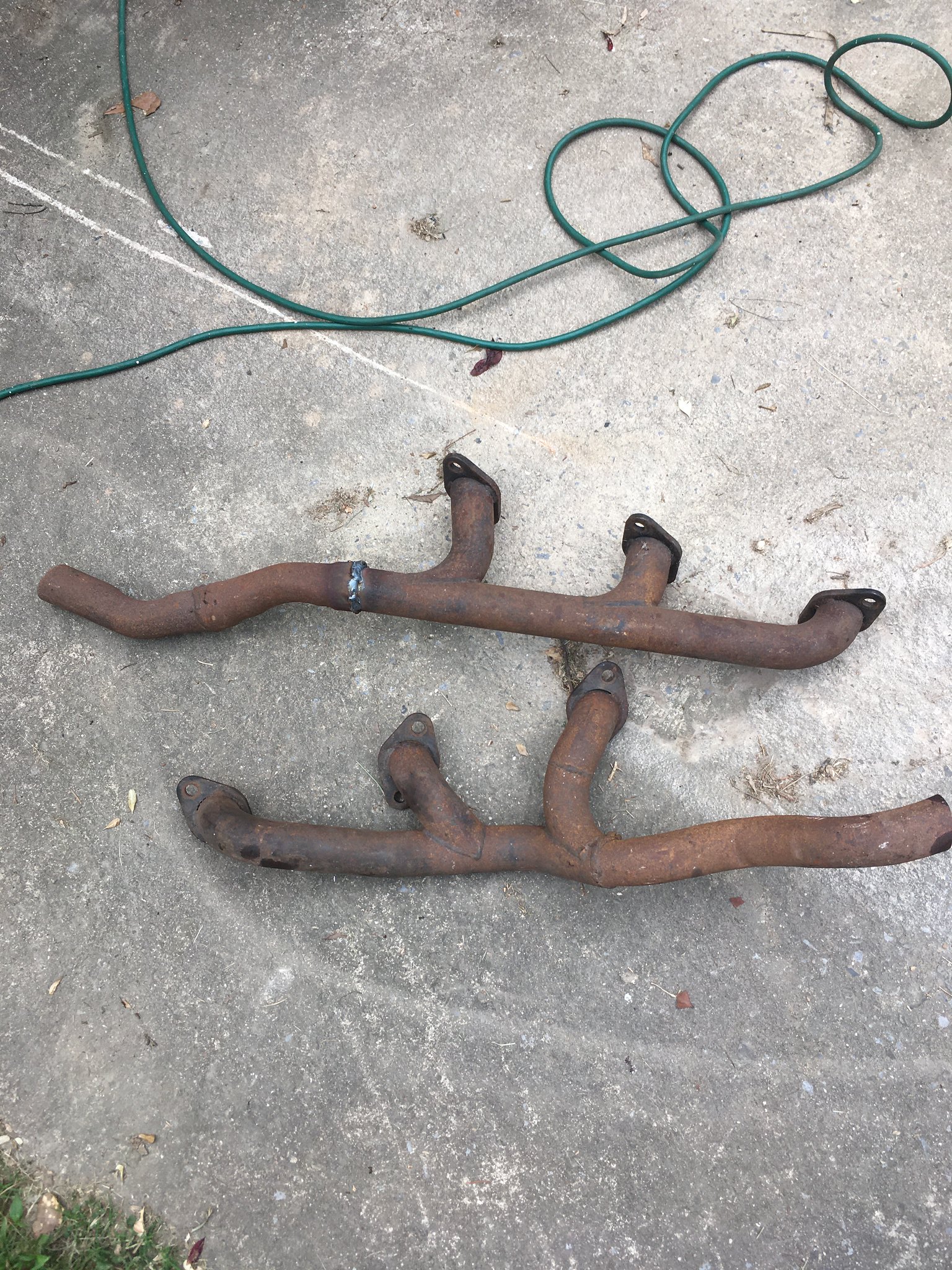

    I had a set of headers left over from my 50 Coupe. I had three. Just where the third odd header came from, I have not a clue.
    [​IMG]Un***led by Travis Brown, on Flickr
    All cleaned and painted.

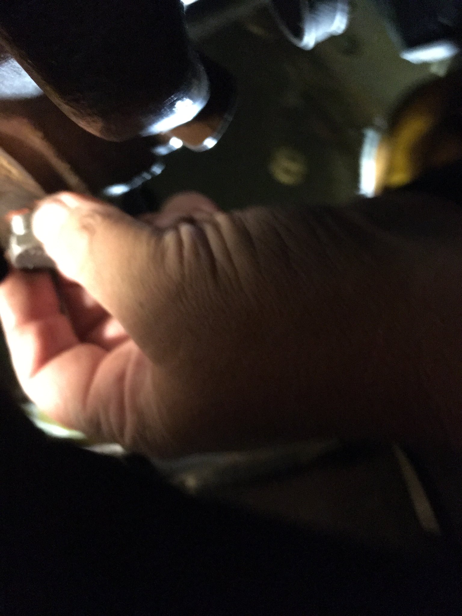

    I modified a 7/16 bolt to clean the threads. I double checked it on my spare engine to make sure it threaded in and out easily.
    On one hole the clean out bolt was enough, but on the others the threads were too damaged to start.
    The really damaged threads needed a tap to restore threads. A big problem was starting the tap square to hole. If the tap was off center I would cut the galled threads away instead of cleaning them.....Bad Ju-Ju.
    On some, I had to use the countersink and the small file to work on the leading threads. All of this was done by hand. The counter sink was spun back and fourth through my fingers. The little file was used to ring the hole so it would start square.

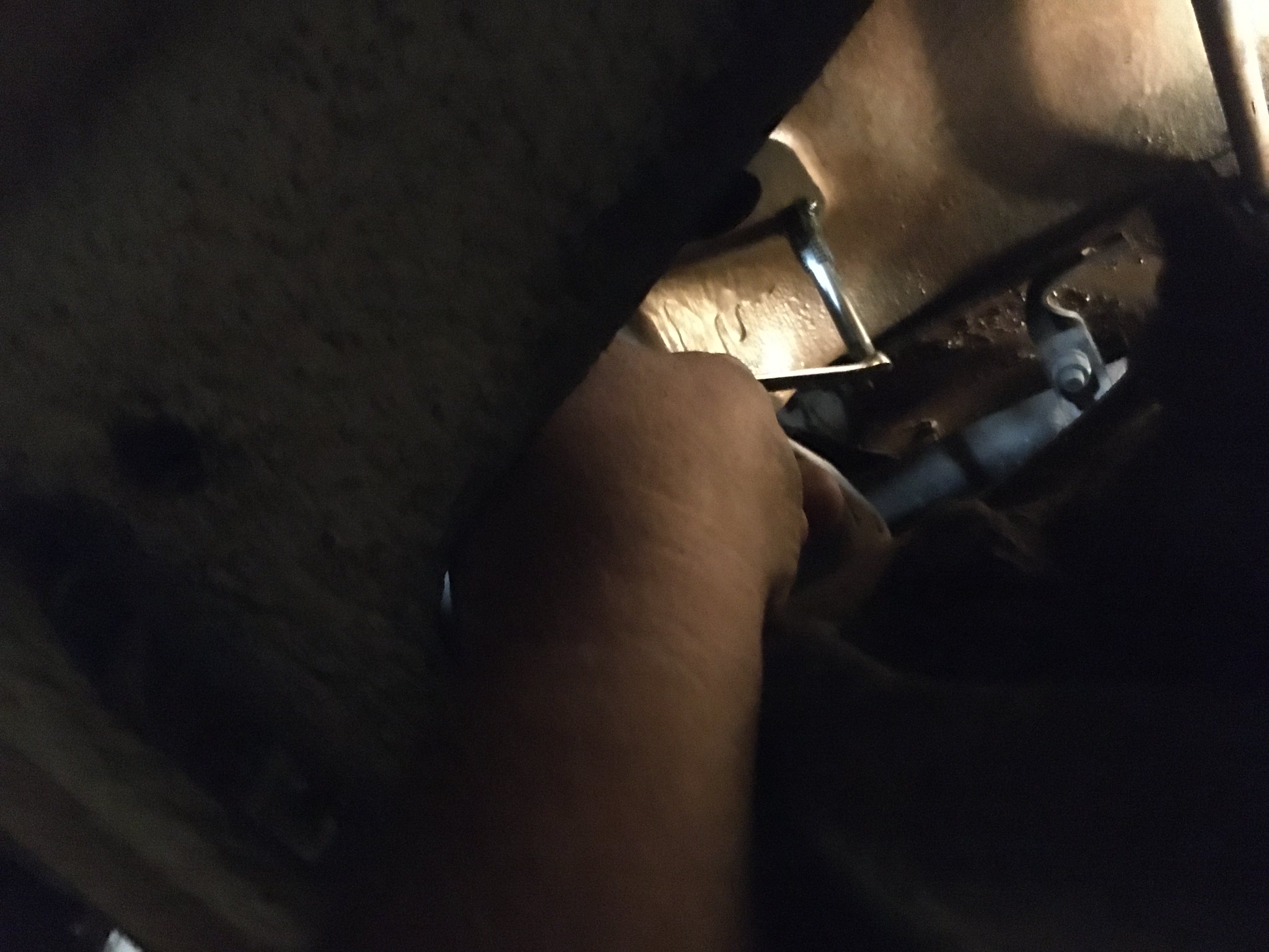

    There was no room for a tap wrench so I had to use a regular wrench on the tap. This was another reason the tap had to be started absolutely square by hand.
    The last and most damaged thread absolutely would not take a tap square. I had to use the counter sink, the file and my special bolt. Back and fourth....turning backwards then forwards again, again and again.....Then my little bolt caught and I could tell by the ****er smooth feel that it had engaged the threads.....
    Since the bolt was engaged in the hole, I put a wrench on it...In and Out....in and out many any times. Finally I could remove the bolt clean it it out then replace it. Finally it would take a regular bolt.

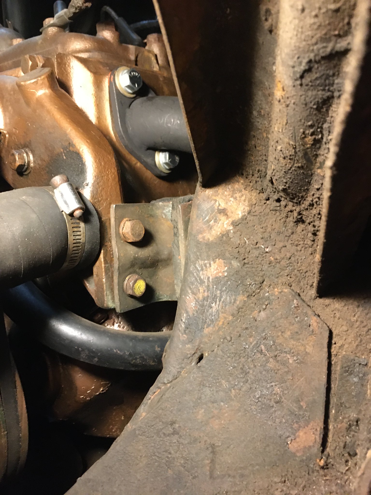

    I was successful. I was very fortunate.
    Installing the headers on some spots you can work through the wheel well.
    This repair took several days. I cant tell you the care and patience required. It was a slow go and took a very light touch. Nobody and I mean nobody is going to do this kind of work. They don't have time and they don't have care..
    All of this could have been avoided if they would have used the right bolts in the first place.

    My new tank arrived and I'm in the process of installing it.
    Today I was reminded why I started this thread.
    Safety and Responsibility.
    It does not matter what somebody else did. If you own the car, you own the repair. If something bad happens due to such a repair, it's your fault. You own it.
    I spilled some gasoline, maybe a pint. Little did I know the top of the tank was leaking. The gas spill was my fault for not fully checking things out.
    This dawned on me toady. This car had an exhaust system put on it 2 weeks ago. Those guys were all around that tank with welders. I know gasoline is pretty hard to ignite except when it does but....
    That Would Have ****ed....!!!!
    Lord have mercy. I am very thankful.
    Check your stuff.

    This was one of the Mickey Mouse jobs on my Lincoln when I got it. This was hidden behind the hubcap. Ford 8" Mustang II rear end. Scary thing is, somebody actually drove this car with this **** on it! I know they did, because the transmission pan had the impression of the wishbone in it where it had been hitting! 100_1720.JPG

    Lord have Mercy!....That's bad Bam, that's real bad.

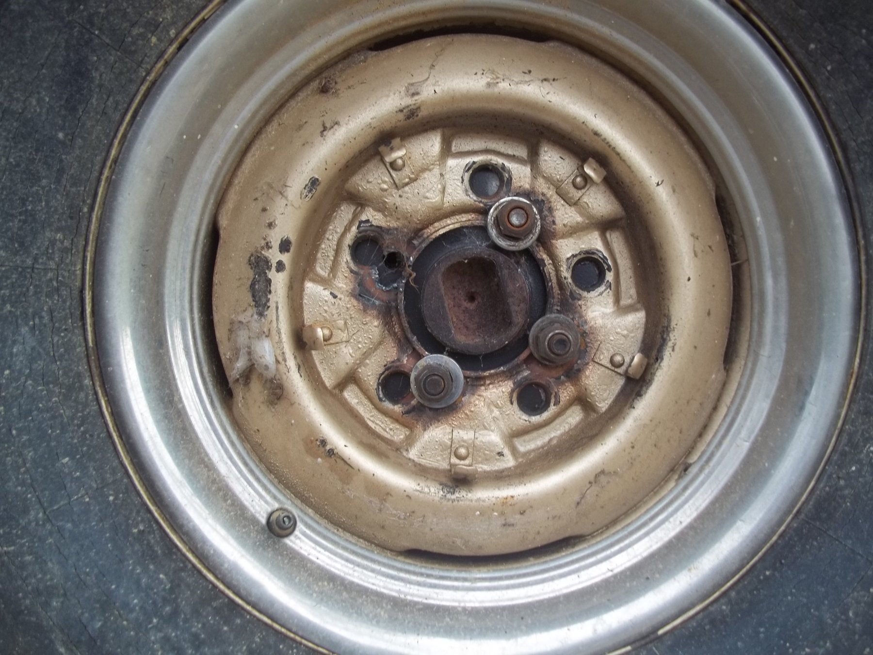

    The list is too long on my RPU from previous owners, this is just one item. Also ALL the wiring was black. JW
