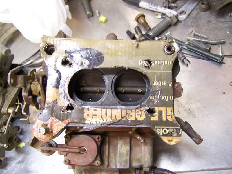

    I've done some pretty crude stuff to get me home but when you are 50 miles away from parts and you need a gasket I have made lots of ballpeen gaskets that worked just fine.

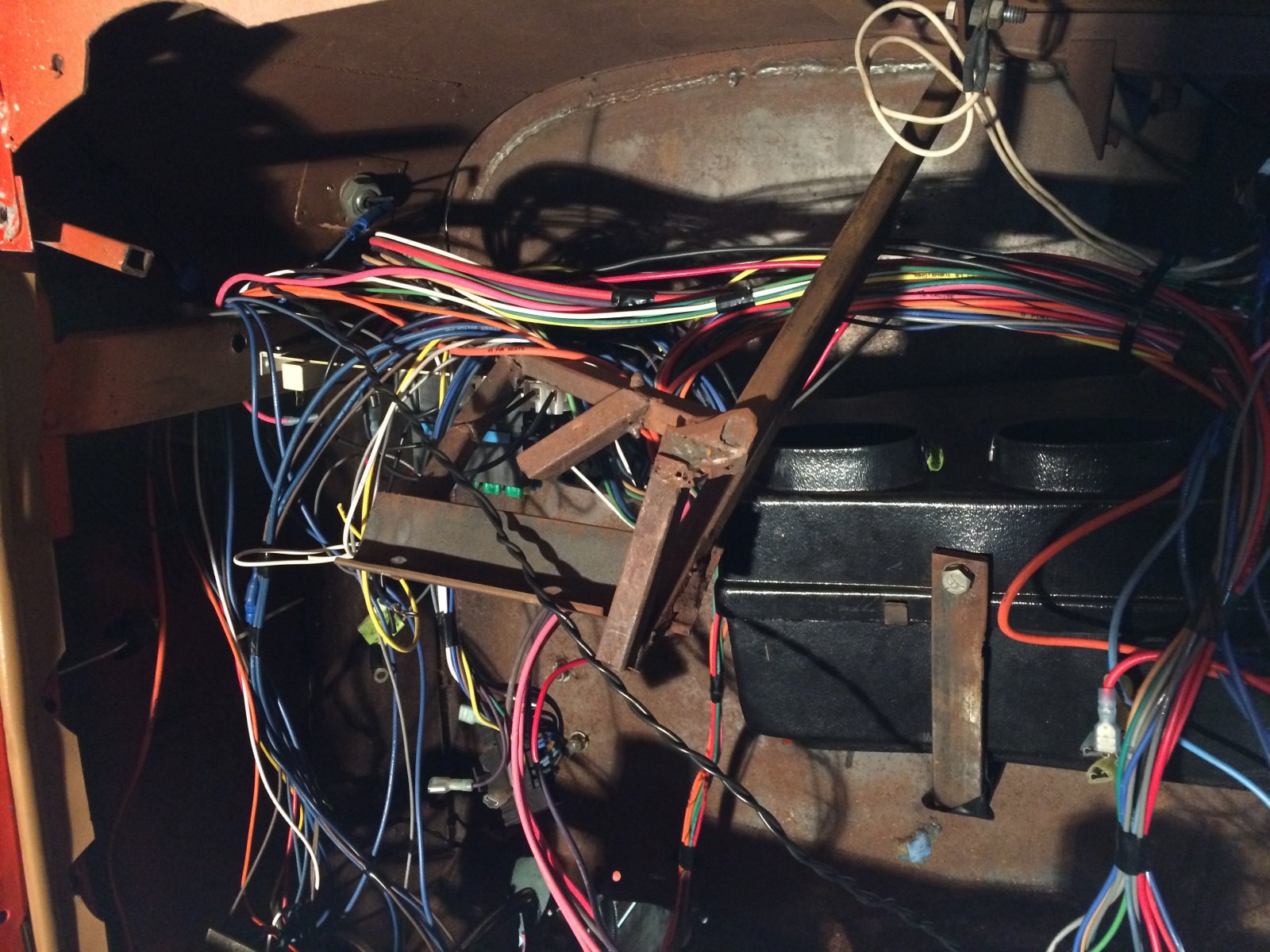

  6. The 40 merc I just bought has some great work done to it .
    great body work ( paint is 20 years old and still shines). Chrome is a 10 interior is all redone with lap belts in stock trim, all door and window seals new etc.
    302, AOD , disc brakes on stock front end , duel master cylinder . 8.8 inch rear with new leaf springs all brakes new etc etc etc .
    All documented in two big photo albums with receipts and records of who, what and where.
    BUT THE WIRING !!!!!! Old , new , masking tape , marrettes , inline fuses , butt connectors !!! Junk just junk , everything works , but man is it scary under the dash !!
    One of the things I’m going to get sorted this year .
    it simply blows my mind at the money , time , and effort out in to replace , rebuilt and repair everything they did then cheap out in the wiring . A kit is maybe 300-500 bucks snd a weekends worth of time .
    I simply don’t understand .

    Personally I don’t see much of a problem with the wiring here, aside from being a little untidy. Different color wires, hopefully with a plan, bundled and taped for the most part, terminals with shrink tube, hopefully crimped and soldered. Did not say anything earlier because some think I’m just negative, maybe I am because I don’t tend to speak up except for things I don’t agree with. I’ll shut up now before I’m banned CBE2D074-82CE-41C4-AF4E-314A5ABB5335.jpeg
    These are called scotch locks . First time I saw one I said “cool” this will work. Nope , it didn’t work . And I’ve never been able to get one to work correctly so I don’t bother anymore .
    and for someone to say this wiring is fine sniffs glue !
    no anti strain built into the harness , pinch points and chaffe/ abrasion areas all over , wires simply hanging from their connections , looped routed and bunched all Willy nilly.
    would you run your fuel snd brake lines in this way ?
    Paint and body work to this “ level of professionalism “
    If this level of craftsmanship is ok for your brakes and steering then tell me where you drive so I can avoid you.
    if it’s not an crash , most antique cars are taken out by fires , caused by what ?
    Shitty electrical !!
    It doesn’t have to be show quality , but it needs to be neat , clean and follow the rules just like any other assembly on your car or your going to have problems .

    That wiring could use some tidings up! I like to use those zip lock ties with an eye hole on one end. Makes it easy to organize the wiring. I like to make sure the wiring is not shaking around , nor rubbing on something that moves.
