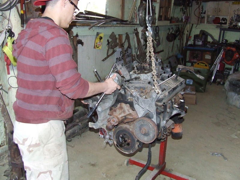

    Earl did some more welding on his firewall and got his engine in the pole building and up on the engine stand. No rebuild just stripping it down for a good cleaning. Getting a little ahead of himself but on rainy days such as today he can work on it.

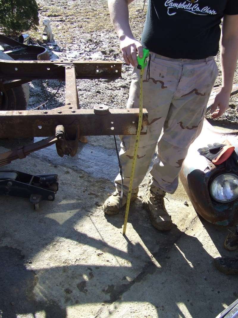

    I know I'm going to take some heat for this with the traditionalist but with this being Earl's first build I didn't want him in a car/truck without some creature comforts. His daily is a Neon. I didn't want to shell shock him with something that was hard to steer and stop so for the first time around he's going to get power brakes, power steering, better suspension, disk brakes and more. Next build or two he can see if he wants to go the more traditional route and leave the stock stuff. We started off with the tape to see how high it sits now and we will see where it drops to. Right now it's hard to climb up in it without getting nose bleeds.
    I explained he needed and F body clip or a Nova. He ask where do you find something like that? I told him they were getting hard to come by. His eye flashed around while he was thinking. I told him to walk out in the woods about 50 feet. I had one in stock. :D I wrapped a chain around it and drug the Nova frame out so he could clean it up for the weld in.
  25. rebstew187
    Joined: Jan 17, 2005
    Posts: 1,491
    rebstew187
    A ton of measuring and marking up the concrete to get the front end back in place. It's typical on some of these early cars/trucks that the wheels don't line up in the wheel well. It drive me nuts. We set the frame a couple inches forward from the stock location to center it in the wheel well. Marked on the concrete, measurement written on paper and rechecked many, many times. Then it's time to cut it up!

    After getting everything where it should be we double checked everything again and did a few spot welds. At this time we run the tape measure from the back all the way to the front, crossing left to right and then the other way around. This gives you the longest reading so if you are off any it will show. We double check left to right front to back on anything and everything that where the same on both sides. Like left rear leaf spring hanger bolt to right front sway bar bolt. If it's out any you need to redo your placement of your clip or you will be running dog legged down the road. Frame was spot on so lastly we did the front clip to stuff on the firewall of the cab. Everything was dead on. Time to weld some more. The frame mates to the stock frame perfect! There is plenty of frame to weld together too so it will be very strong.
