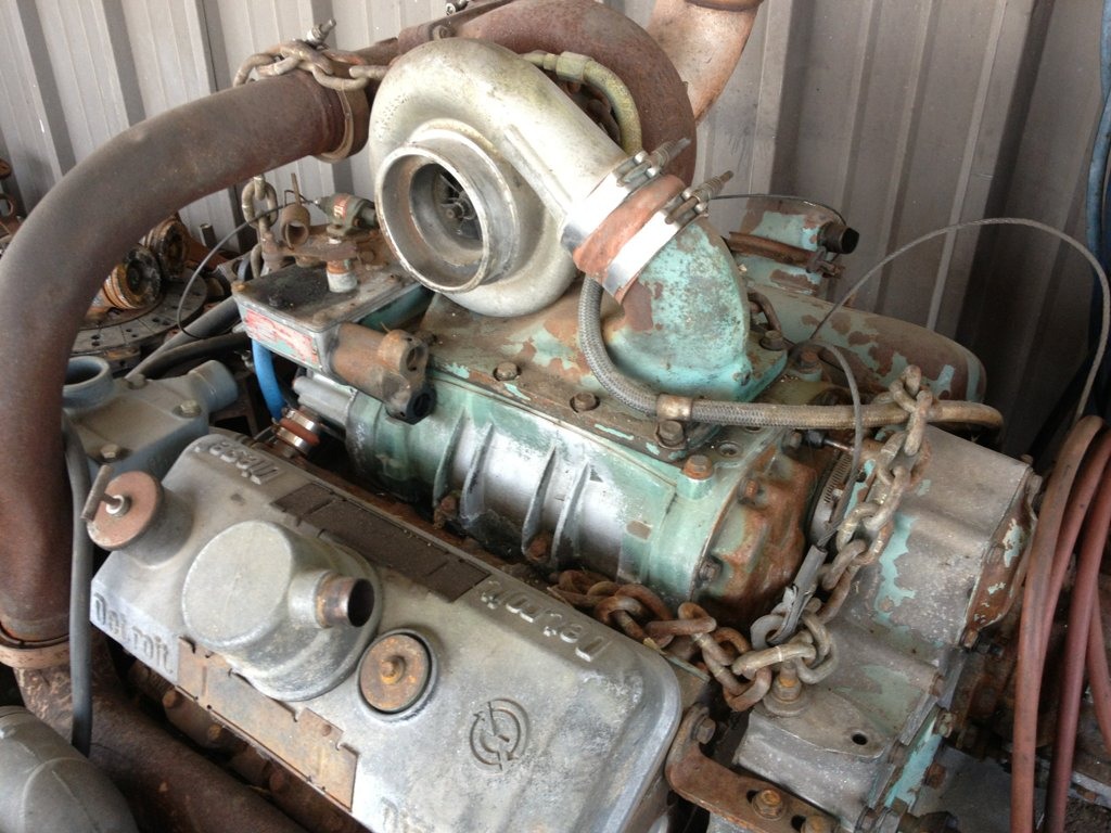

    > he 53/71/and 92 denotes the size of the injectors that were in the 6- or 6 cyl engine.
    Actually this isn't true... The 53/71/92 series represents the number of cubic inches per cylinder. So a 671 is 426 cubic inches (6 x 71). With #65 injectors, the 671 was rated at 238HP.
    I have a 671 Detroit in a 1970 Brockway I am restoring for my Dad...
    On a 671 (straight 6), the blower sat on the side of the motor. On a 318 (V8), the blower sat on the top of the motor. I have a few friends with 12V71's, and there are 2 blowers that sit on top of the motor...

    It is a 6-71 blower off a 426 inline 6 Detroit Diesel. The cylinders are 71 cu.in. times 6 the number of cylinders. That is how Detroit labeled them.
    You can use that blower, Don't get Teflon seals for the street. The front and bearing plates can be used off the blower, if you reinforce the front with steel rings. If you use the rear plate you might be tight against the distributor. Back in the 50s and 60s they used the original bearing plates. Look at some real old mags, they tell you how they were converted. The rear bearing uses greased bearings and a flat plate to cover rear.

  7. Read you were taking apart to get it home, be aware you have to pull the gears at the same time due the helix of the gears and the spiral of the rotors. Been a while; but I seem to remember using two steering wheel pullers, worked good for both the gears and the end covers. I took a couple of pictures of one of my old Detroit manuals to show what I am describing. Note: the rag stuffed in the intake to hold it from rotating without damage.

    Before you take that blower apart you should mark the timing gear set. There is a L.H. and R.H gear and at least one side will have a set of shims behind the gear. I would also check the rotor and case clearances to see where everything is for a base to work from. If you don't know already, there is a thread posted on here about how to rebuild and set the timing on a 6-71.

  14. Pretty sure that is a 6V-92, no hot rod parts available.
  15. Don't forget to mill the tabs off the side before you put it back together.
