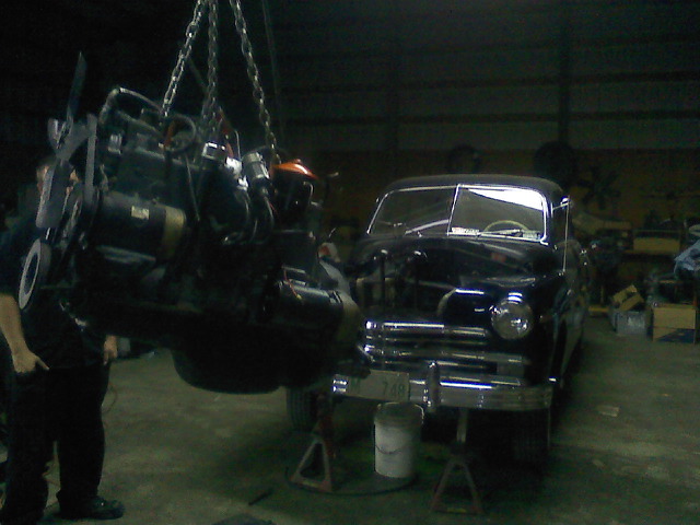

  2. I actually managed to slip home over the weekend and see my family... and my extended automotive family (some of my fellow Bishops). Blue is still in pieces across Marty's barn... but there is progress! One promise - wrenches will be turned and beers will be consumed over Christmas break... and that Polysphere is gonna get fired up!!! Marty - Rev... one night, we're gonna get the boys together and christen that motor!
  3. OK... we have a date to work towards. As it stands, we're planning to fire the Poly for the first time on 19 December, at the Bishops Holiday BBQ and party. I'll be back in the PNW, and it'll be the perfect time. So there - hoe down and engine christening is on the calendar. In the meantime, I'll have to survive on a few images someone keeps sending me. :D
    (if you squint, you can see the poly behind blue, and the tired, old rear end is out and awaiting the new, custom 8 3/4" axle)
  4. More "proof of life" pictures from Marty's little shop of mayhem - looks like Gary's adapter landed in one piece, and now the engine and trans are mounted. Oh boy! We're still a ways off, but this is a big step!

  13. Lots more work to do! Blue is a roller again (rear is under her), but they sent the wrong clutch (fine spline versus co**** spline - suppliers bad, but will take 2-3 weeks to restock). Ugh...at least they sent the right starter! We'll just keep fiddling with the motor, and try and ground hop it some time next week. Test fitting the motor also resulted in an ultra-tight fit between the wheel wells. Hmmm. Those might need to be trimmed back so the valve covers aren't touching. Oh, and the trans tunnel may need to get "enlarged" a bit to handle the AX-15. Sigh. More proof of life photos to follow.
  14. George
    Joined: Jan 1, 2005
    Posts: 7,997
    George
    It sounds better to say you have to trim the inner fenders! :)
  15. OK.. the front end is off, and she's ready to receive some lovin' on Friday. We'll ground hop the motor at long last, and see how she goes. Yes, George, it does sound better if you say she needs the inner fenders shaved a bit. We'll see exactly how much, and whether or not the steering box (please no!) might have to wiggle a little bit. I have seen other MOPAR small block builds where they didn't have to move the steering box, so I'm hoping like crazy. Otherwise - we may have to go with headers on the driver's side to get around it. I think the rear-dump manifold will make it, but Marty has been measuring and I'm betting it's going to be tight. :eek: Anyway - wifey is working a 12 in the ER on New Years Eve, so the kids and I are heading over to turn wrenches, spark a motor, and wish Marty (Dynaflash_8) a happy b-day.

    Pete, if the box and manifold are too cozy then look at shifting the engine to the p*** side one or two inches.
  19. Thanks Gary - we'll look to see if we need to offset it a bit. We lost the airbox for the heater, so we've got a little more wiggle room on the p***enger side. The problem will be the rt manifold - it's a center dump. Right now, our current crisis is a cracked dizzy cap, discovered a little late. Gonna go hunting for a spare tomorrow so we can (hopefully) fire this pig on Friday. Delays, complications, delays - sturm und drang.
