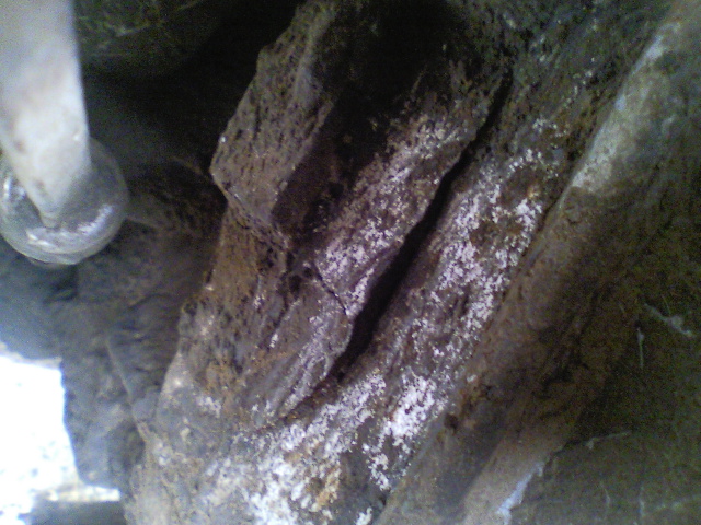

    i got this old 1955 dodge c-3 with a 259 poly for free it sat for over 30 years but a set of plugs and wires on it and it fired right up but when i went to put water in it i noticed that one of the heads had froze and blew the side of it out so i am curisous does any one know where i could find a set of heads or what heads will fit it

    Show us a couple of pics of the damaged area.
    "Lock-n-Stitch" has saved many broken castings.

    okay i will when i get home im at school now what concerns me is that its is puffed out about a quarter of an inch so would i be able to slightly beat it or push it back in its right on the front side on drivers side closest to the fan

    here is what i got goin for me

    If not fixable all heads from the Dodge Poly line will work 241/259/270/315/325, or install hemi heads off any of those size hemis, along with the hemi pistons, ex mans & push rods.
  29. Before I spent any money for heads I'd pull the cracked ones and check the block really well.

    Yeah, after seeing he pics I'd agree on double checking the block. Heads obviously do crack but the block is usually the first to go. Look around the core plugs.
    The way the metal is pushed out I'm not sure that anything short of welding will make a good repair.
