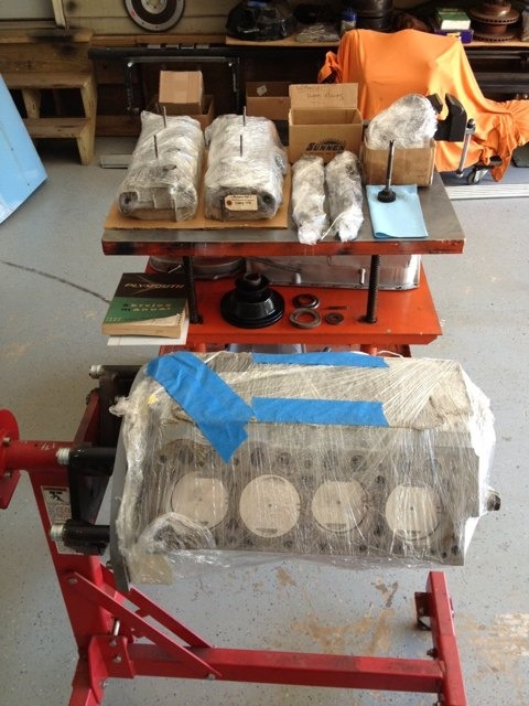

Lookey what I got for a project!! (Hyfire Poly!)

  2. More teaser pics from Dan as he gets the Hyfire ready to run.

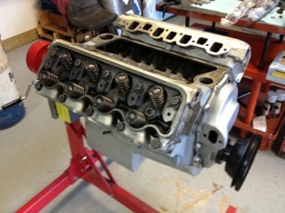

  4. Dizzy came back rebuilt with its new Pertronix guts today. The block is at the machinist getting recleaned and a light hone, and he will redo the exhaust valve seats (last machinist merely knurled the guides instead of replacing them). A few more pieces to go, and the Hyfire might come back to life....finally.
  5. POLYFRIED 35
    Joined: Sep 1, 2010
    Posts: 886
    POLYFRIED 35
    This is great .. you must be excited!
    Engine looks good too!

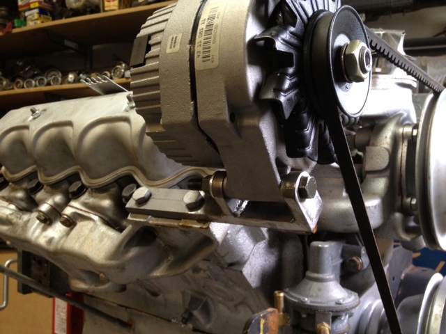

  6. Dizzy teaser pic from Dan -
  7. 4msfam
    Joined: Jun 25, 2011
    Posts: 69
    4msfam
    I got the Pertronix electronics for my 273... what else was done with the distributer rebuild?
    Great build btw!
  8. Thanks - this has been a saga, but it'll be worth it!
    As for the dizzy - Pertronix installed, vacuum advance eliminated (so no holes in my Offy 2x2 intake), recurved, cleaned up, and painted...basically coming back looking like it did (or better) when it came off the ***embly line in 1955. :cool:

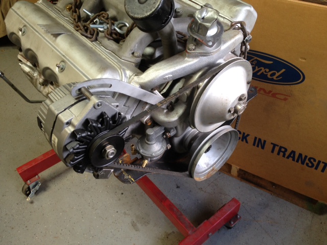

    That alternator looks out of place... But those exhaust manifolds look really good!
  10. Sigh...I know I'm gonna take flak for the alternator...but have to balance cost, reliability, and driveability. Maybe after I hit the lottery, I can afford one of those alternators inside a genny housing (PowerGen?). They don't exactly give those things away. Besides - upgrading to the 12v conversion was expensive enough :eek:

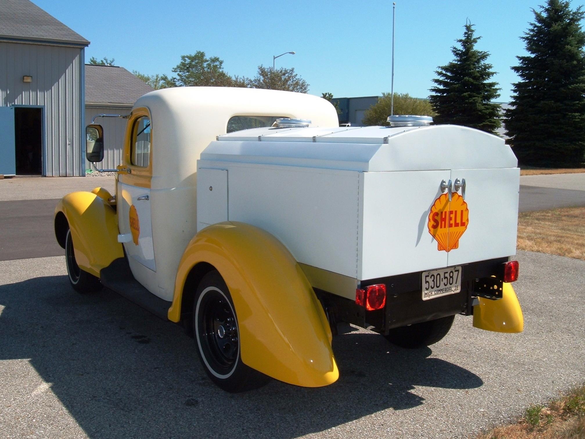

  12. Glad to see you are making progress on the Plymouth.
    I have been driving the gas truck all summer, about 4,000 miles so far.
    The 270 poly. eng. runs great. Was getting about 10 mpg, w/stromberg 3x2 set up. Changed the center carb. jets from .048 to .045, getting 15-16 now.
    Bob

  14. Dang ALLSTEEL - that truck looks great! Thanks for the hint on bumping up the mileage. I'm only gonna run a 2x2, so let's hope I can get your mileage or better (at least after I quit putting my foot thru the floor).

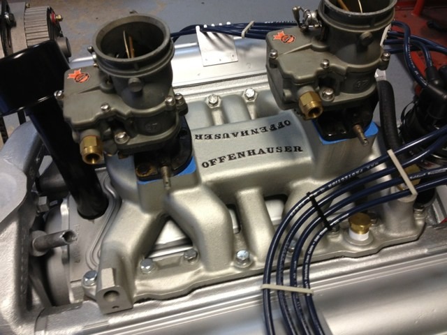

  25. Yeah, but Bob...your engine is sick looking with the orange block, silver valve covers and that :eek: crazy 3x2 intake! I bet you have fun catching old codgers staring at that thing and puzzling over those valve covers...or young guys telling their girls "that's a '58 small block with some of those flapadoodle heads, machined out of a solid block of hammer forged unobtainium!" Yup...I know I'm going to enjoy that part when we get her all put back together right!

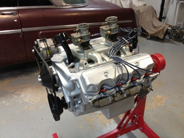

  30. More pics from Dan... Oh my GOD! Tell me that motor doesn't look AMAZING!
    I'm breathing hard just looking at pictures!
