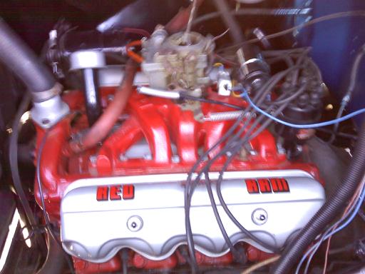

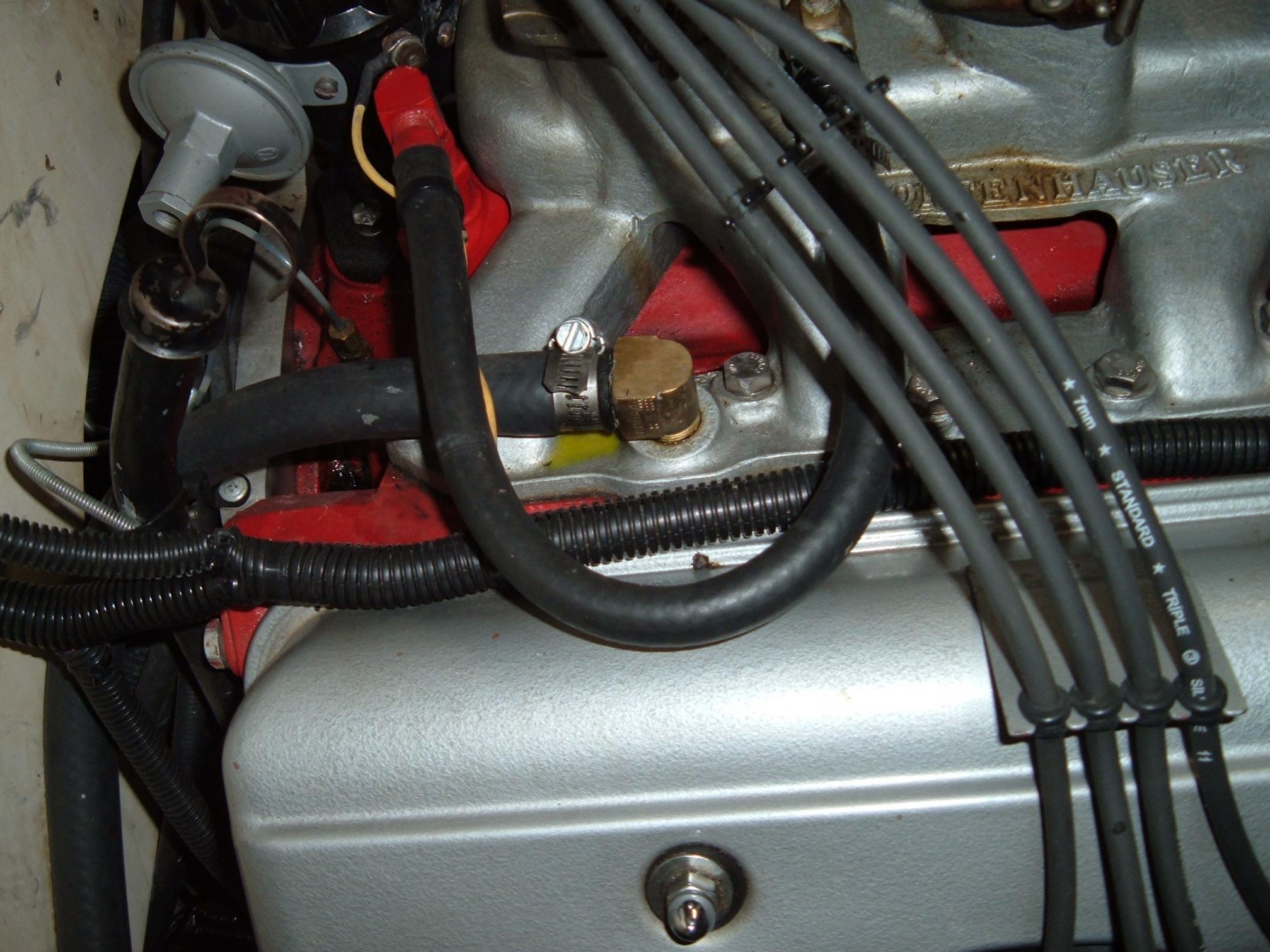

  29. Pic. # 1 Plug heater hose out let in back side of water pump.
    Pic. #2 Use water out let on the back of intake on passenger side.
    Pic. #3 Run heater hose to intake side of water pump.
    This set up works vary well for me and looks so much cleaner. Just a thought.
    Bob
