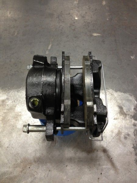

  4. Disc brake conversion time...
    After floating around in the trunk for a couple years the rotors needed a little love...
    Calipers cleaned up and loaded...
    All together...
    Here's where it gets fun! :rolleyes: Passenger side wheel went on just fine...driver side, not so much. After a little head scratching and measuring it turns out the rotor was bad! The center hub and wheel studs were off in relation to each other and the wheel wouldn't go on. Check the clearance on the hub...
    Daylight on one side...
    Tight on the other...
    A trip to the parts store for a new rotor and all is well again...

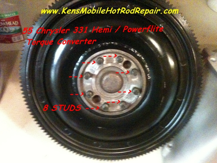

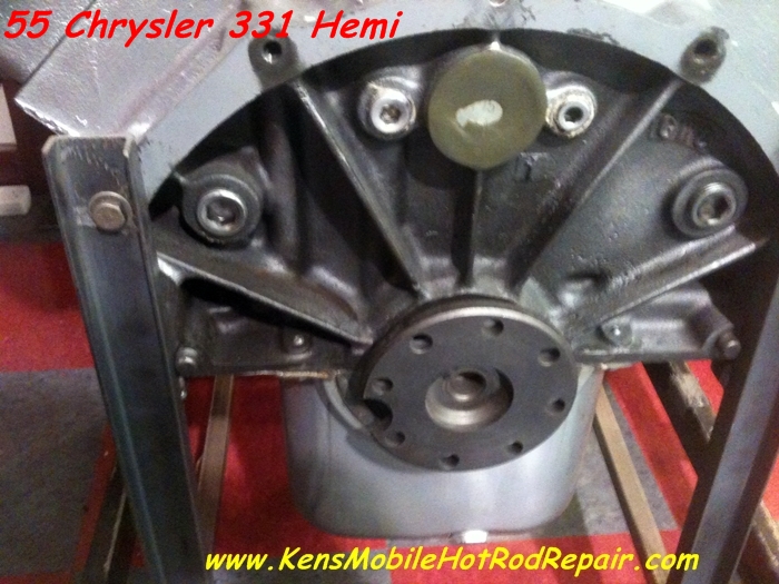

    :)here are some pics that may help you ...They are of the back end of a 55 331. Shows the crank flange, the converter and the third pic shows the block plate and bell housing, also see the dust shield that is removed from the bottom to access the converter nuts...
    And if the "270" poly is like the 331/354/392 family (Windsor "poly" motors have the same lower end as a similar sized early hemi, & the heads fit...) there might be hemi heads somewhere on our planet for you...:):):)

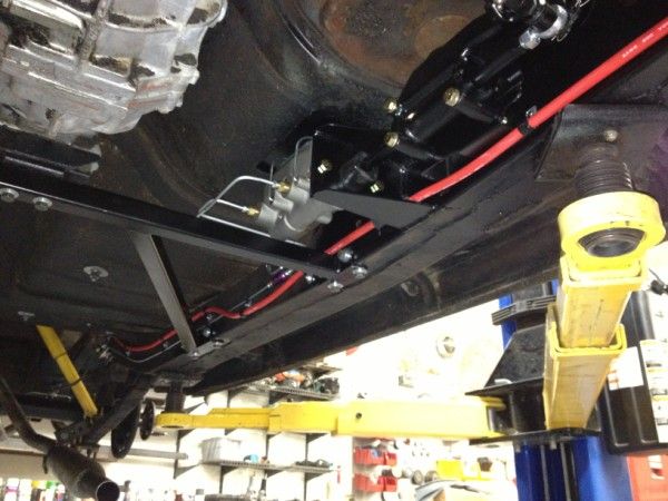

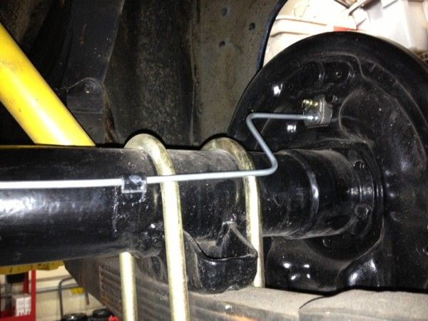

  15. Brake lines and trunk mounted battery...DONE!
  16. OahuEli
    Joined: Dec 27, 2008
    Posts: 5,243
    OahuEli
    from Hawaii
    Nice work on those brake lines Dan! Seems like one of the biggest pains of making up new brake lines is doing a nice neat job and getting all the radii just right the first time. Looks like you nailed it.

    Looks great! Just one question. I think you have two drum brake residual valves in place on both lines? I think the front line should have a blue one (assuming Wilwood or Speedway sourced) for your new disc brakes up front? Again, looking great!
  18. Scott_Rod
    Joined: May 23, 2006
    Posts: 503
    Scott_Rod
    Ahhh,,, if you look real close, the one on the top is a 2 lb. valve and the bottom is a 10 lb.
    That Danno is on the job!
    Dan must have special ordered matching purple ones for color coordination!

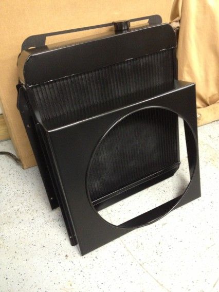

  20. Fan shroud fabbed up for the new rad.

  25. Radiator, shroud, hoses, etc. are in...

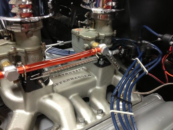

    Throttle linkage and return spring are done...

    :eek:Hi Wolfhound423.Noticed the translucent red fuel line used to connect the two carbs.Have read that that stuff in not very tolerant of the alky laced fuels that we have to put up with today.Might want to consider changing to a more gas resistant type.Hate to see all of your blood,sweat and tears go up in smoke.
    Just a thought.
    Good luck.Have fun.Be safe.
    Leo
