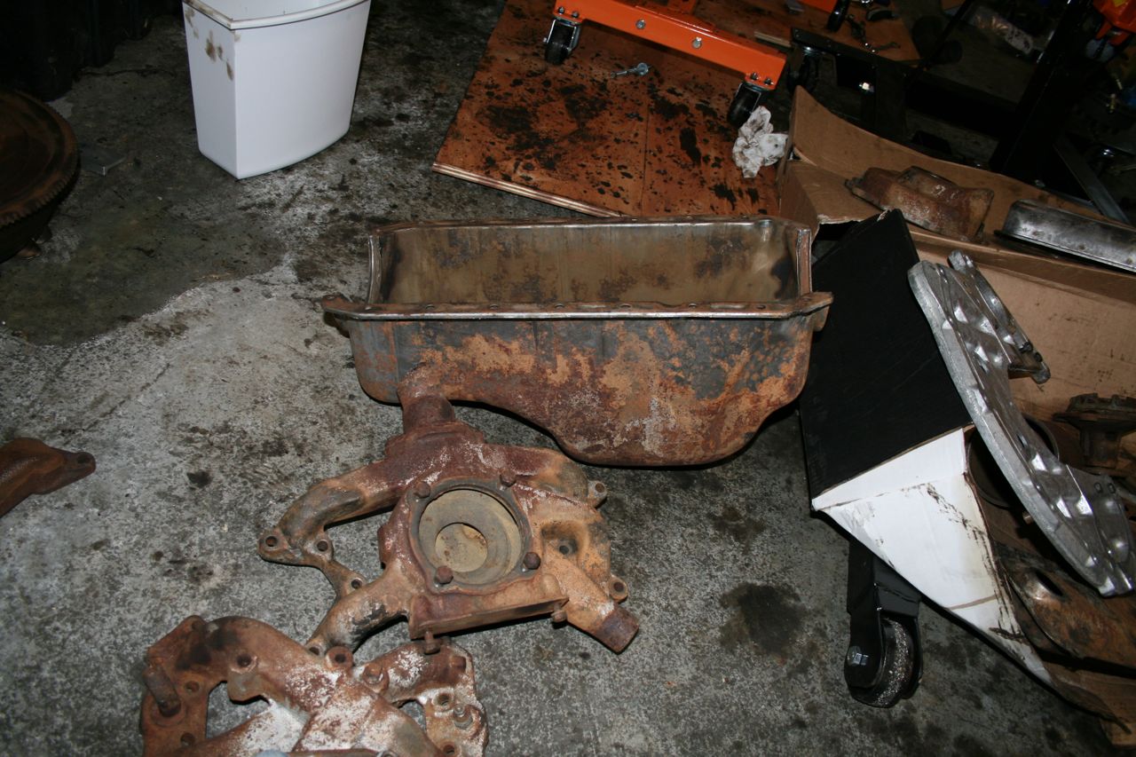

    Good news: got all the tin painted for the engine, when she comes back from the machine shop. I have included the before and after pics - there's a lot of elbow grease on top of the hot tanking and sand blasting. The metal looks soooo much better with the right (period and hue) paint on them.
    Bad news: as I was prepping the exhaust for some Hi-temp paint, and discovered a fatal problem. Yup - a thru and thru crack. Ugh! Progress has ground to a halt until I find some fitting subs***utes. ****!!!

    I noticed that you sand blasted your oil pan, a word of caution: if there are any baffles in the pan or any crevices that could trap particulate you must remove the baffles and clean the area to prevent blast media from being ****ed through your oil system. It is considered bad practice to blast the inside of oil pans or covers that face inward on the engine, as any little crack or crevice that can hold particulate will and it will destroy your oil pump and possibly the lower end if you don't have a full flow oil system. Just something to keep an eye on. The build looks awesome though, I hope the best for you.
    Mike
  30. Mike - thanks for the word of caution. There are no baffles in the pan, and I cleaned her out for a fare-the-well - got in all the little crevices with solvent, a bronze brush, and chased all the grunge out with high-pressure air. Still, I plan on re-inspecting it before I put her back together, just because sh*t happens. Hell, by the time I get this motor put back together, there could be a colony of mud dauber wasps living in the oil pan!!
