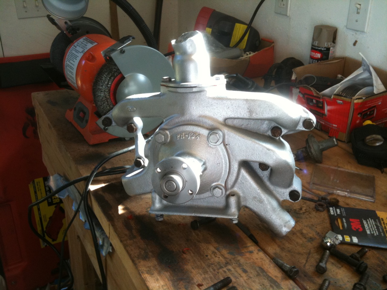

    Feast your eyes on this! I picked it up at the UPS depot this morning, dropped it off at my favorite sandblaster, went to lunch, then went and picked it back up. It was damned near spotless. A few minutes with a wire wheel to get some of the nooks and crannies he didn't get, and then a few quick coats of hi-temp silver paint to match the old one...and Voila! She's a beaut! :eek:
    Now all I need to do is get another exhaust gasket and I'll be back in business. Oh, and I need to get the rocker shaft bolts back from the machinist too!

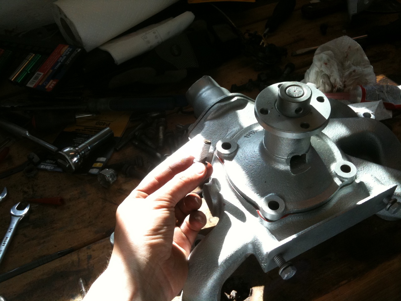

  24. Stopped by the machine shop today on the way home and picked up some custom made rocker arm bolts for my Hyfire. Yes, I only need 4 for my purposes, but there are others out there who can benefit from my stash of extra goodies. It turns out that Bill was able to set up the machinery quicker than he thought, and was able to crank out more than he originally estimated for the 2 hours he put into it. These are made from 4140 steel, so they REALLY shouldn't break at 15 ft/lbs of torque. Then again, the old one was 55, and had obviously seen some hard use. The in-laws are here this weekend, but I should be able to sneak out to the garage for a bit after church on Sunday. :D
    Gary - I have 4 bolts standing by to send to Ory-gun for your Hyfire rebuild... send a PM for mailing addr, and we'll get them headed your way.
  25. I had a few hours this afternoon and managed to stick some stuff together in the garage. Whew. It's finally starting to look like an engine! The newly machined bolts fit like a glove, and the Hyfire project is back on track. I got the rocker arms back on, added the timing cover, and mounted the oil pan. Now all I need is another exhaust gasket (on order) to show up and we'll be cooking with gas!
