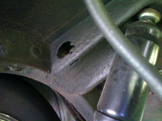

    I was checking there and the floors, if the floors were done they did the whole pan, and tarred the crap out of everything. If you get behind the car and look at the back seat from the rear bumper, and under the the gas tank, whats the area up top behind the seat? The truck was a whole piece also looked stock and I checked in the edge corners where it looks like all the water and anything small would fall in. There was some sort of panel board there.

    Is this a deal killer with a unit-body?

    This is what I say for what it's worth if you like it go for it.If you have the time you can fix it as you go.Rust is never a good thing there is more than you can see.These cars are a lot of fun but hard to work on.If you get it take the time and talk to someone face to face before you start a V8 swap it's the small things that turn into large things fast.There is a Guy at Falconearybirds.Com that has a wagon like mine 60 2dr for 3,200 just something to think about he also has a lot of parts and want rip you off.Anyway what ever you do have fun with it.

    Yes - it looks like it is the shock tower and one big pot hole or bump and that shock mount can break.
    Deal breaker ? Yea would be to me.

    The tar would make me turn and run, not walk!!! the last time I bought a vehicle with a tarred under floor board, it was a '59 El Camino that had spent it's entire life here and in Nevada. Under all that tar was a patchwork qhilt of license plates, road signs, and roof flashing material. I replaced everything from the outer rockers to the trans tunnel...
    It would be with me! As said above, that's a shock cross member that runs below the seat in the back. one good bump where stuff bottoms and your done.

    According to PO the floors and rockers were replaced and the wheel well lips, when he was done he bedlined it all.. I know we all know PO's... The rockers and floors are one piece I can see that. no doubt it has other bad spots, but looking around in the north east he's not out of line. I'd love to just go and buy something but I'm trading my 94 mustang gt convert... I've not had any takers on it for cash, 90% of the trade offers involved a lowered s10, some sort of rice burner and a total basket case.
    I guess when I looked at this I wasn't to concerned to much. I can see it would be a pain to get at. Are you all thinking it's softer than it looks? It almost looks like that hole was round to access something?

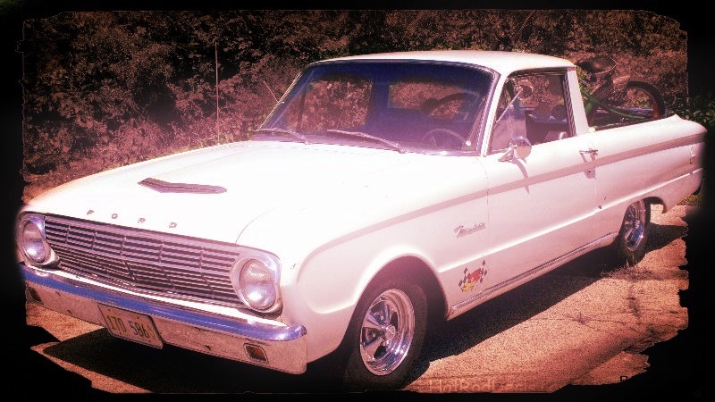

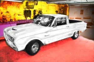

    I got this Ranchero for $2800 last Sept. I have driven it all year,took it to Torquefest,plan on taking it to Jalopyfest,and the Iron Invasion! I added the Cragars,Cal Custom wheel,and door hardware. I also swapped the dash pod from a Mercury Comet. It also had the trans swapped to a c4, gen to alt,and single to duel master! It has not left me stranded yet!and I drive the hell out of it! My best car buy yet!

  19. Would you be willing to repair that if necessary? Is there more rust like that? I'm guessing there is. Let's see pictures of the floor repair, "undercoating", and such. I get the feeling there are hidden problems.
  20. Package shelf.
    Yeah, they come with a pressboard-like panel to keep stuff from getting in the space between the wheelwell and quarter panel.
  21. My '61 Ranchero and Comet don't have a hole there. Somebody with a '63 should check theirs.

    I would question how they were replaced and what was used. You've probably seen the threads where the "new" floors a PO put in were made up of chicken wire, bondo, and whatever else they had laying around.
    I know the market is tough right now, but I would still caution about a rusted unibody car. At least you are asking questions before hand. If you do decide to jump on the trade you will know what you are getting into.
