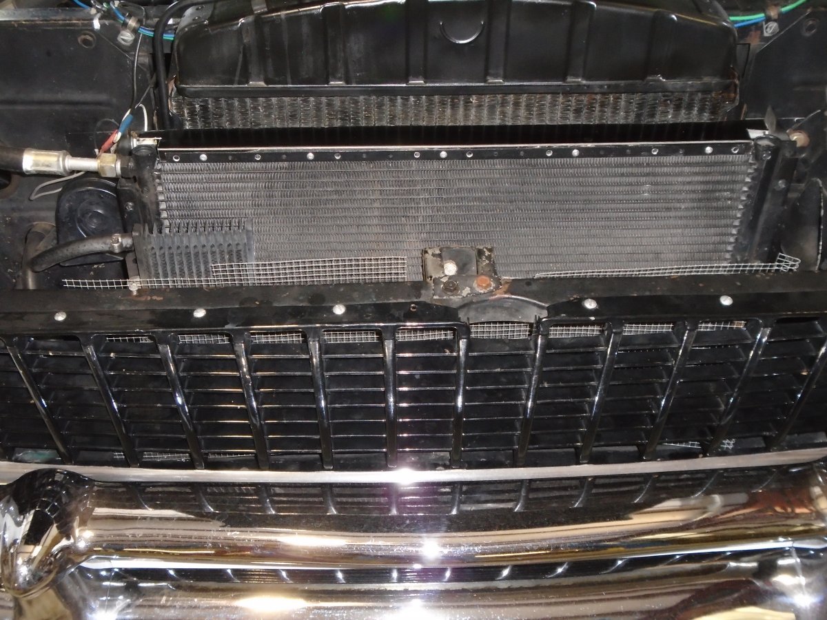

    I have a Southenrods heat-air unit in my 55 wagon. I put in a big boxed in condenser with a fan shroud and 7 blade fan and a GM compressor. I have 32 degree air at idle so cold temp. is not a problem. The compressor shakes and pulsates at low rpm. I have tried every thing including a new compressor and a large muffler. I am thinking it may be the expansion valve pulsating. 2016-07-14 005.JPG

    Dan, have you called Southern Air Customer Service for advice?

    It just hit me today the expansion might be the problem I will call next week. I will post what they tell me.

    Had a nice long talk with the a/c tech at southernrods he ask me how long I pulled the vacuum I said 20 min. He told me the compressor rumble was from ice in the system and I should pull a vacuum for 1 hour.

    Yeah Dan, was told the same. First time I also vac'd it for 20min. Next I did it for an hour, Still no better. So I went to buddy that is a pro auto tech with a good a/c machine. It pulled vac down to 28inhg (better than my unit) for an hr, and it still vibrates. Was thinking bout replacing pump. But, what you said bout exp valve, maybe that might be a problem. My unit will freeze up the evaporator if I try to run it full bore. To my understanding a exp valve should never do that because its self regulating? Between it & therm switch it should never freeze.
