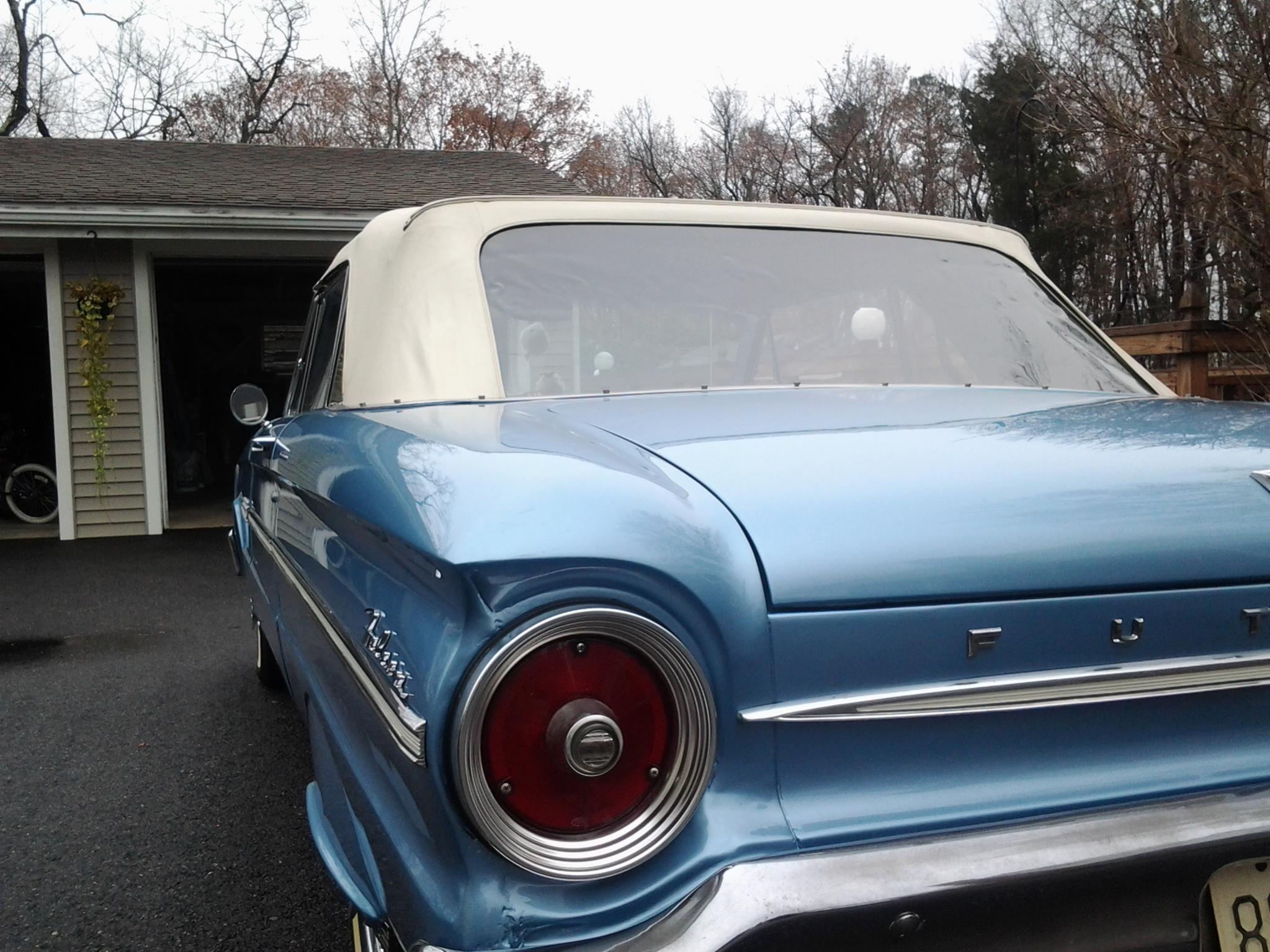

    Had a few over the years, played with the rancheros had a couple 63’s. Fun cars cheap and easy the thing that bugs me is that mess under the drivers tail light. If that is acceptable to him what other worms are you gonna find?

    As stated, if there are no rust problems sounds very reasonable. One flag seen in the pics you posted is the body work surrounding the left taillight. Did the body person fall asleep in that area or are there other trouble areas as well?

    Yup. With that being the only close-up pic, and showing obvious hasty repairs, I would be looking this one over very closely.
