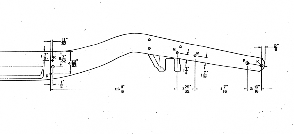

    Looking for side dimensions of a 1932 Ford Duece frame.
    I have a Kiwi built frame and now its time to drill out a hole for the F100 steering box. Thought a drawing would help.
    I know i've seen a print around here somewhere.
    Dont see it on the Westcott website.
    Thanks!

    Wescott has always had it in their print catalogs in the back pages. I think in your case where you are kinda starting from scratch, rather than adhere to where it "should be", I would mock up or mount the motor and put it where it should be. Does that make sense?

    Here's one from my saved pic's.I'm not sure were I saved it from.Hope it helps.
      15.9 KB
      1,994
  5. Slick, do you have the the other end dimensions ?
