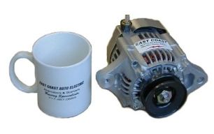

  13. Find your local industrial electric motor shop.
    Get a small denso from a forklift. 65 amps and fits anywhere.
    Same as here but should be 1/2 the price http://www.ecae.com/alt1.html

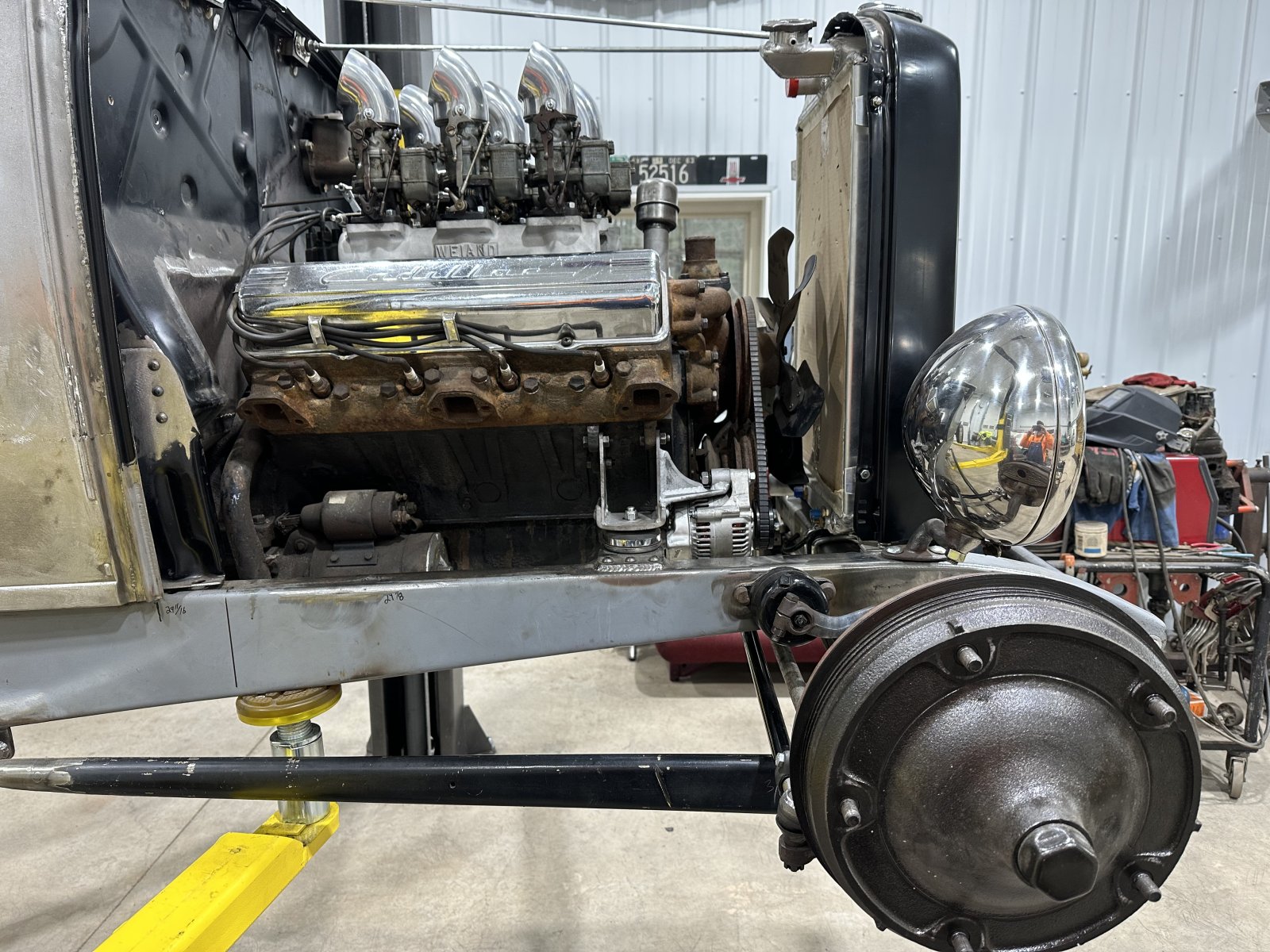

    Posts: 1,038
    Mike Paul

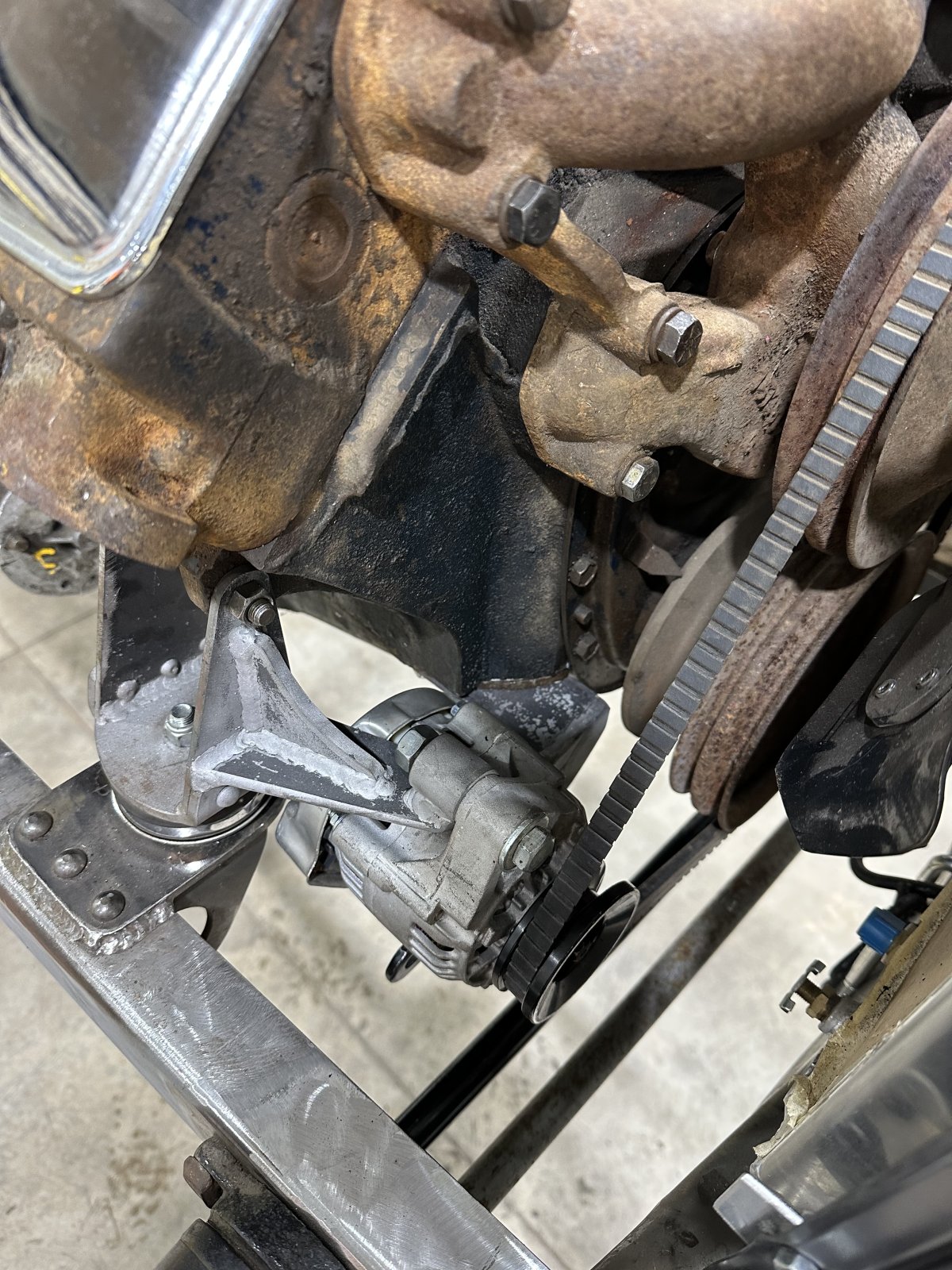

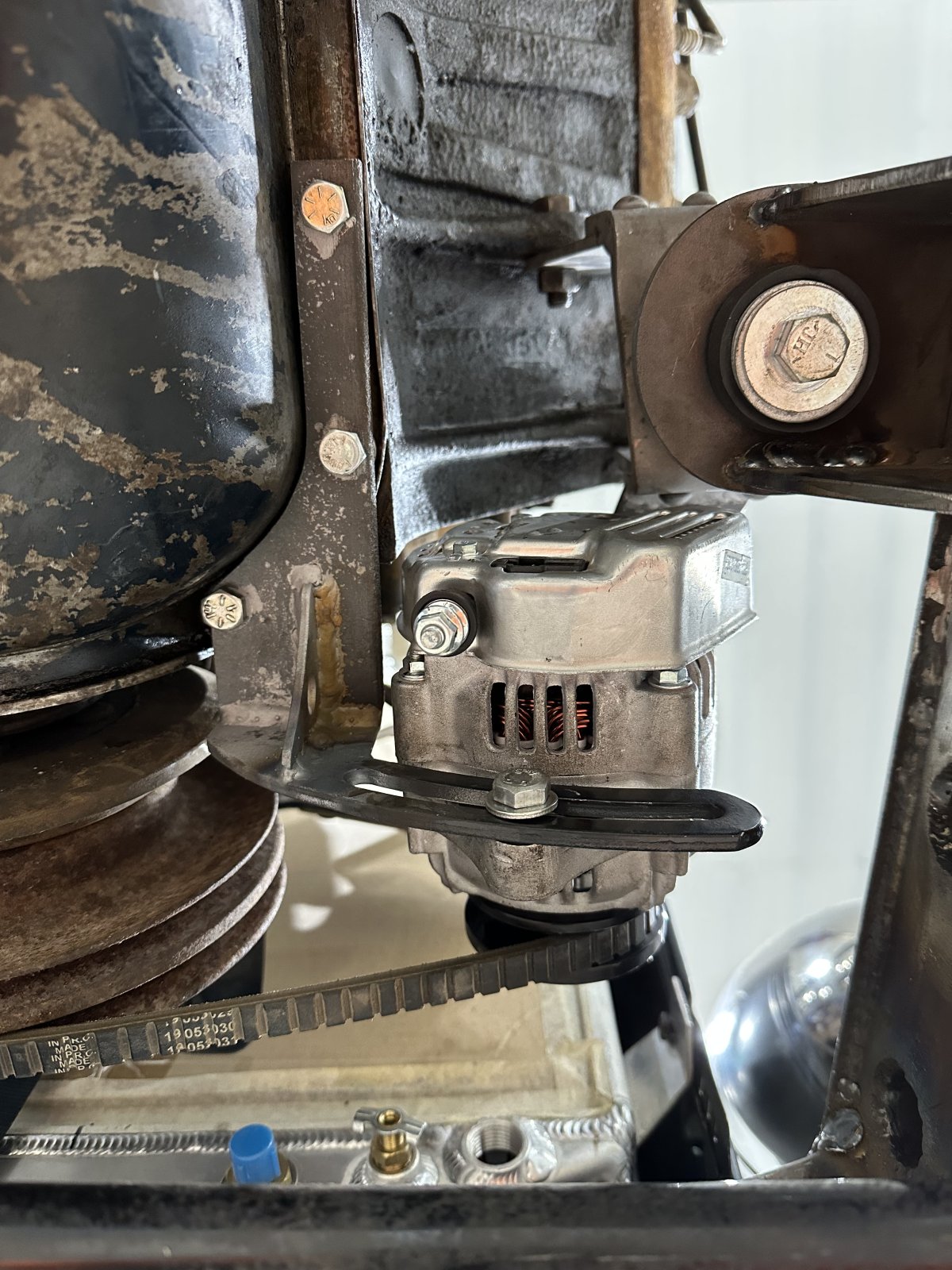

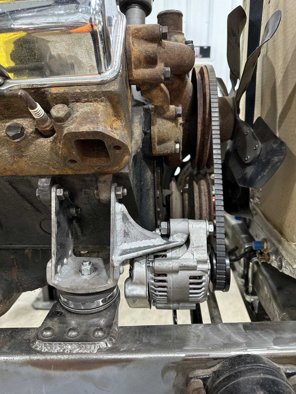

    Well it’s been six years but I’m finally getting around to fabricating an alternator brackets . Since there is no accessory holes in the front of the block I fabbed a top bracket off the engine mount. The bottom bracket will be bolted to the oil pan bolts. I’m still working on that one.

  26. Mr48chev
    Joined: Dec 28, 2007
    Posts: 36,036
    Mr48chev
    That should work pretty nice when it's done. What alternator did you end up using?
  27. Mike Paul
    Joined: Oct 10, 2003
    Posts: 1,038
    Mike Paul
    So here’s what I came up with. EFCB80DF-3609-4520-B9D9-48254A9E9B70.jpeg 8C2591A9-C8C3-480F-89B8-D93FC1E29B41.jpeg 6154B8B8-16E8-42AA-A608-EC43727FAD9E.jpeg 5751B7D8-E8E8-46D3-B923-0A2096A07F75.jpeg 96C8551F-54CD-4502-9724-265996559847.jpeg 134540E5-25A9-4CBB-AB37-CE190D9707EB.jpeg AF465736-9C80-4D12-88FA-0693A58C3E77.jpeg
  28. kadillackid
    Joined: Nov 11, 2006
    Posts: 638
    kadillackid
    Success ! with plenty of adjustment, nice job.... :rolleyes:

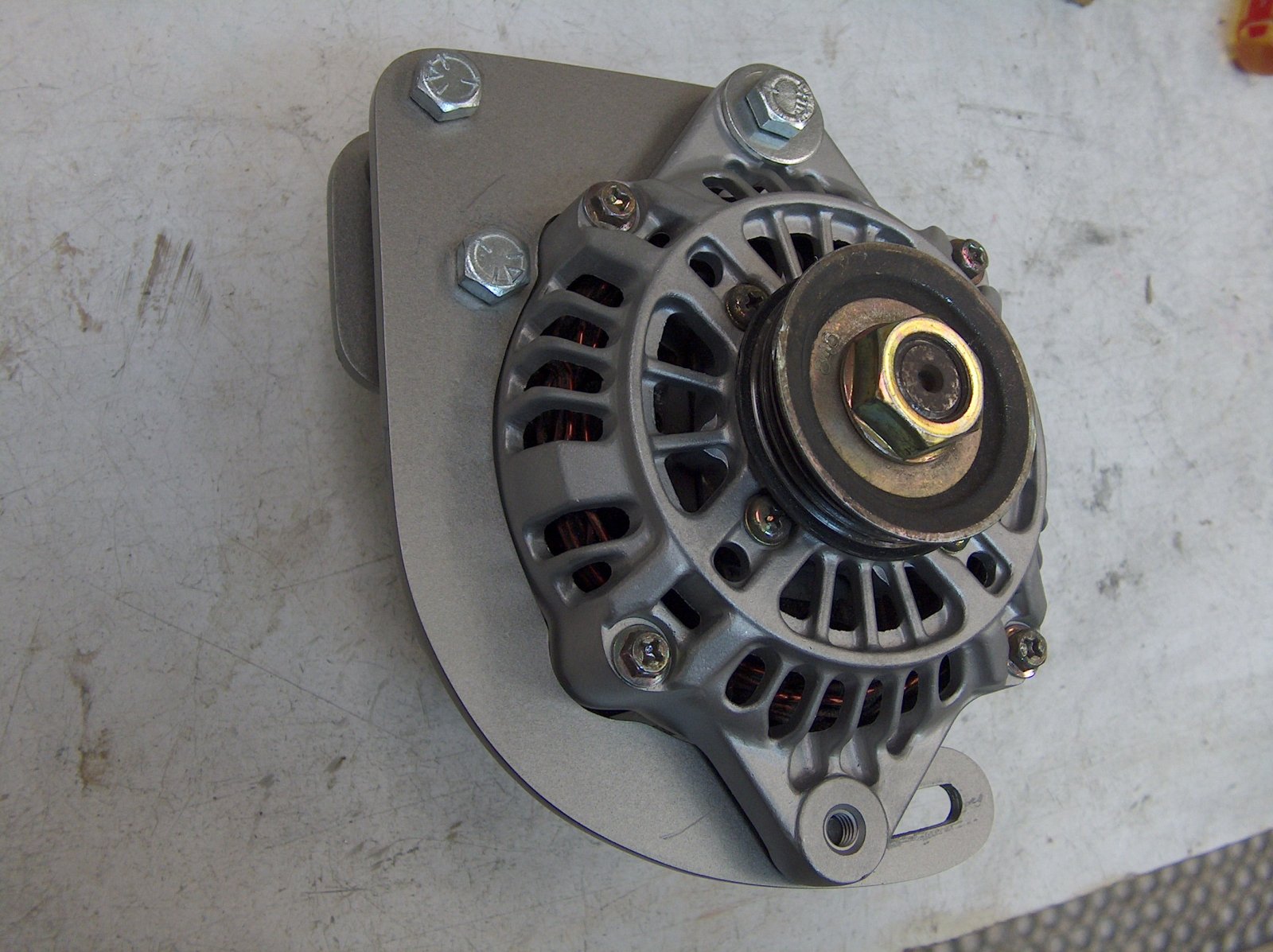

    Another compact alternator to consider is a late 80s 55 amp Chevy Sprint.
    Pictured on a SBC, to illustrate the size and home made brackets. HPIM1724.JPG A-5.JPG
