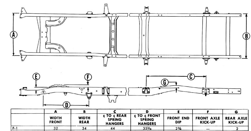

    looking for all of them. Trying to compare them with another frame demension sheet for a new project

    Here goes, 48-52 F1-F3
