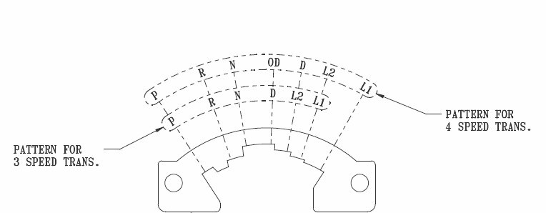

    I'm retaining the OEM hydramatic column in my 46 Olds and using a Limeworks assembly to work a 700R. I'm mounting it behind the OEM Olds shifter head. I'm still deciding on whether or not to use a morse cable or shift rod assembly to connect column to transmission. Shift gate may require modification to suit AOD. Or you could do what @X38 did with his sloper column and modify it to work with auto trans.

    If you kept the OEM steering box, the main 'flaw' with the OEM column is it lacks proper shift detents for the newer trans. This can be addressed by modifying the detent plate at the top of the column by welding/reshaping the plate. This can be finicky work but is definitely doable. Will probably also require working on the linkage geometry and the neutral safety switch, which I'll note would very likely have to be done with an aftermarket column too. If all you're really concerned about is getting P/R/N/OD/D, you can 'adjust' the OEM linkage (along with 'correcting' the linkage geometry) to operate those but won't have access to all of the lower gear detents without modding the detent plate. Remember that the '56 neutral safety switch only allows starting in neutral, not park.

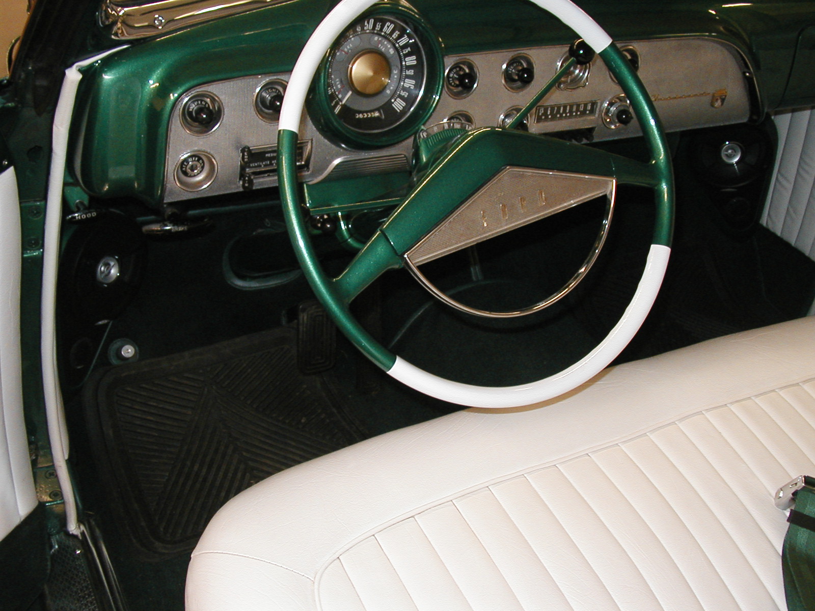

  13. Sometimes ya just gotta get past the instructions and move forward with what you have. I was told I couldn't do it but they didn't know my hidden talents. I won't put any Tilt Column in a Old School build period. Stock 2 speed 51 column Connected to a 700-R-4 and the selector in spot on Park, Neutral, and Low. All it takes is understanding the Job at hand a little Math and some minor Fab Skills. It's also connected to a GM power steering box. It was no big deal, just a job.
    Could imagine this interior with an Idiot Tilt column in it?

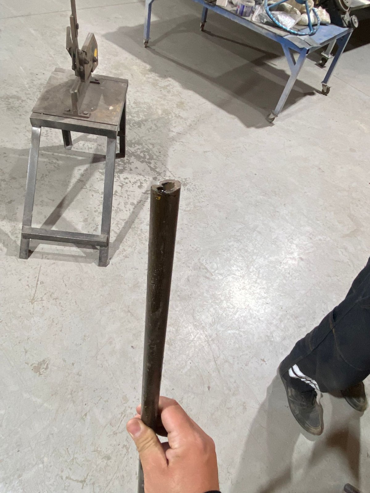

    You guys aren't reading, he said a couple of posts above that the reason he needs a new column is the shaft is broken in his, and he can't find a replacement in Turkey. I figure any American cars that were imported there were mostly gone years ago, so he can't just run to a junkyard and grab one.
    Maybe one of you guys have one you could sell and ship to him, or maybe he can find a machine shop to make one or repair what he has.

  23. OK, so somebody cut the steering shaft. Do you have the part that was cut off? Do you have the complete OEM column assembly and steering wheel? Any other missing parts for the steering, like the pitman arm, center link, etc etc? If your only real problem is the cut shaft, repair it. If you have the cut-off piece, find a good welder and splice it back together. Even if the piece is missing, all is not lost. Ford used basically the same steering box '54 through '57, with the main difference being shaft length. If you can find any of those (other than a '56 box), simply cut a length needed to return yours to the right length and weld it together. If you can't find one, have your brother pick up a 24" length cut off the top of any of these and bring it to you. Clean the part up, maybe media blast it, and he can tell customs it's a 'refurbished' part, I.E. not used.

    Thank you very much Steve, actually my problem is the steering. shaft and unfortunately I am missing the steering box, I had it but upon extensive searching I could not find it, so lets say if I get a borgeson steering box it will work with OEM steering shaft I guess. So. if I could not locate the steering box in that case in order to use it with OEM shaft, borgeson will work with that is that correct ?
