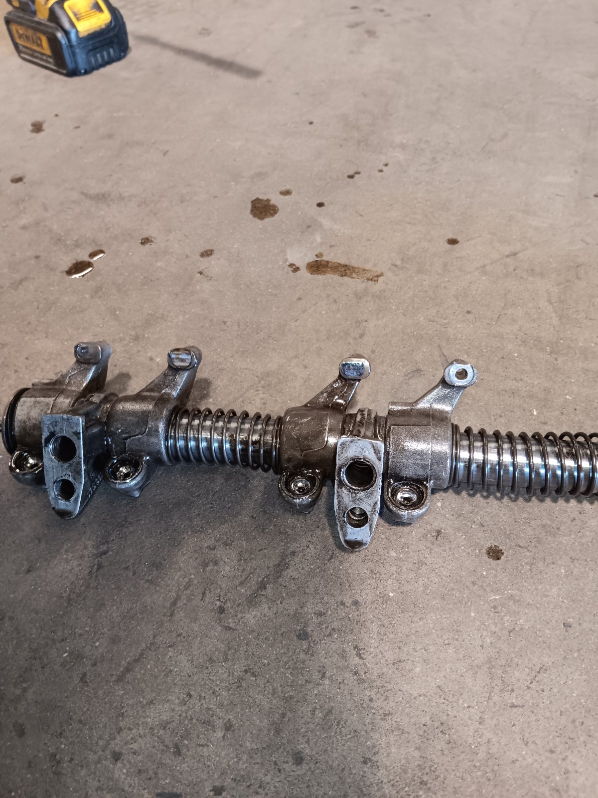

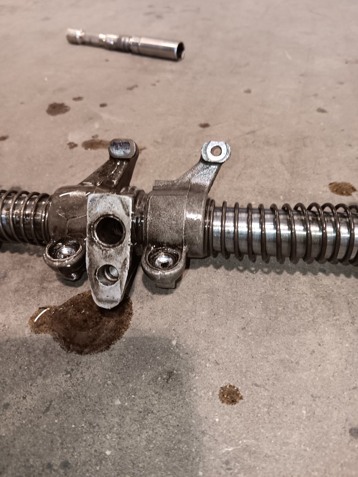

    Went ahead and dug into the top end Because it had a lifter tick or a rocker arm noise or something? And that was the reason that he wanted to rebuild. found number 6 intake rocker missing the little
    piece that goes on the end of the rocker arm. 20230925_153846.jpg 20230925_153806.jpg 20230925_153446.jpg I can find a couple of complete sets of rocker arm assemblies. But I'm just looking for one, and I've got a wanted ad running right now.
    Johnny Gee likes this.
  20. Some of the foreign stuff I have played with uses lash pads just like that. There are companies that refurbish rockers and replace/reface lash pads
    Just digging for you.
    https://www.nailheadbuick.com/rocker-arms-pushrods

  22. Centerville sells a rocker arm refurbish kit for $350. Comes with all new aluminum rockers and new shafts. The shafts are usually worn on the bottom. I have several used ones, will PM you.

    Nail head buick.com does sell individual rocker pads. So I'm gonna call them as soon as I get to work this morning. I'll see if I can grab one from them. If not bangingoldtin is gonna help me out.
