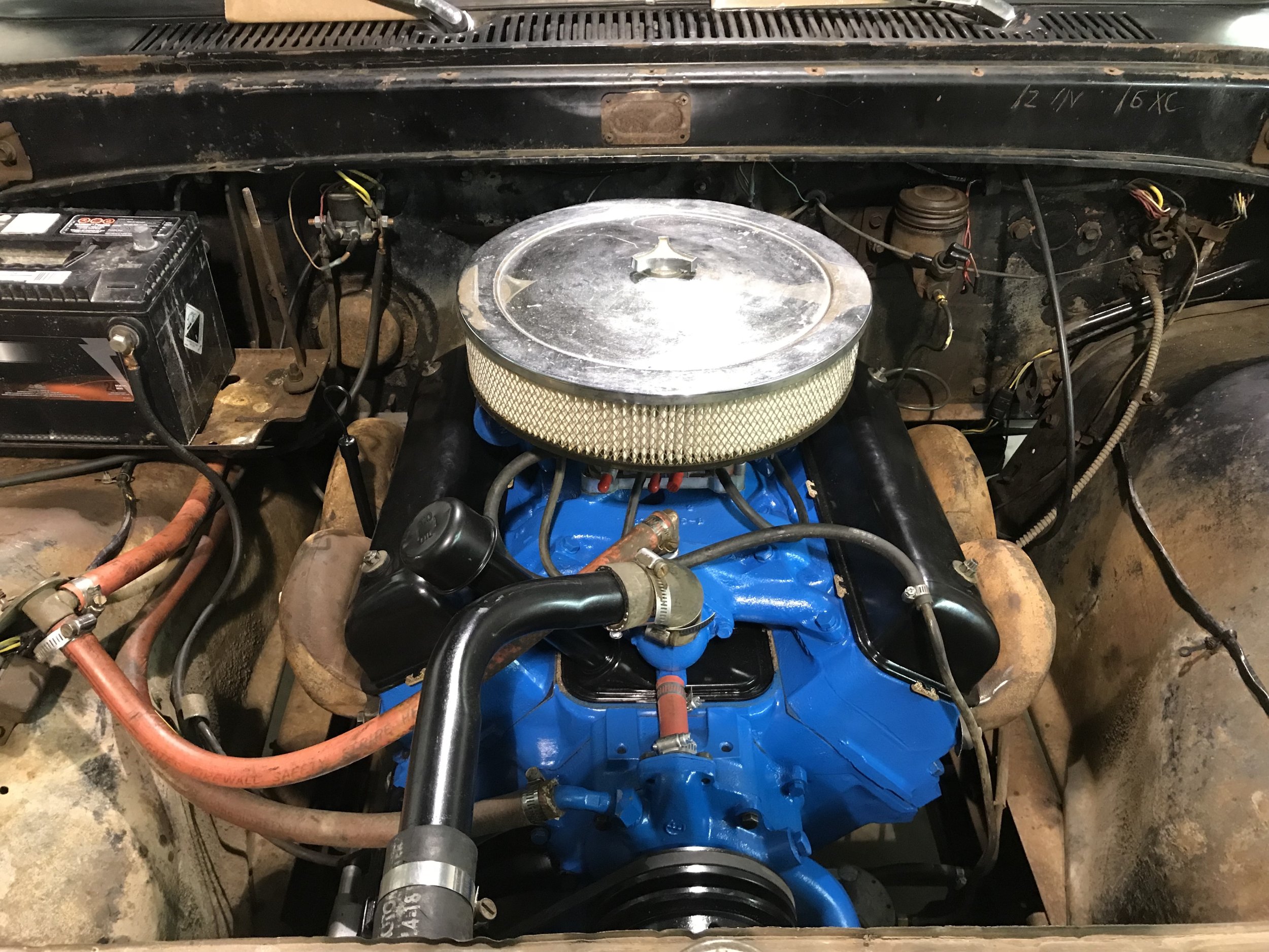

    Head gasket incorrectly installed on driver side is also very common, check to see if you have square corners to the front both sides
  25. Wanderlust
    Joined: Oct 27, 2019
    Posts: 1,080
    Wanderlust
    If you zoom in the corners are evident at the front of the heads
    y'sguy likes this.
