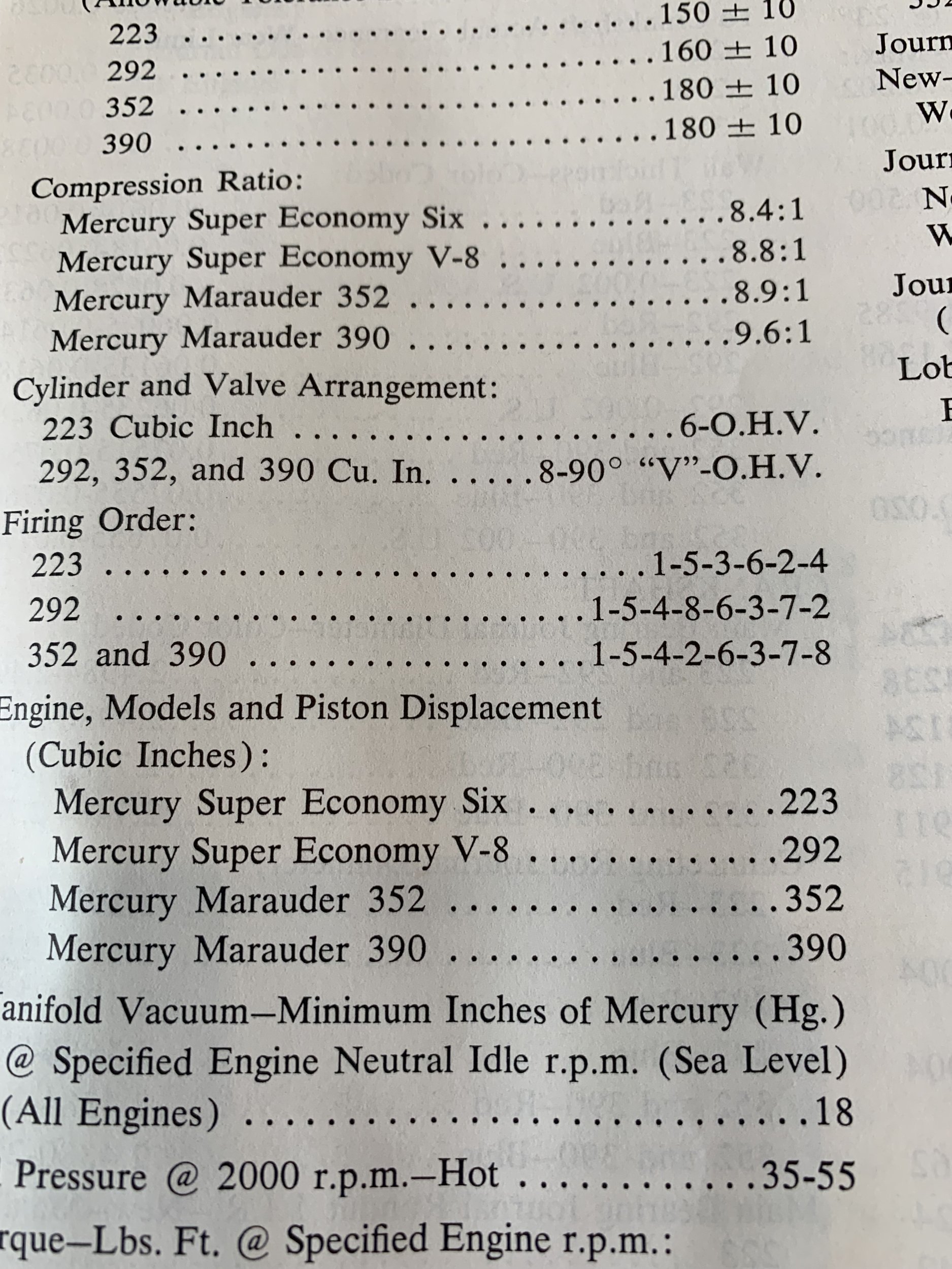

  4. Oneball
    Joined: Jul 30, 2023
    Posts: 1,634
    Oneball
    Have you checked the firing order.
