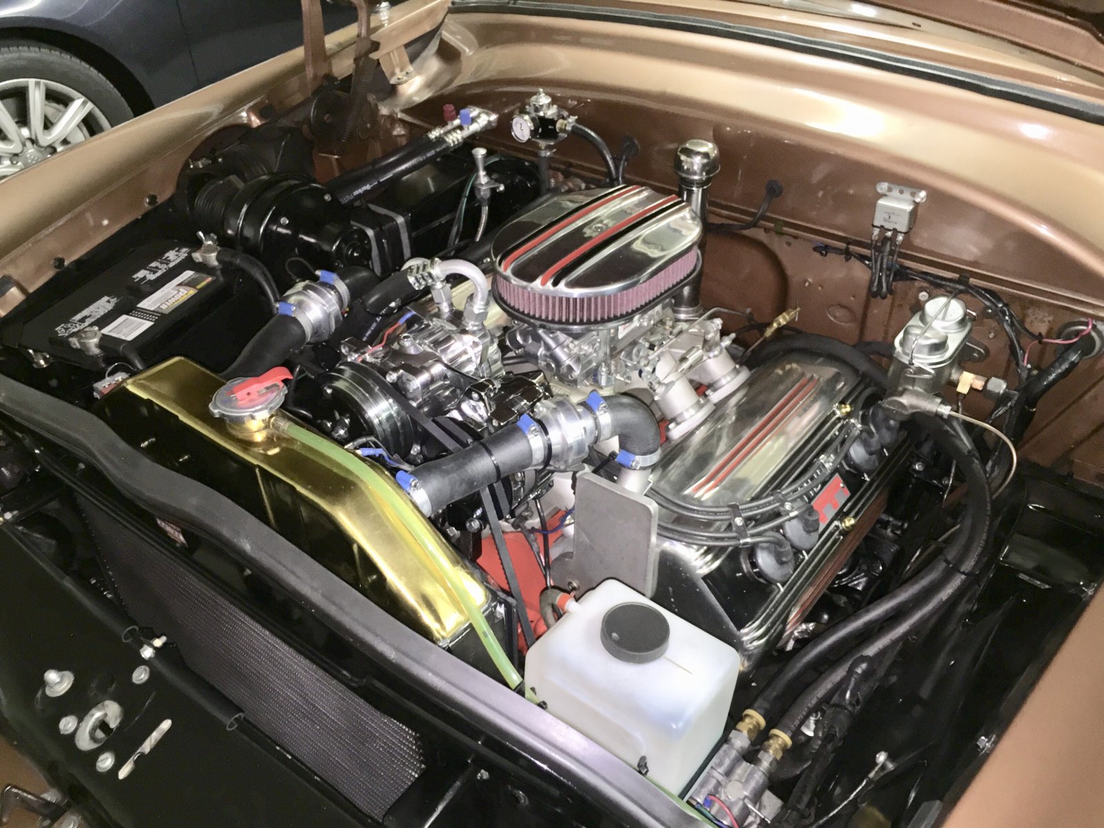

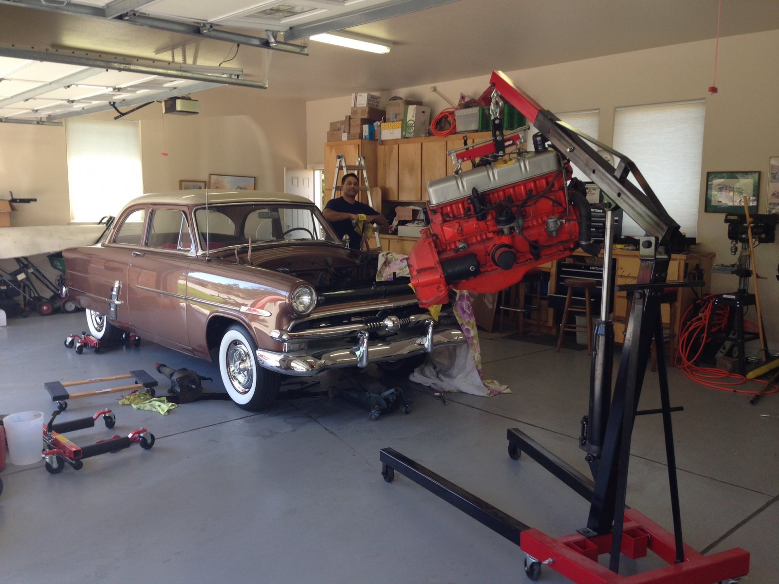

    Don Ferguson, Ronnie Roadster & Luke Balough have been very helpful before and after my original Ardun build. Still running well. Nowhere near Don , Ron’s or Lukes’s expertise but can be a resource if needed. View attachment 5379718 View attachment 5379719 C11FC3C5-7FEE-4209-937C-0F465F713C25.jpeg 66AEB50A-F3E8-406E-B0B4-9122D73780B7.jpeg

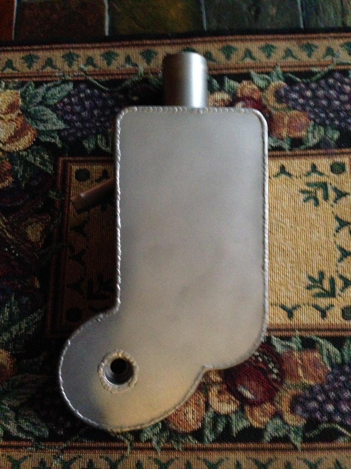

    Yep, early heads that are sequentially numbered 167 & 168. Had to make water outlets because originals interfere with the distributor on 8ba blocks. However, they work well. If doing over and knew what I learned afterwards, I would modify the the heads to allow use of center outlets.

    In any event, it wasn’t done. Did these in stainless and even kept the heater connection. Took a master welder to accomplish this. Minimum distortion, no leaks, Waterjet cutting. 12ECEED2-2338-427B-839D-31E17619A455.jpeg 40EA9E4A-9654-4D4A-94EC-B65CCD4089CC.jpeg
