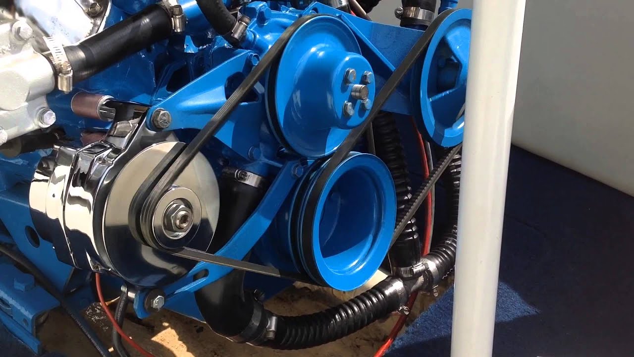

  11. If it's a serpentine belt set-up, you'll need to change to the earlier front dress; timing cover, water pump, and v-belts. If it's already V-belt, then you have options. Ford did build plenty of belt set-ups like you describe, but you generally need a 'set'. If the water pump and crank pulley line up, fabbing a bracket to locate the alternator is relatively easy...
    https://i.ytimg.com/vi/r6c2NWKouUQ/maxresdefault.jpg
    Here's a stock set-up. You may already have something similar, adjust the length of the spacer between the head and the alternator and get the right-length 7/16" bolt, maybe fab the top bracket out of flat stock, and you're good to go...

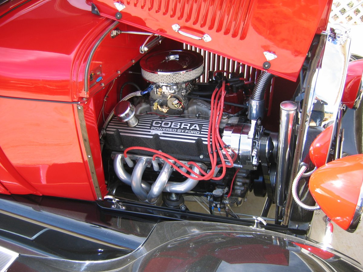

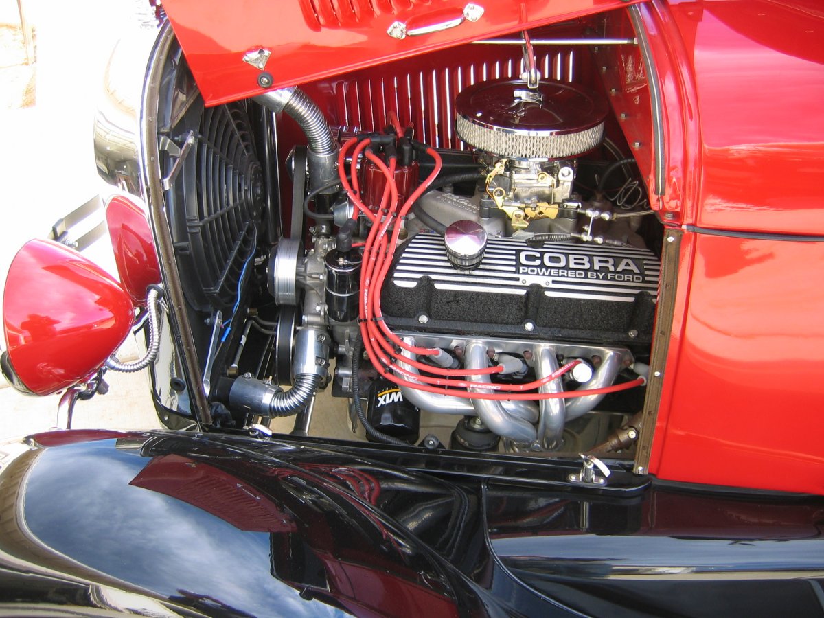

    Here is my 302 , backside of the belt drives the waterpump IMG_0478.JPG IMG_0476.JPG
  19. I don't understand the question. :rolleyes:
  20. He has very little belt contact on the water pump pulley. When using serpentine belts, if you're using the flat 'back' side, you want at least 35% of the pulley in contact with the belt (even more is better).
  21. Dave Mc
    Joined: Mar 8, 2011
    Posts: 3,036
    Dave Mc
    It has been working well for 12 years and many thousands of miles , Waterpumps spin freely so - works for me
