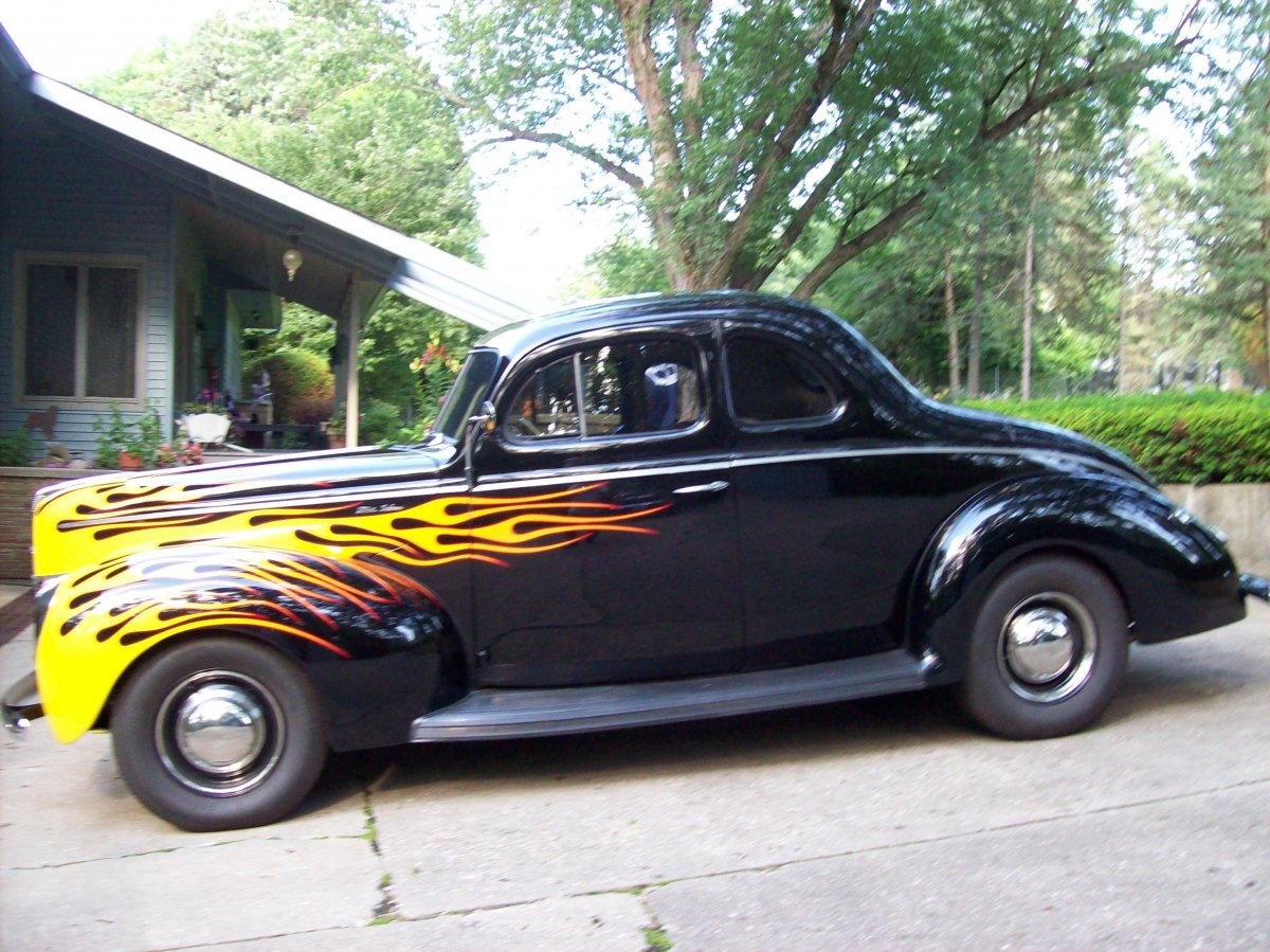

    I use summit racing single stage. sum-lvs300g_oh.jpg sum-lvs300g_oh.jpg 1940 ford coupe july 1 2014 003.JPG lays down nice and easy to spray
