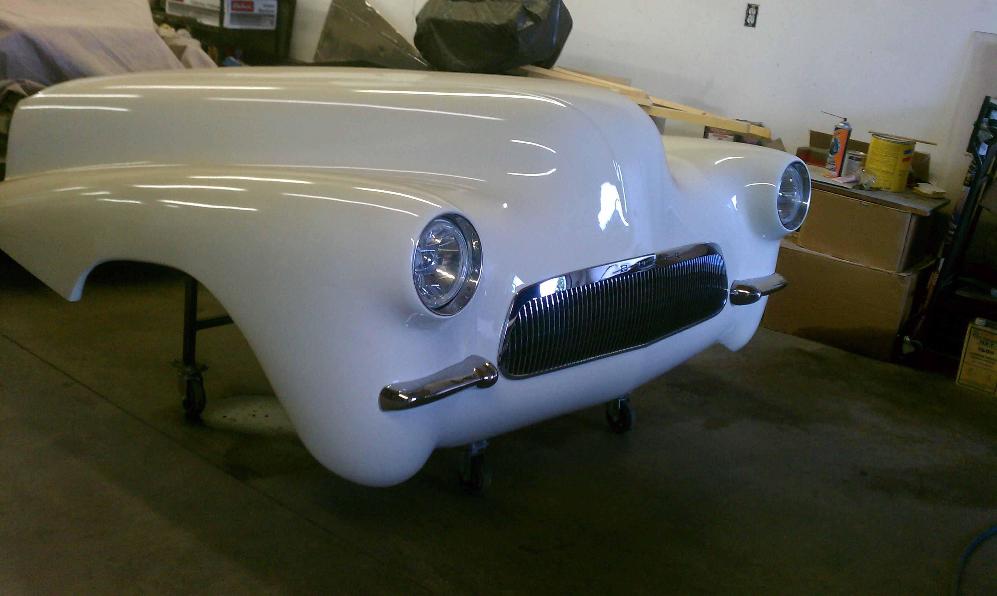

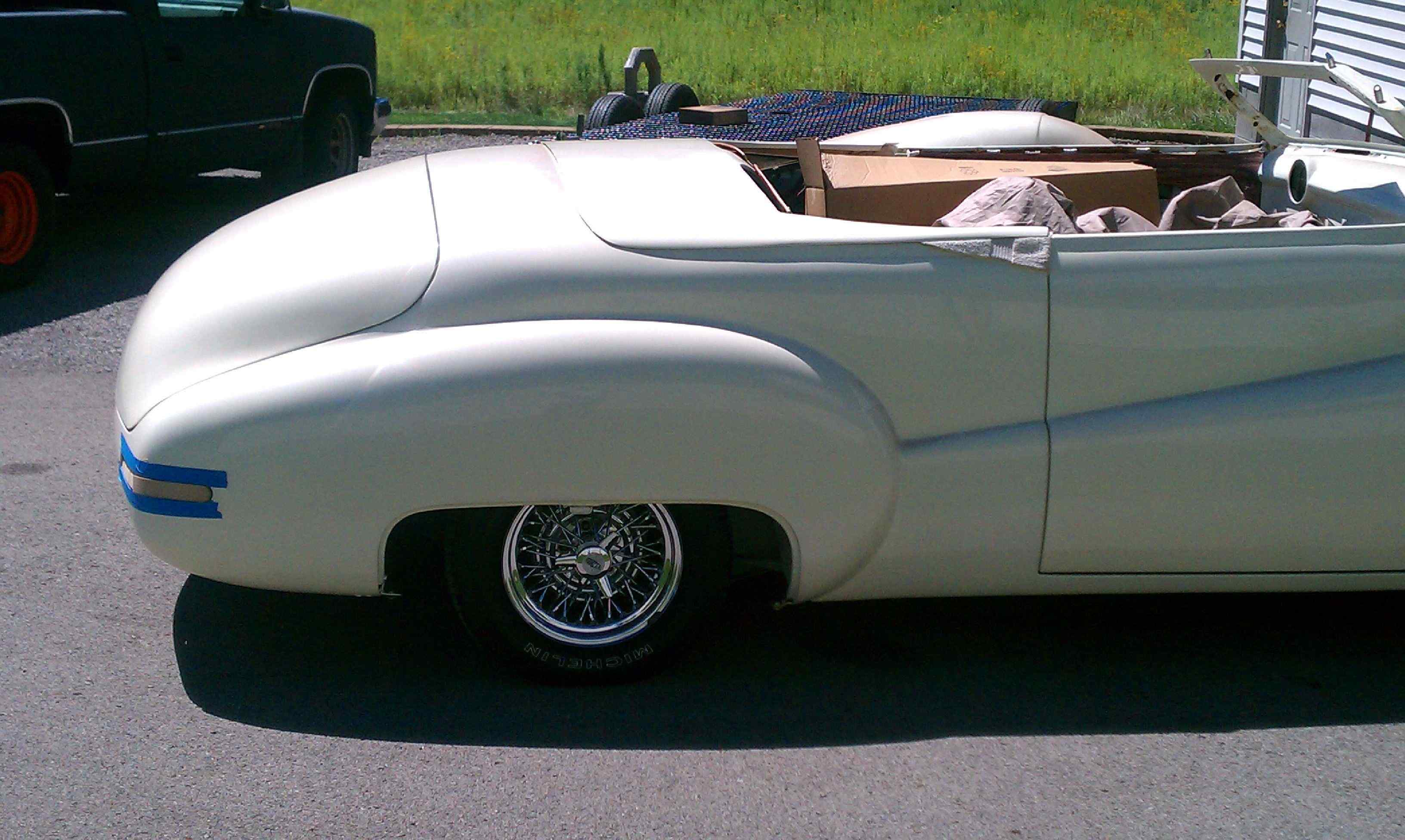

    Attaching a few shots of the work in progress. Hope you enjoy!
    All fenders & body panels where mig welded to body, then hammer welded and finished with lead.
    Front fenders, Hood panels welded together and nose was pie cut 1/4" straight across to eliminate porpoise nose effect of stock hood. Fenders have 53 Mercury stainless trim rings frenched in. 1953 Chevy bumper over riders ground to follow front fender shape and laid over to create nerf bars. 1996 Buick Road Master grill. Entire front end will power tilt over front frame rails.
    Front end is clipped with 1970 Camaro, & will have new custom Camaro upper and lower tubuar "A" arms with drilled and vented 12" rotors.
    Rear end is from a '76 Trans AM with out board disk brakes.
    Engine is a warmed up 455 BB Buick w/ custom aluminum valve covers, Aluminum intake. Carb to be determined.
    As can be seen in the pics, the tail lights are going to be custom made LED items still in the planning working stage.

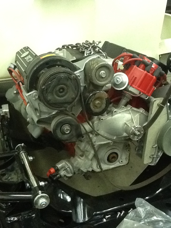

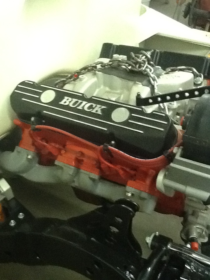

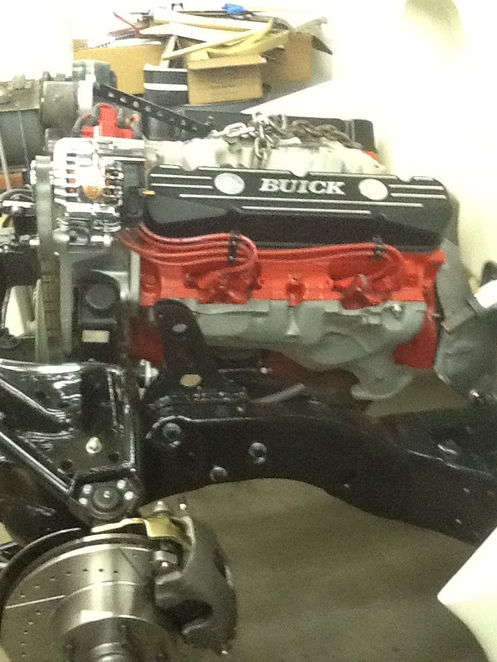

    Attached are several shots of the 455 ci engine going in this cremecycle.

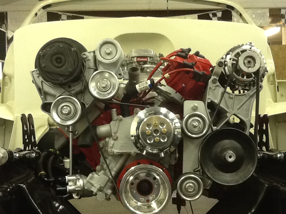

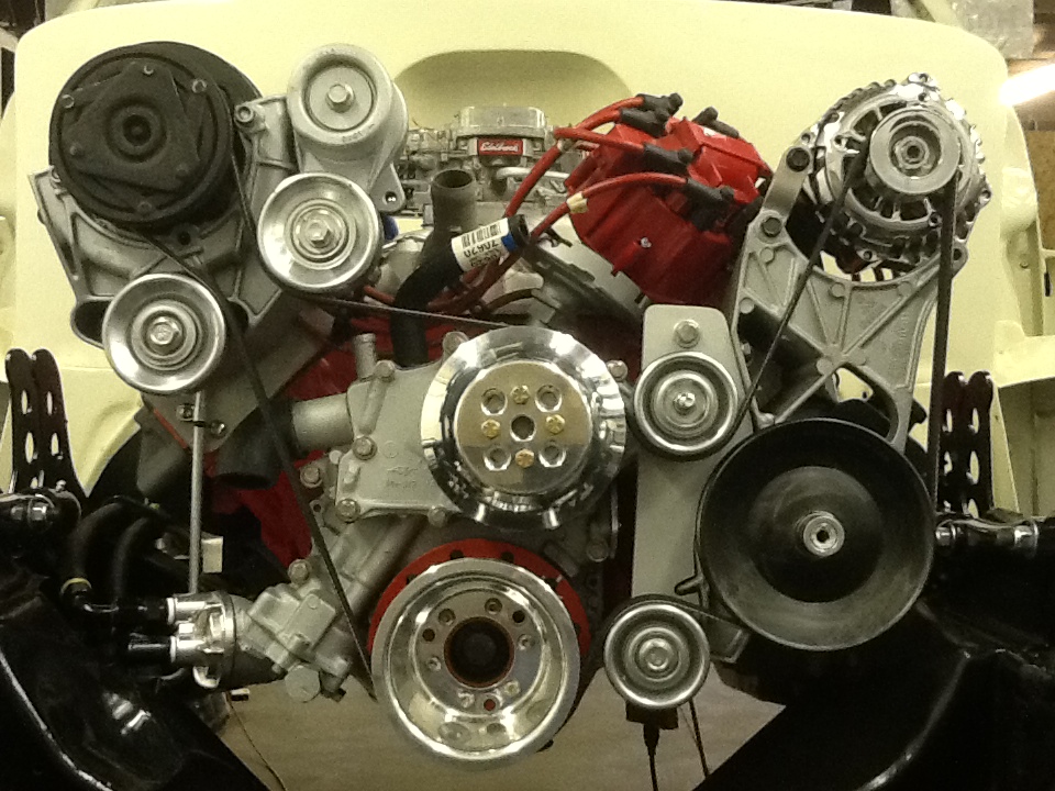

    Some new pictures of the engine "Serpentine" belt system. When I get the engine re-installed in the frame I will add more photos.

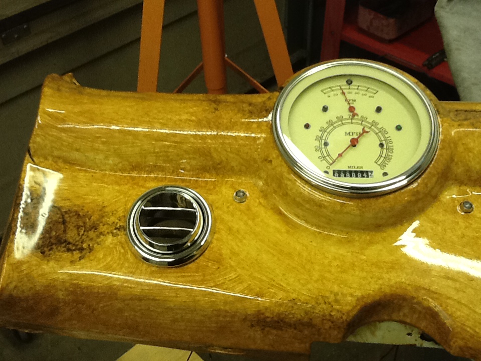

    Just finished doing the dash and front door panels.

    10 years, your just getting warmed up. I've had my 49 Sedanette since 93. Had all the body work finished in 2004. Other projects keep getting my attention diverted. Finally got back on it this year, but only while waiting on stuff for the 33 Dodge coupe build. Like you, I did get my 455 installed in the past month. Your conversion to a Serpentine belt was interesting. Any specific reason?
  17. Vinylman
    Joined: Jul 11, 2011
    Posts: 17
    Vinylman
    from N.E. Ohio
    I had seen this done about 10-12 years ago, and since there aren't any 455's running serpentine belt systems from the factory, I said "Why Not?". Plus it will cause people to take a closer look when I am at shows.
    It took a number of trial and error attempts, but with the help of Chevy Big Block crank pulley, and Ford [YUK] water pump pulley adapted to the power steering pump, it was a piece of cake!!
