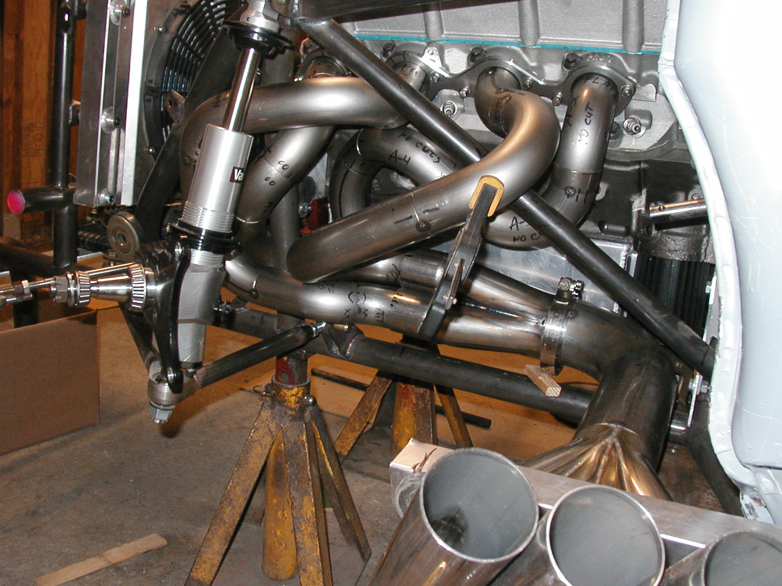

  3. If you know the Look you want, build your own. It's no big deal and you'll really enjoy doing it. The real bonus is they fit the way you want them to. It's a small learning curve as long as you can weld. You never get exactly what you want from out of the box headers.

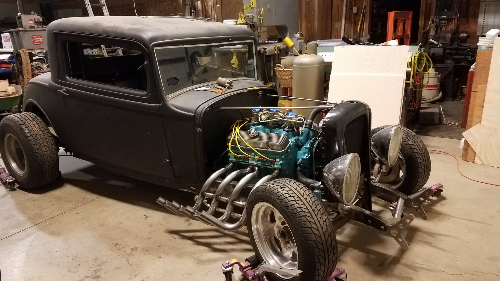

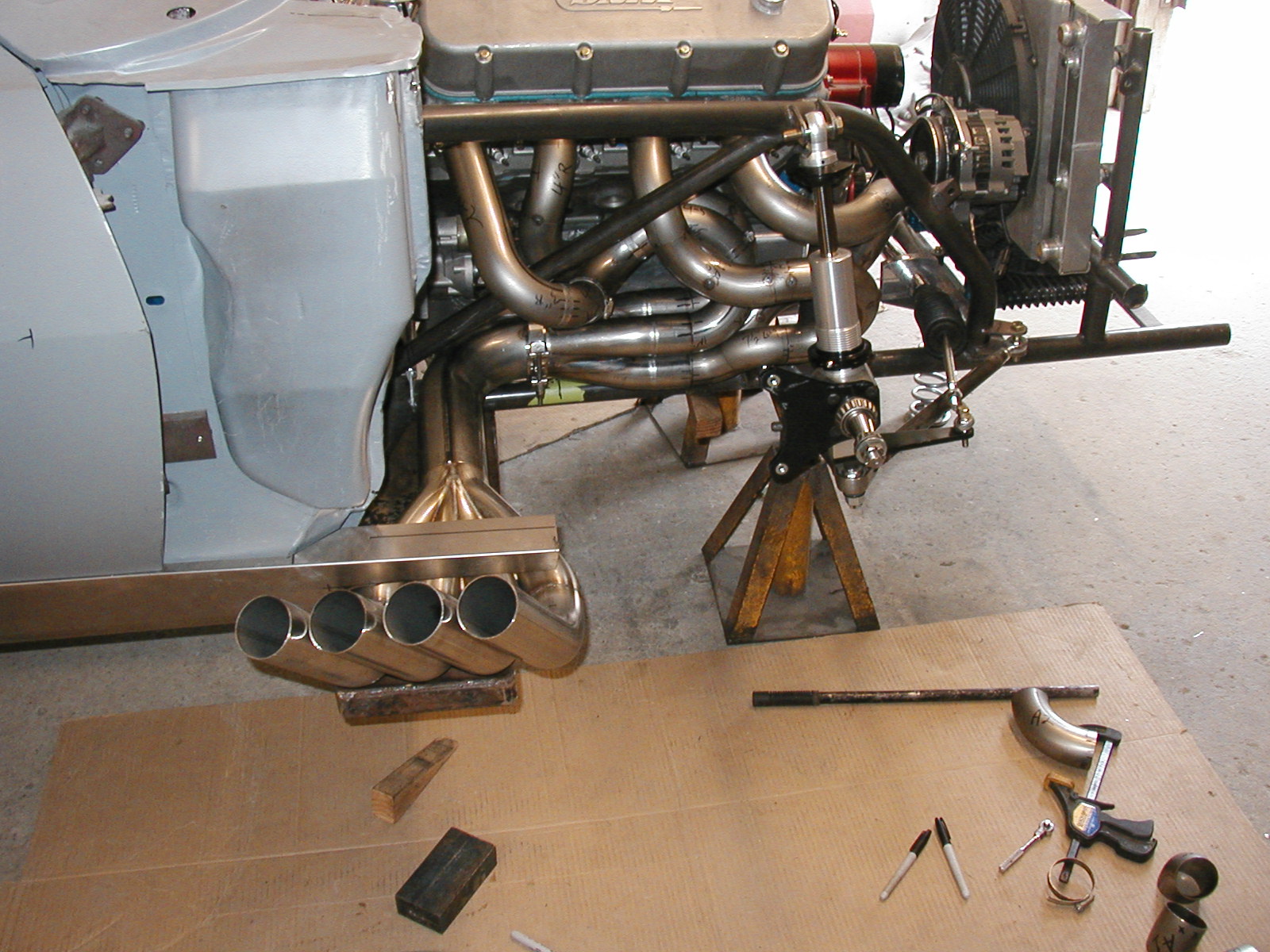

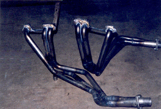

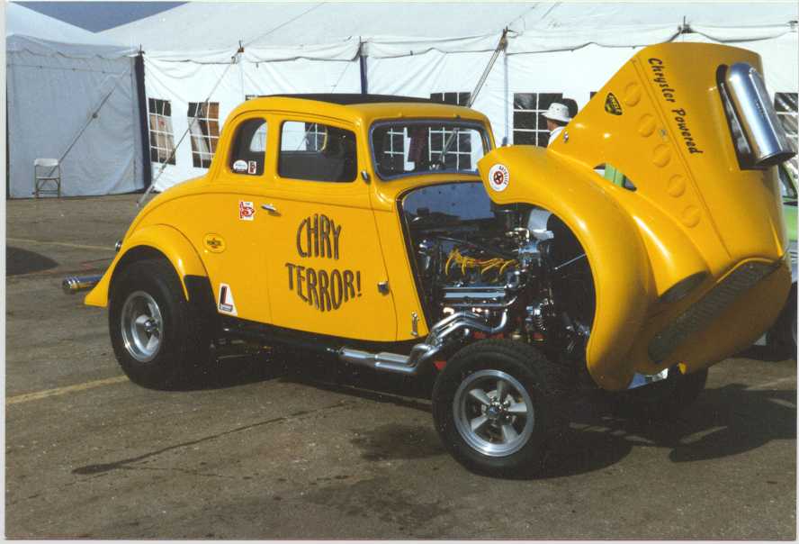

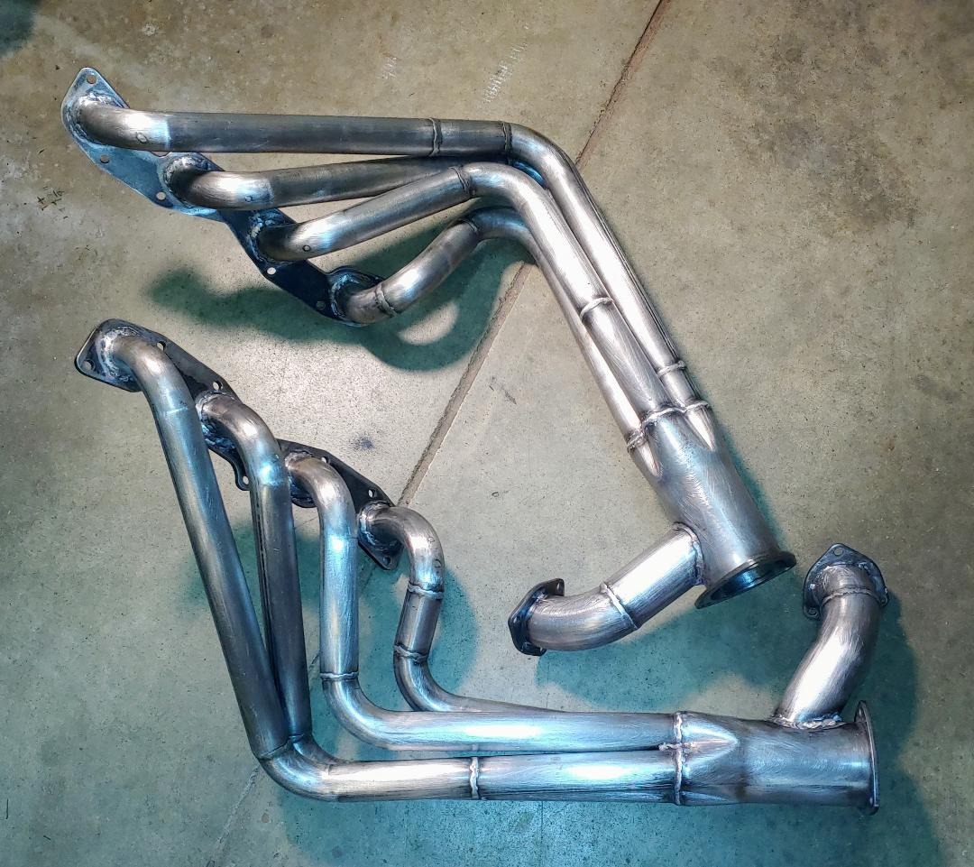

    Why not get adventurous and make a set?
    Jet96, bchctybob, 2Blue2 and 10 others like this.

    As you can see from all the above posted photos hand built makes your project personal not boring. There are a few things to know for a first time builder but if you ask I bet you'll get so much input you will just get to work on them. If you can see them in your Mind your hands can build them.
    Jet96, bchctybob, 2Blue2 and 9 others like this.

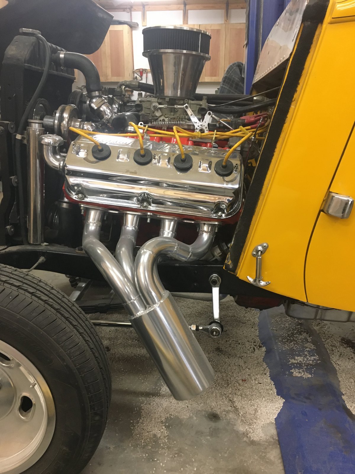

  11. coop46
    Joined: Sep 5, 2010
    Posts: 126
    coop46
    from New Jersey
    Thank you Wizzard....I love that set with the zoomies. That's what I'd like....lots of curves.

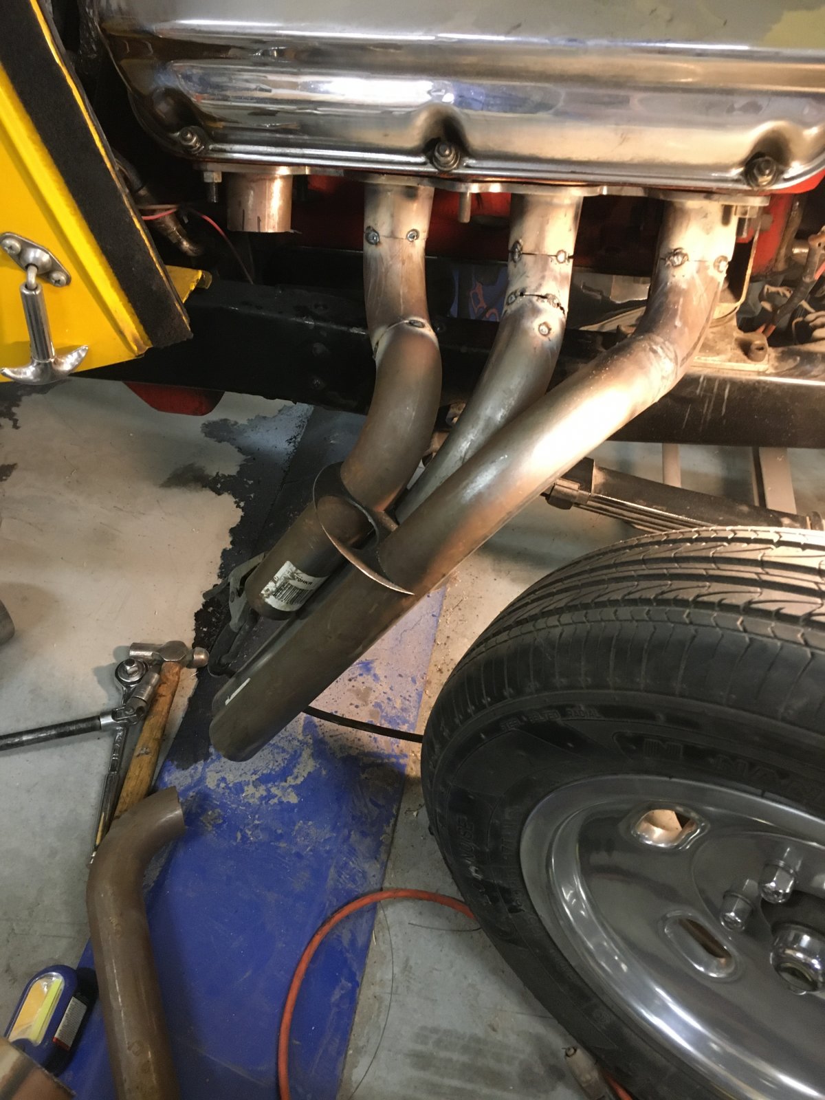

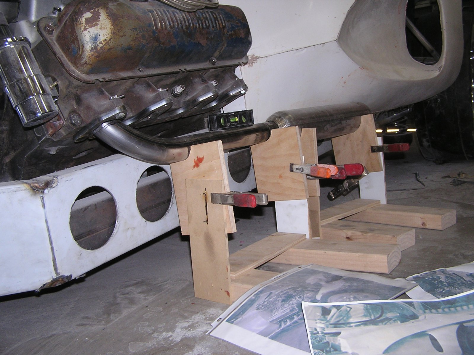

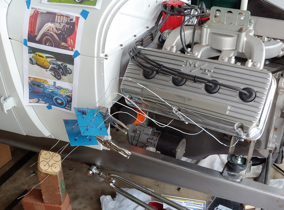

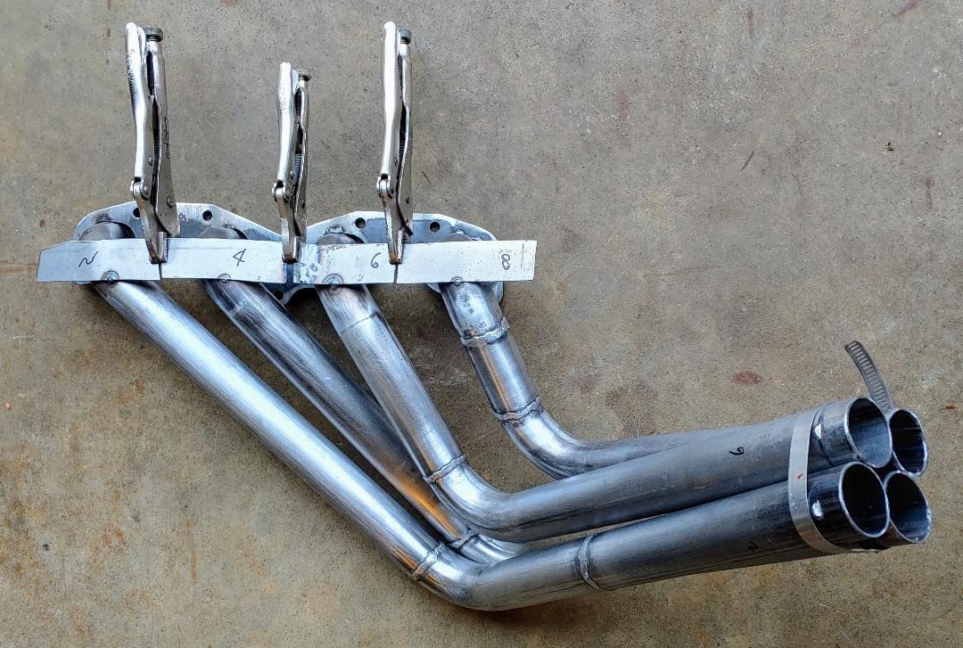

    Get some 3' pieces of 1/8" steel welding rod. Get the proper 3/8" flanges (not 5/16"), get about 10 180 degree mandrel bends. I like mostly 3" radius bends but might get an ***ortment of 2" & 3". Might need a straight stick too. as I recall 331 flanges use 1.5" tubing. Finally you need a collector tube. On my 331 I used a 3-bolt muffler flange.
    I make a wood cradle to hold the collector in position, bolt the flanges in position then bend the wire in the shape for a tube. Go to my Harbor Freight band saw and cut the shapes I need to tack it all together. I am sure there must be a bunch of how-to videos on YouTube leading you thru the process. And it is fun.
    Finally get them Jet Hot coated. Don't fool with trying to paint them or building stainless steel ones. Jet Hot is bullet proof, needs zero maintenance and last forever. Or at least 'til they haul you off to Trembling Hills and who cares after that!!
    Don't have how-to pictures but here are a few in progress shots.

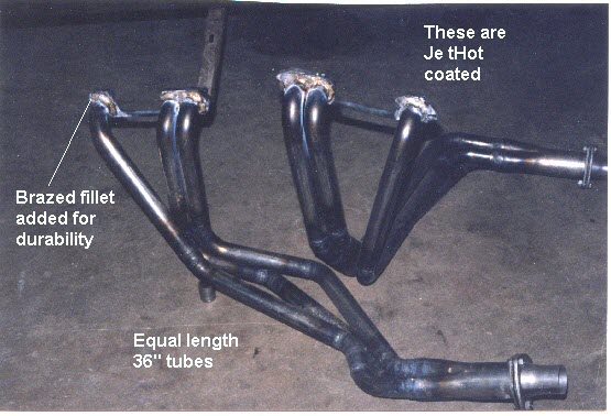

    Didn't mention that I like to gas weld my headers. Cleaner and more control, prettier weld than a wire feed. Unless you are a TIG master which means you are way past me! I MIG weld the tubes to the inside of the flange. Also like to gas braze a fillet on the outside of the flange/tube joint for more strength.
    This video is an ok description of the process.

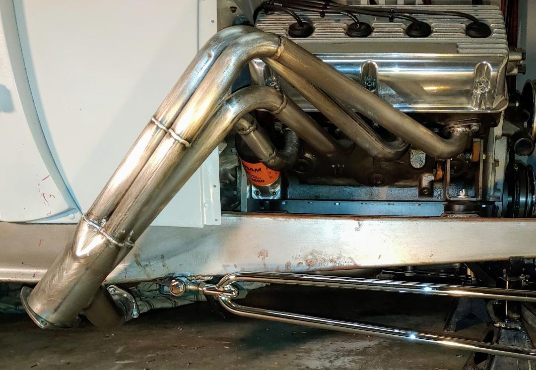

    Willys....just getting back around to this. dealing with covid.... thank you for the video. I bought a patriot BBC kit and am going to give it a whirl. No tig master here, but my son is so I may tac em and have him finish them. Thanks again

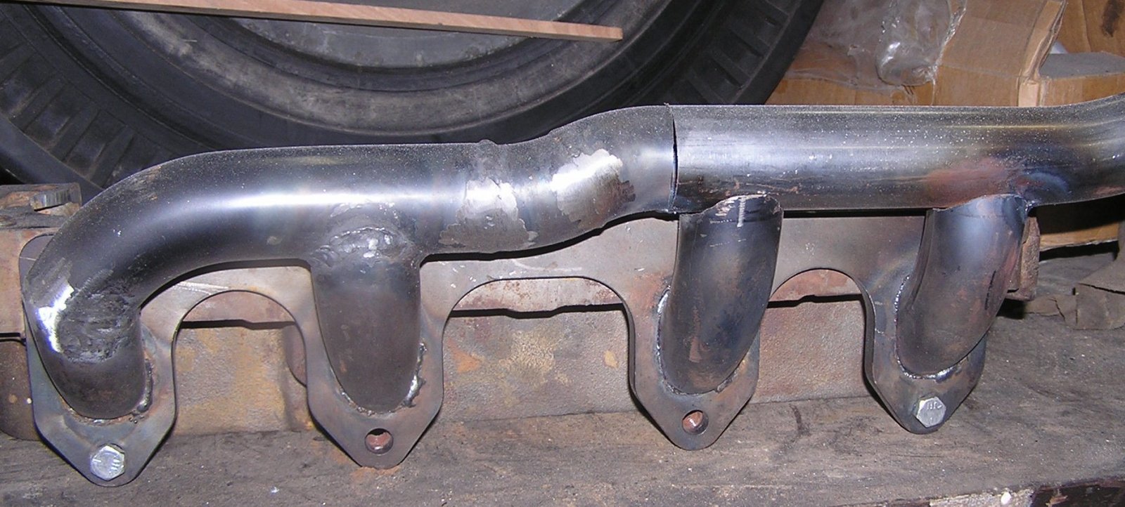

  28. I just realized that above photo is before I welded the tubes to the flange. (hadn't had enough coffee yet) The tubes are not welded up yet so would not be fully welded to the flange. Here's a different set of headers showing inside weld and no exterior weld. Rectangle ports mean making the round pipe fit.
    Just Gary, Jet96, bchctybob and 5 others like this.

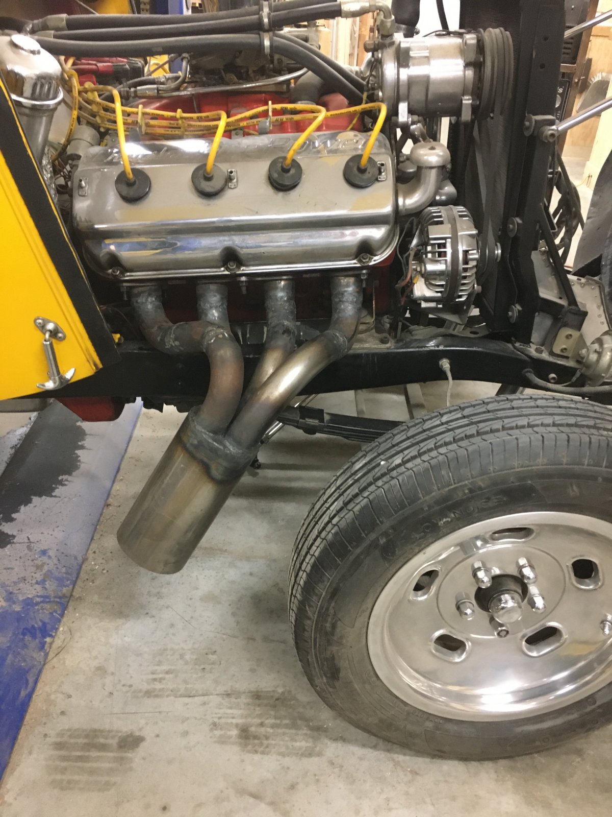

  29. coop46
    Joined: Sep 5, 2010
    Posts: 126
    coop46
    from New Jersey
    So you guys talked me into building my own....glad you did. This started out as a BBC kit which I cut up to fit my hemi. One side all fit up and tacked. The square flange you see before the collector will be removed before the collector is welded on. It's just a place keeper for the 4 tubes.
    Jet96, bchctybob, rod1 and 9 others like this.
