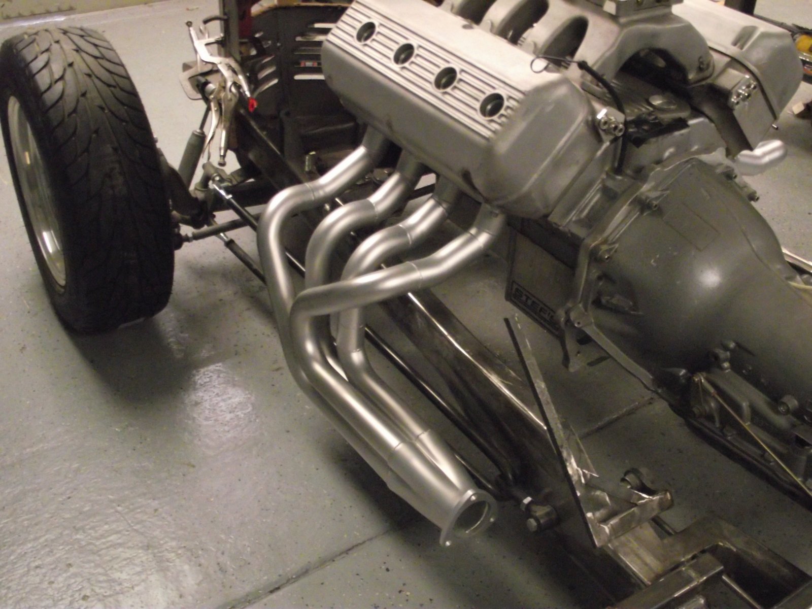

  17. coop46
    Joined: Sep 5, 2010
    Posts: 125
    coop46
    from New Jersey
    My headers are done and ceramic coated.....glad I built my own. Came out just like I wanted. Thanks to the guys who nudged me to build my own.

  23. caprockfabshop
    Joined: Dec 5, 2019
    Posts: 696
    caprockfabshop
    Those look fantastic! Way better than what you'd get outa the box!

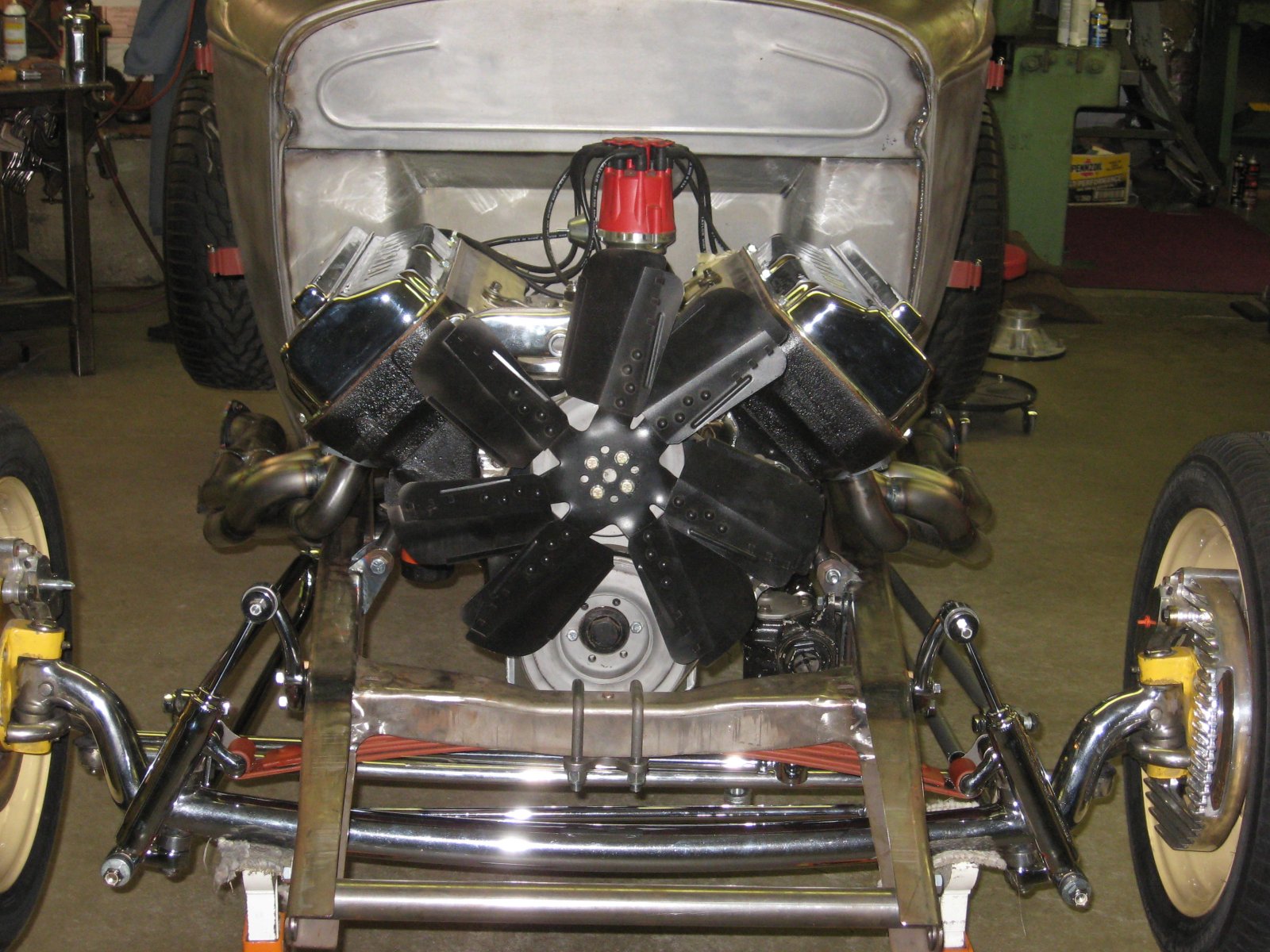

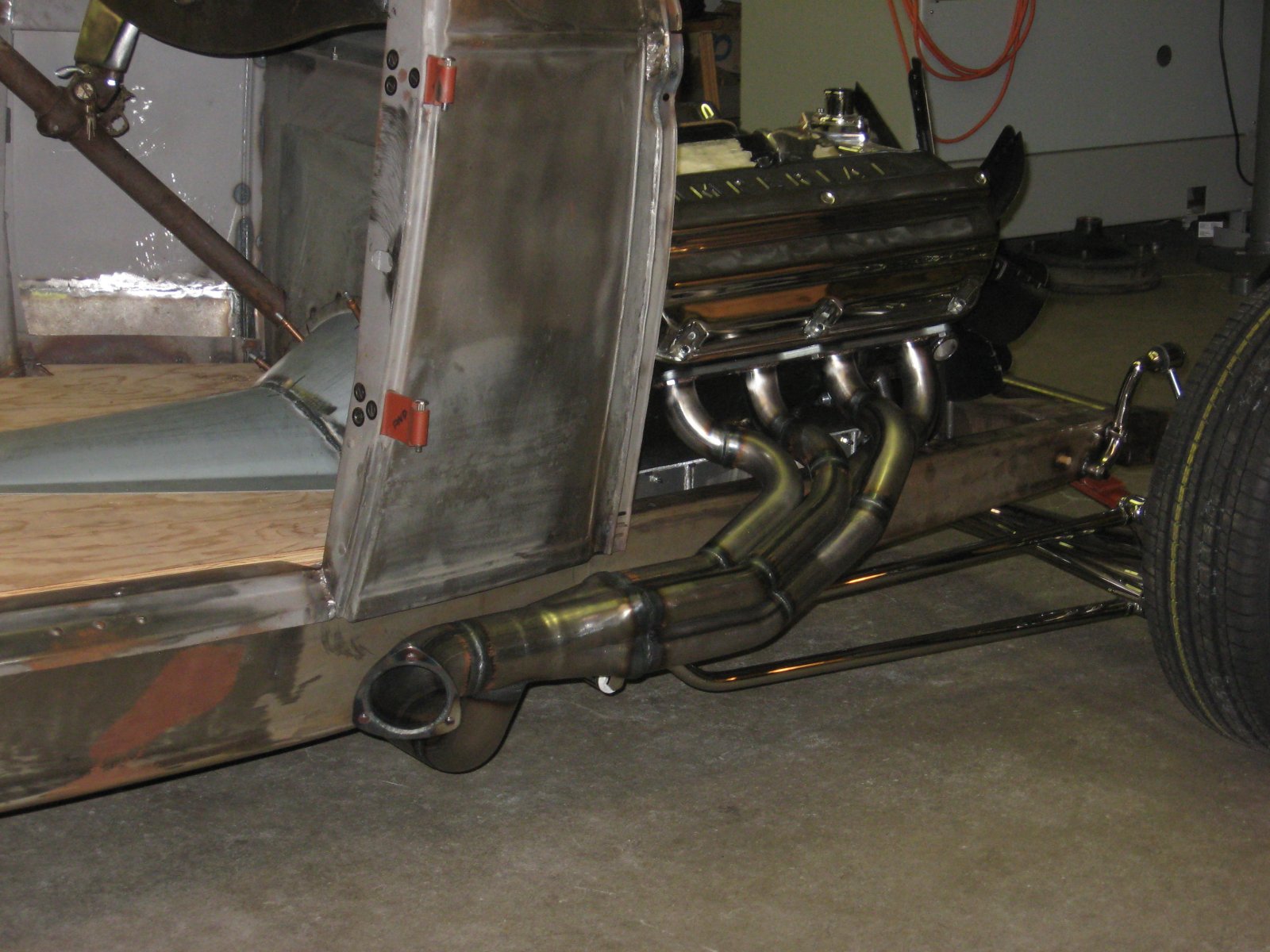

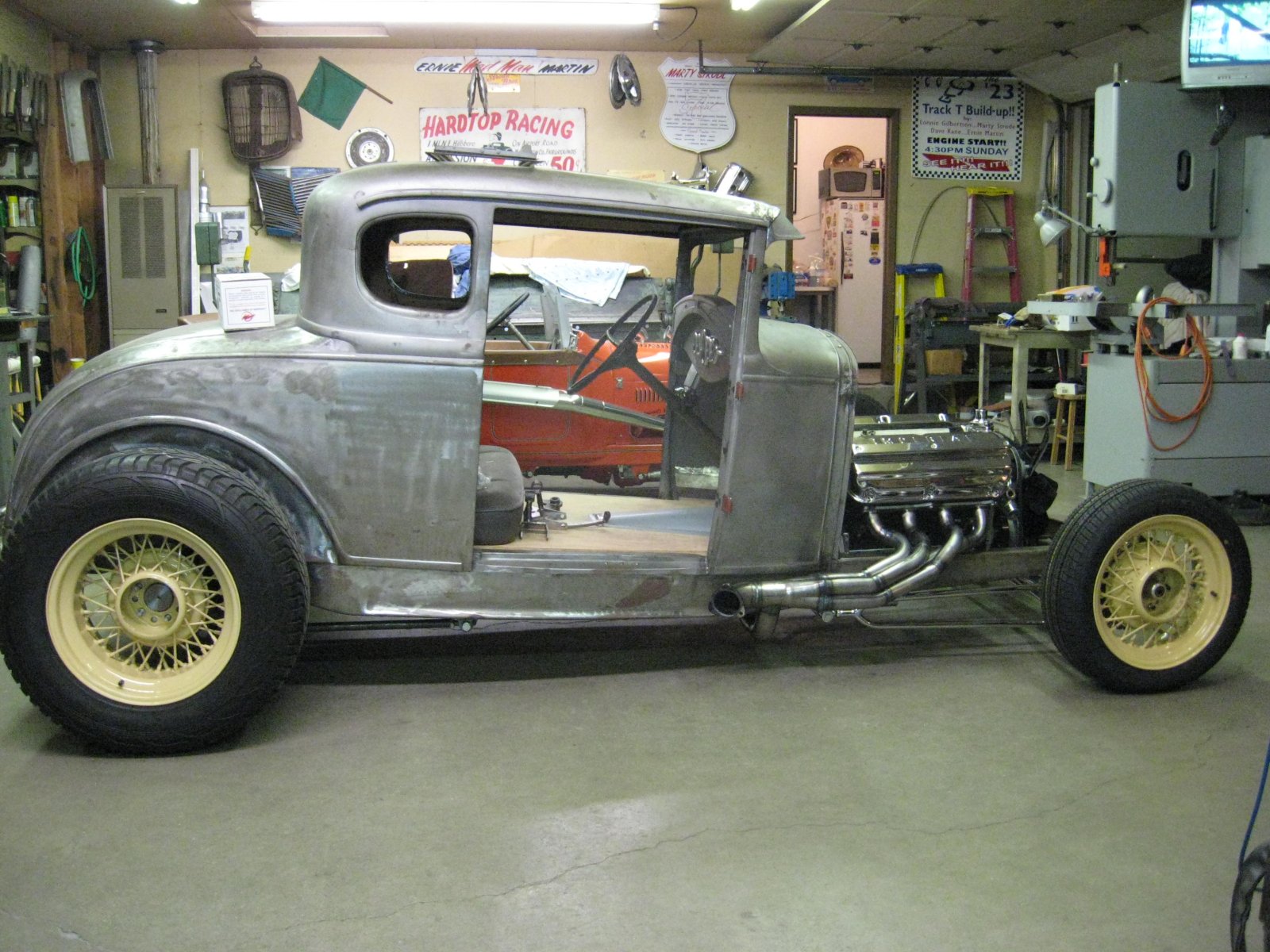

  25. Marty Strode
    Joined: Apr 28, 2011
    Posts: 9,685
    Marty Strode

  28. Plain and simple, Marty's an artist!
  29. Marty Strode
    Posts: 9,685
    Marty Strode
    Nah, it's just metal fab. Do you know what happened to Buzz's Model A ?
  30. Are you talking about the Chopped Coupe with the Hemi?
