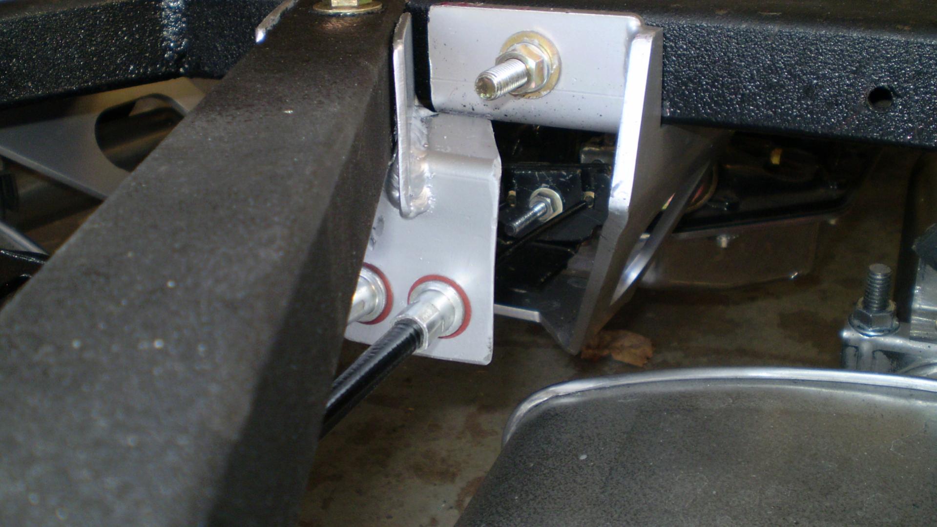

    this is what I'm trying to "Fab-up" using parts from Lokar, a 1973 Ford Explorer 1/2 ton pickup bracket and the original e-brake handle and cable in my 48 Plymouth sedan. The rearend is an 8.75 from a B-body 66 mopar, with 9" drum brakes. C***, alias littlemo...
