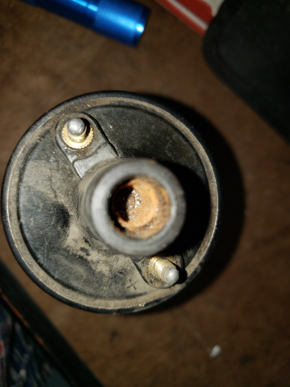

  20. Thunder Road
    Joined: Sep 17, 2006
    Posts: 186
    Thunder Road
    7.29.2023 Update.
    Ok, so I changed out the coil and the condenser. I know these units are good.
    Engine starts just fine and idles good.
    I drove it out onto the road and at low rpm it is nice and smooth. As engine rpm increases, the random misses showed up…much more concentrated than the other day. It was really bad…but it would smooth out some also….
    So, with thanks to you folks, I have decided to go ahead and bite the bullet and pull the grille and radiator off; get new wires, new plugs, and new dist cap, a new rotor and change all of this out. I will freshen up the point contacts and reset them to .016.
    The only thing that makes this an easier decision is that I have found a coolant trail down the outside front of the radiator, so she is in need of repair and I can get that done at the same time.
    Thank you all for your thoughts – they are appreciated…when I get the work done, I will return with another update. I have a special event in mid-September that is a 100 mile poker run for Habitat for Humanity and I want to take the coupe on it…that’s my goal.
