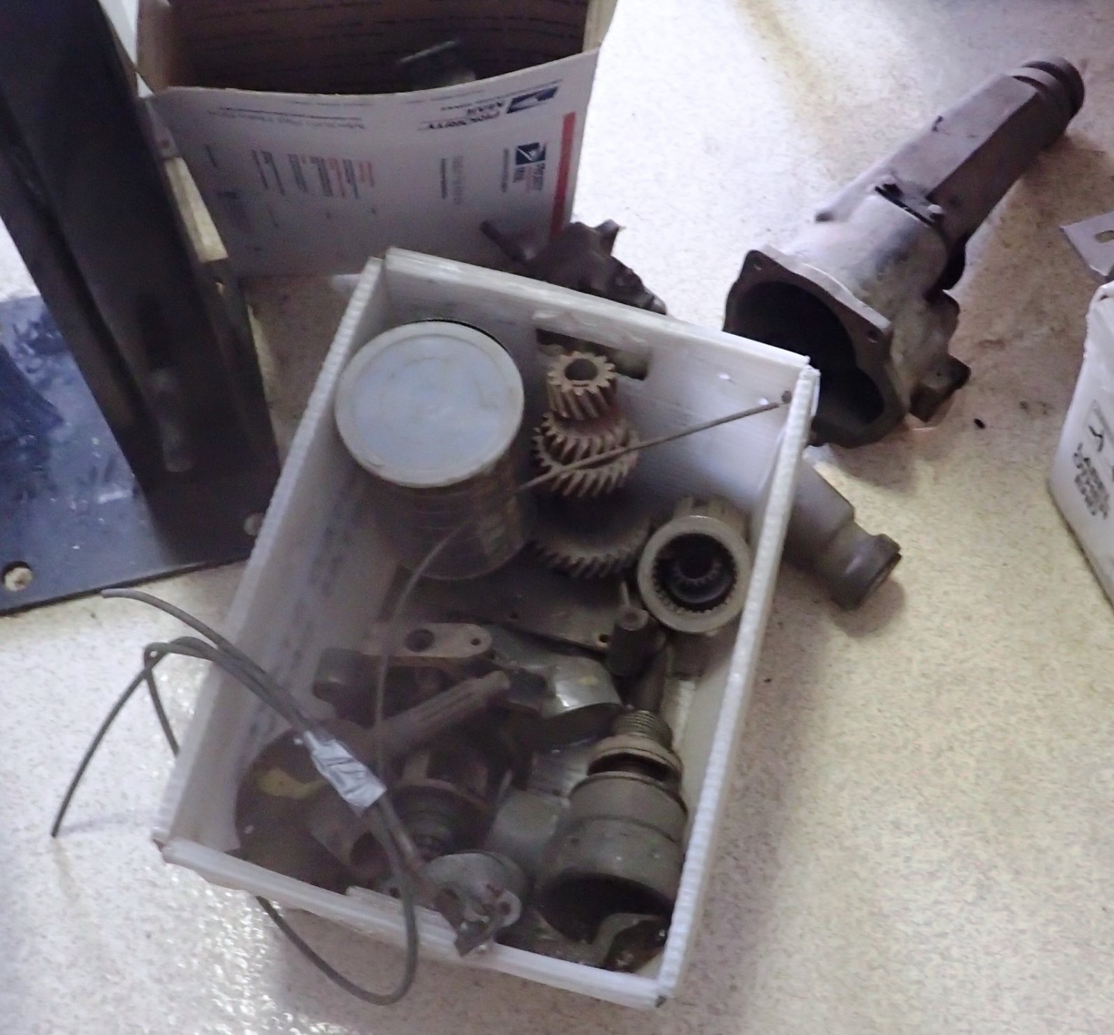

    Anything in here interest you, input shaft-wise? This is Simi Valley, PM me if interested.
