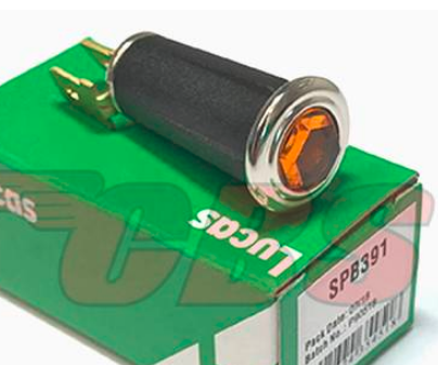

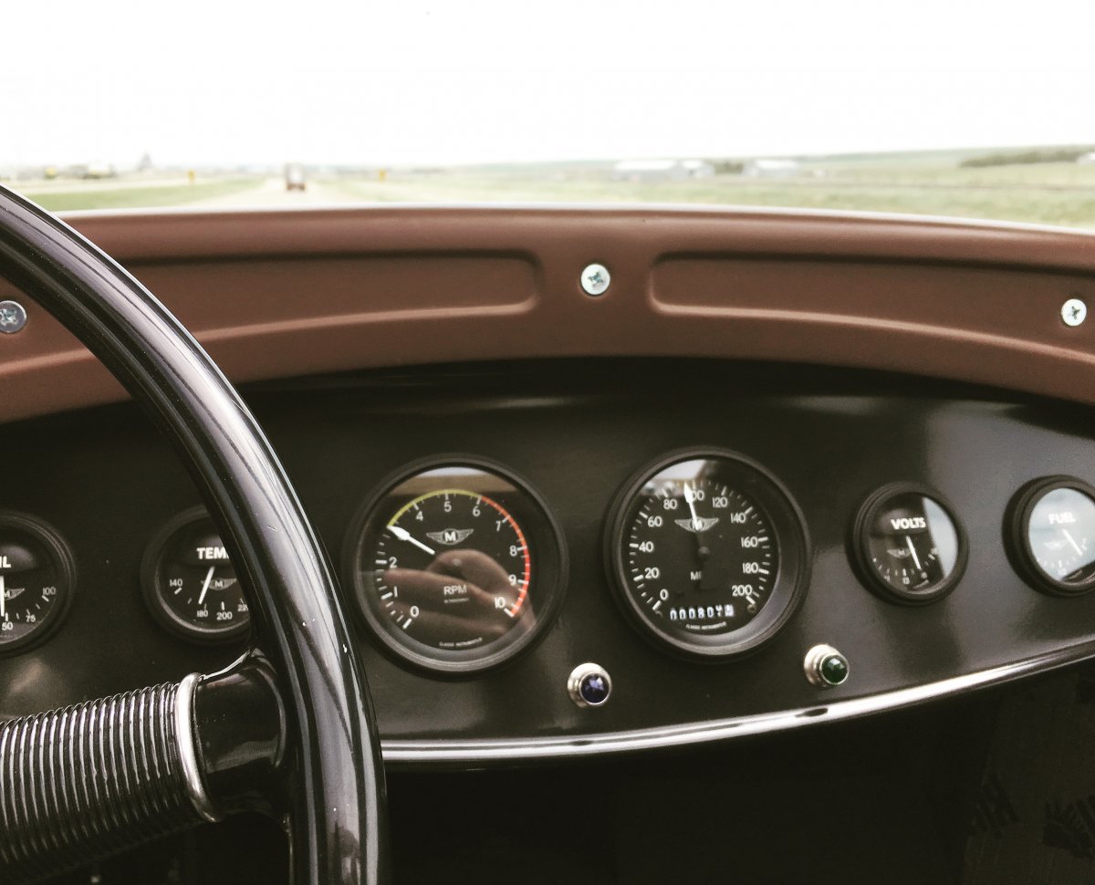

    Nice vintage look with a jewelled lens and available in various colours. Used on vintage English motorcycles and cars. Bulb is totally enclosed so doesn't throw light behind dash. Works good day or night.
    Available from parts suppliers for vintage motorcycles.
    My Model A dash - - [​IMG]
