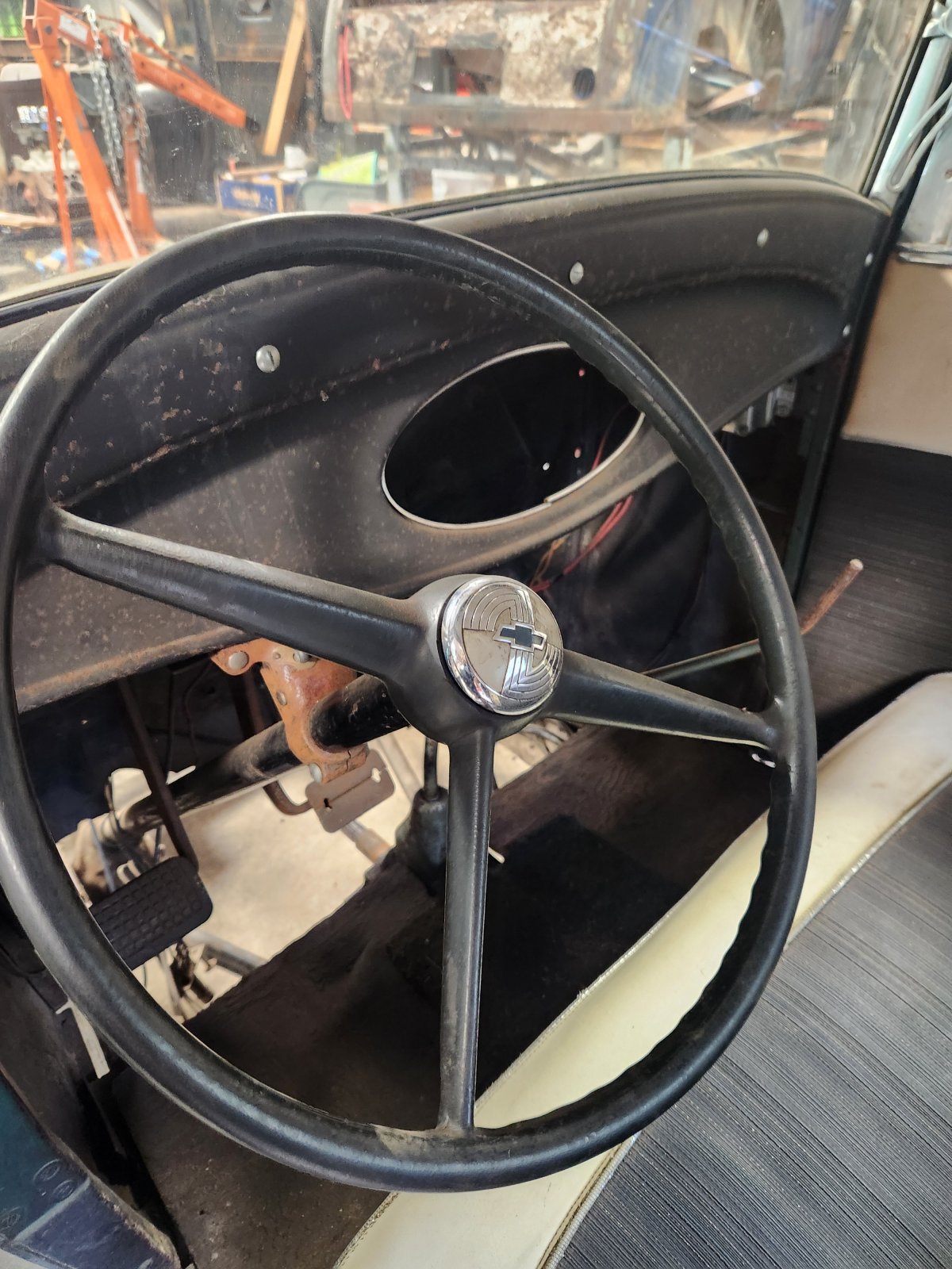

    It has a nicely dropped 32 heavy axle, 15 inch Lincoln wheels, dropped headlight bar, juice brakes. F100 steering, and a 37 packard trans, modified for closed drive using the stock 32 trans mount. Modifications to the k member are very well done.
    It has hanging pedals AND a no longer used 40 ford m/c under the floor.(which makes me think it was previously a flathead powered hot rod)
    The interior is nicely finished, it has chrome garnish moldings. And originally the paint was cherry or emerald green.

    Hey Matt, that is a really cool curved Z pattern in the bow tie horn button button, I have never seen one like that.
