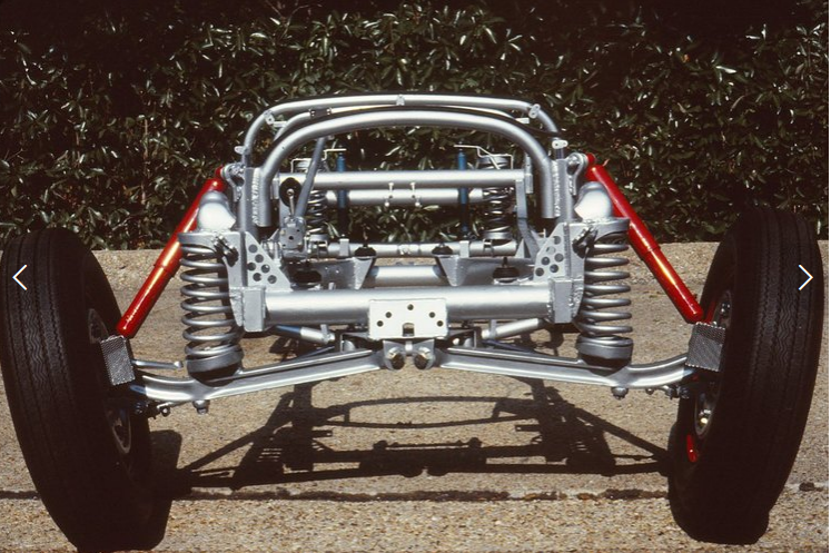

    Here's a modern version, from the article. Note the whole axle, uncut, and the pivots for the spring bars, in the crossmember. On the OP's setup, there are conventional coils, and the spring bars are bolted to the crossmember, at the original spring mount:

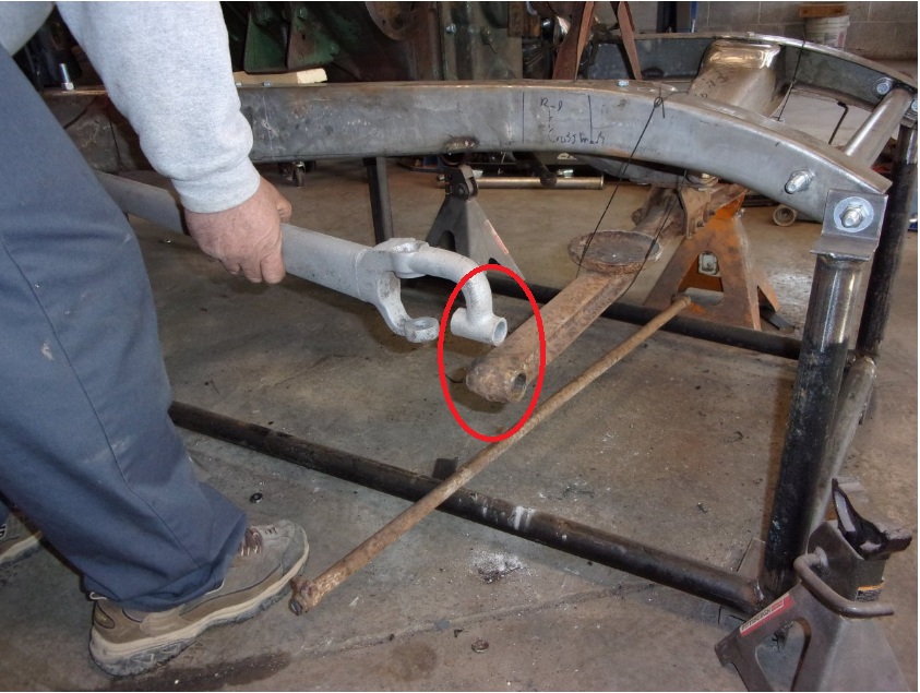

    The "swing arms" low coil mounts simply replace the buggy spring.
    The arm bolt to the stock 40 Ford crossmember see above then attach to the stock Ford wishbone using stock shackles.
    The axle is still held in place by the wishbones.
    This is a stock 40 front end set up.
    The red lines represent which the "swing arms" bolt to the stock crossmember using the four U-bolt holes and using leaf spring shackles mount to the 40 wishbones in place of the stock spring.

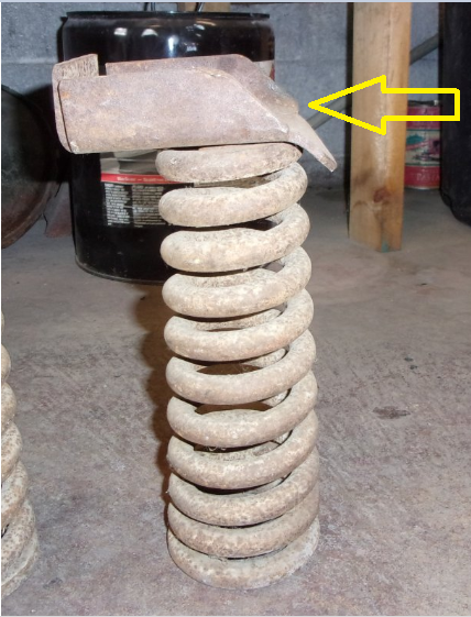

    The Yellow lines represent the coil springs that fit inside the front crossmember.
    Note the coils mount more to the outside of the crossmember about under the engine mount
    The yellow arrow points to the bracket that fits inside the crossmember and bolts to the frame.

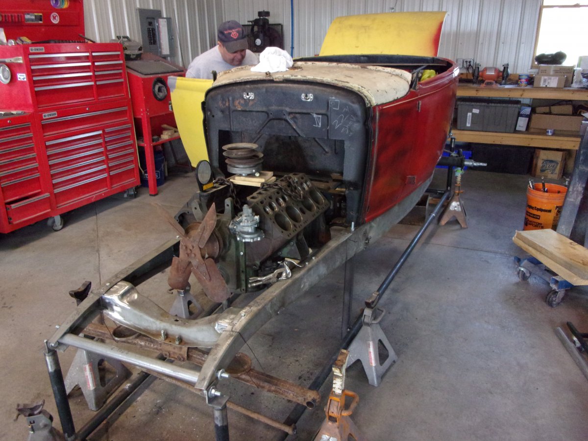

  26. @gimpyshotrods is correct the wishbones do not need to be split.
    Tim did need to split the bones for this project because of the engine transmission choice.
    347 Flathead Cadillac and a Cad/LaSalle transmission. I am really shocked no one noticed that!

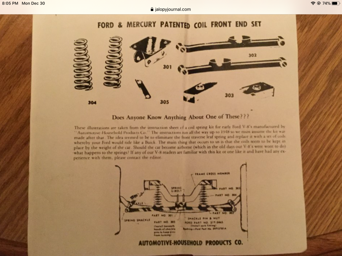

  27. 5AB52A0B-5FBE-4F06-B22B-2530A03DEEA6.png This is all the info that I have on it.

  29. And the H.A.M.B. comes thought again!
    Anyone know how long they were produced?
