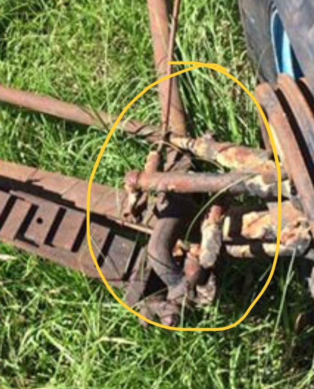

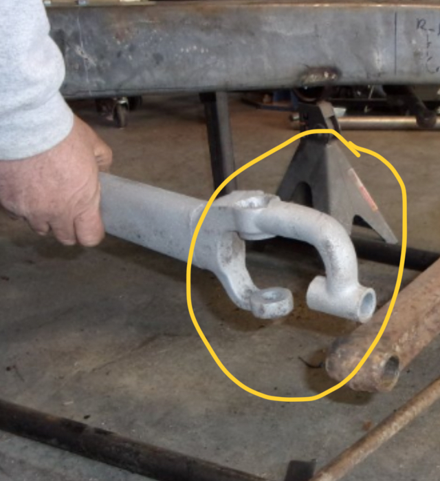

    There is still just one single axle, just the same as the stock setup. This setup does nothing whatsoever to the axle of the vehicle. What you are seeing in the OP's pictures are spring support bars, not an axle. The axle is not pictured in any of his pictures.
    This setup replaces the leaf spring with a pair of coil springs. That is all.

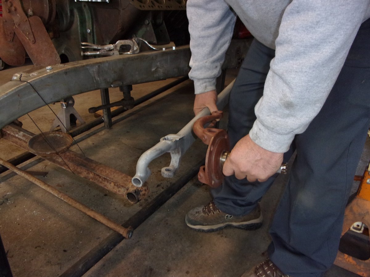

  12. 6CB04DCD-3204-41D8-9BD0-F0D117CCC22A.jpeg 66ADA630-567C-4989-B6A0-410087FBC49E.jpeg
    That heavy wishbone looks like the ones on 30s Ford 1.5 ton trucks.

  14. One more time .
    It uses a stock axle since the kit only replaces the transverse spring. So all caster and camber characteristics of the stock axle remain.
    Seems like A LOT of problem causing solutions to non problematic issues. The cure is worse than the disease. Like increasing the unsprung weight. Adding more parts to simple set up.
  15. Tim is going to have springs made (AFCO)
    He found this set up and really wants to run it.
    He has a couple hot rod builds under his belt, several Harley-Davidson and Indian restorations.
    He really want to find it's full history.

    most posters are not getting that the 2 beams are NOT the axle!!!!If you could post a photo with the axle in place ,it would clear up the confusion.[took me a while to realize it too]
