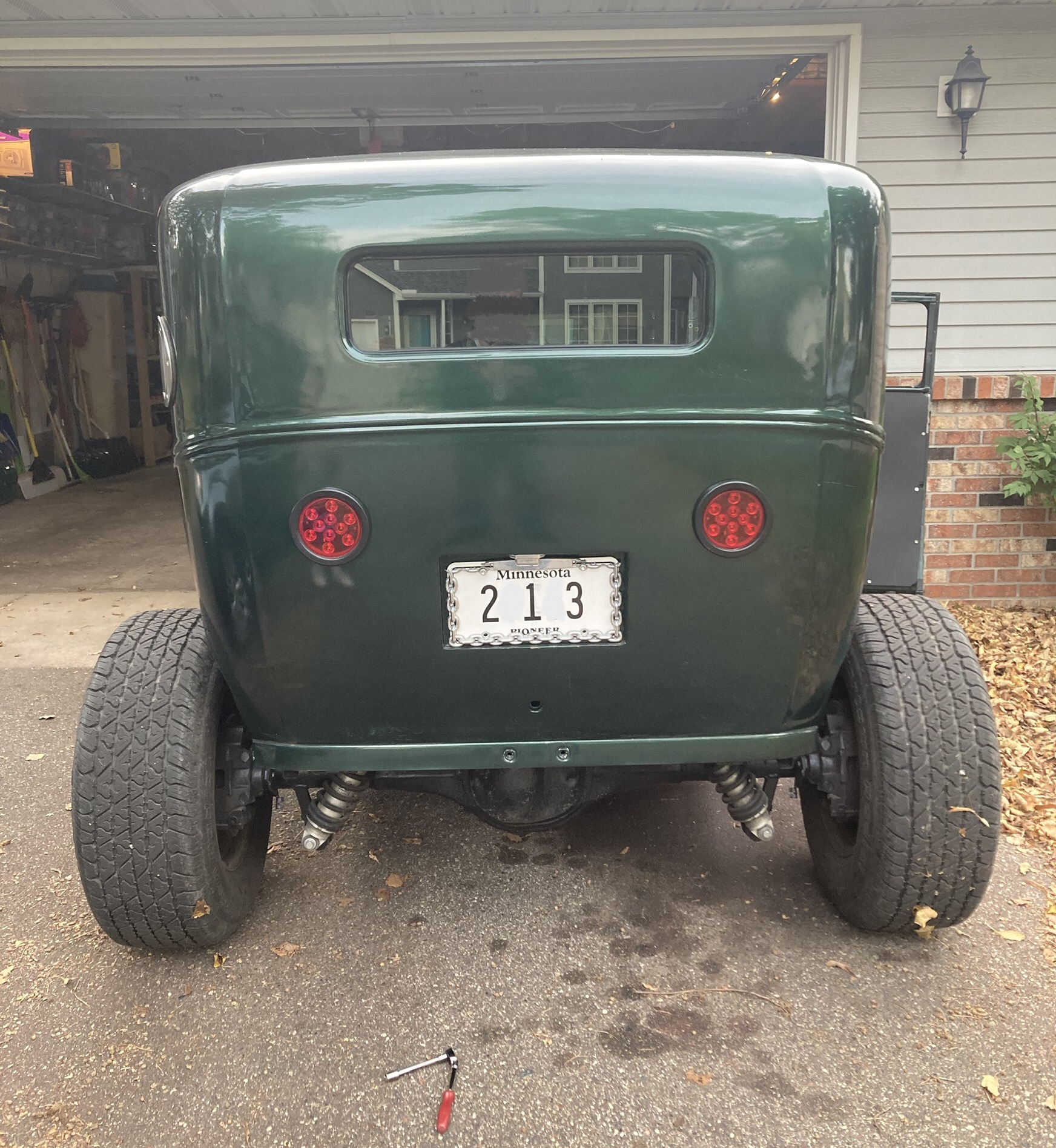

    I recently bought this Model A sedan. One thing I’m dying to change are these awful LED trailer lights someone put in. Unfortunately the taillight installation required a pair of 4” holes to be cut in the back of the body. Ideally I would have maybe wanted to install ‘50 Pontiac lights but the holes are too big. I don’t really want to turn this into a big paint and body project right now so it I’m hoping someone might have some ideas for possible taillights I could use that could maybe work with the existing holes in the body. Thanks in advance for any thoughts.
    I’ve already ditched the chain link license frame. :D

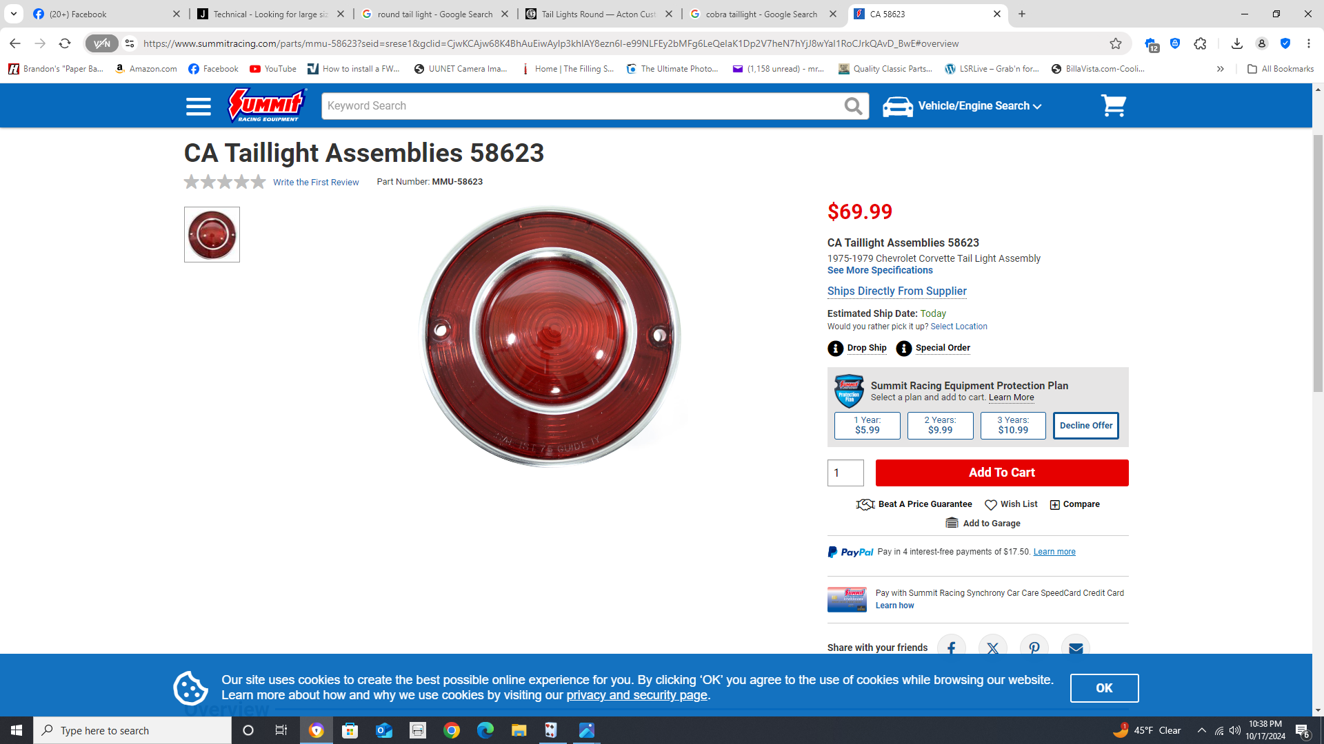

    These repro 50 Pontiac tail lights are 4-1/4 diameter. That might cover the flange on those lights depending on how those are fastened in if they cover the hole you could use some panel bond to stick a piece in the back to fasten them to.

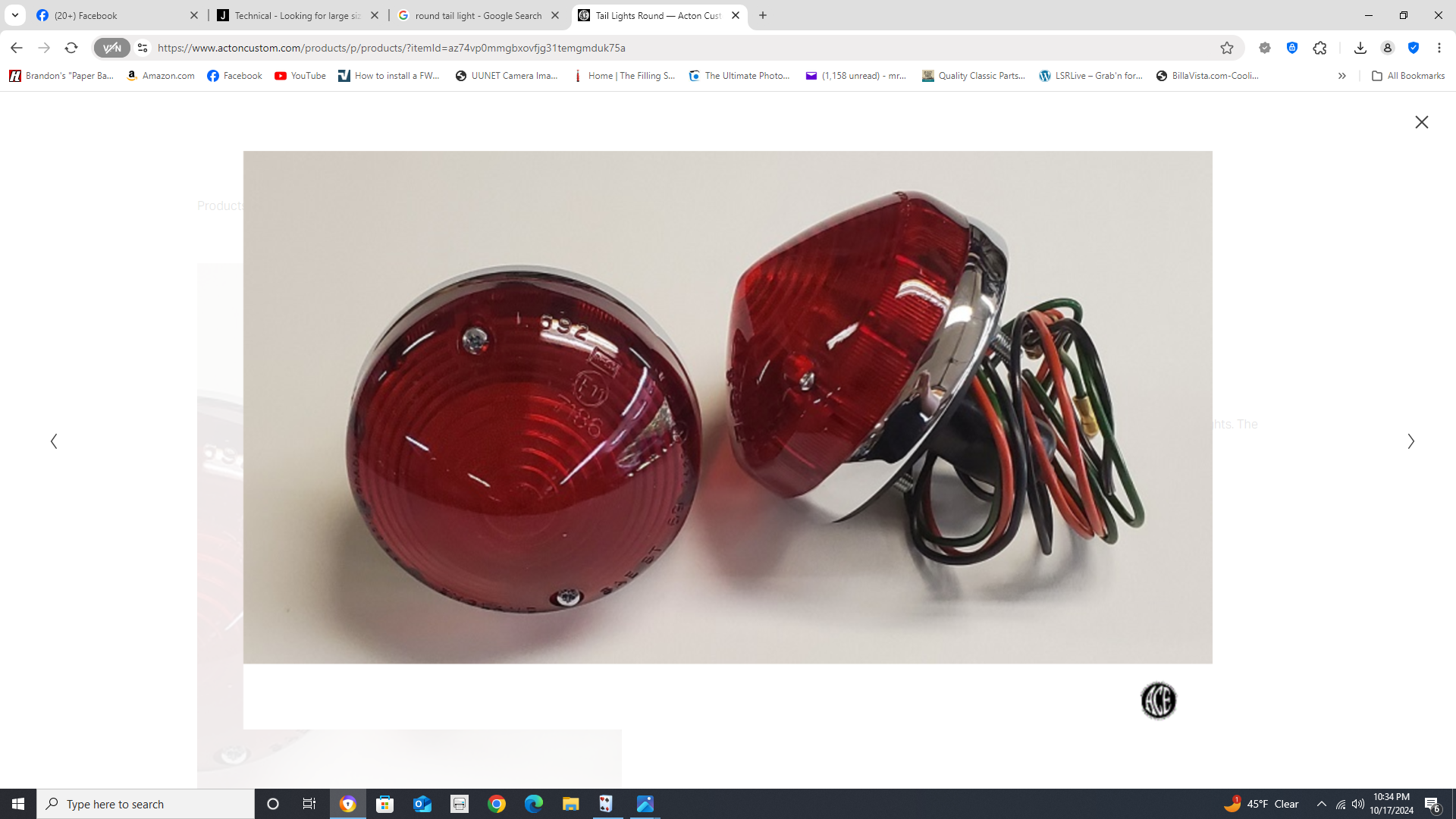

    The third down that I don't know what diameter they are are made for Cobra kit cars and might fit in the buckets for those lights. https://www.actoncustom.com/products/p/products/?itemId=az74vp0mmgbxovfjg31temgmduk75a
    Fourth down is 74 Corvette and for that you would have to find one and pull out the tape measure. that is the whole light but they sell the lenses pretty inexpensive on Ebay. Not a bad looking light either and on anything except a Corvette they probably loose the era they come from real quick. That has me thinking on my 48. Screenshot (1337).png Screenshot (1338).png Screenshot (1339).png Screenshot (1340).png Screenshot (1342).png

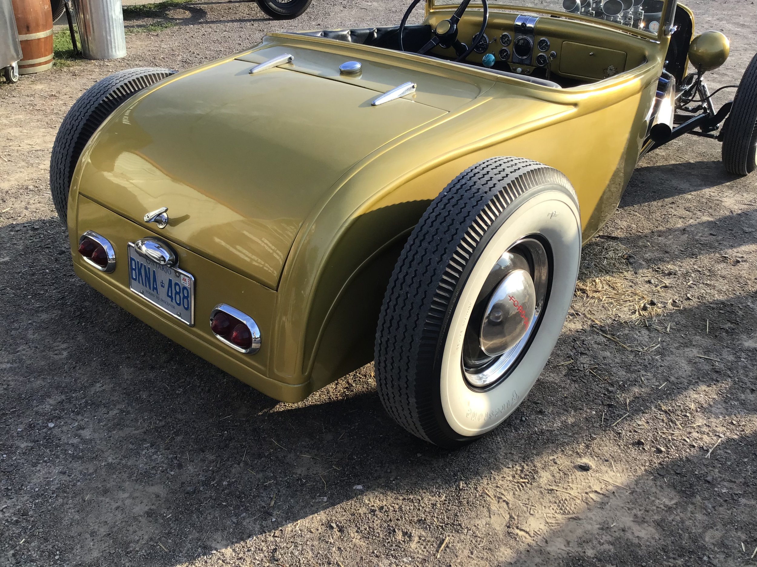

    Same style "4 inch trailer" but much earlier non-led version. Made a custom aluminium bezel. They are a standard size so should fit right in without any mods and give a frenched in look as ther are recessed as stock.
