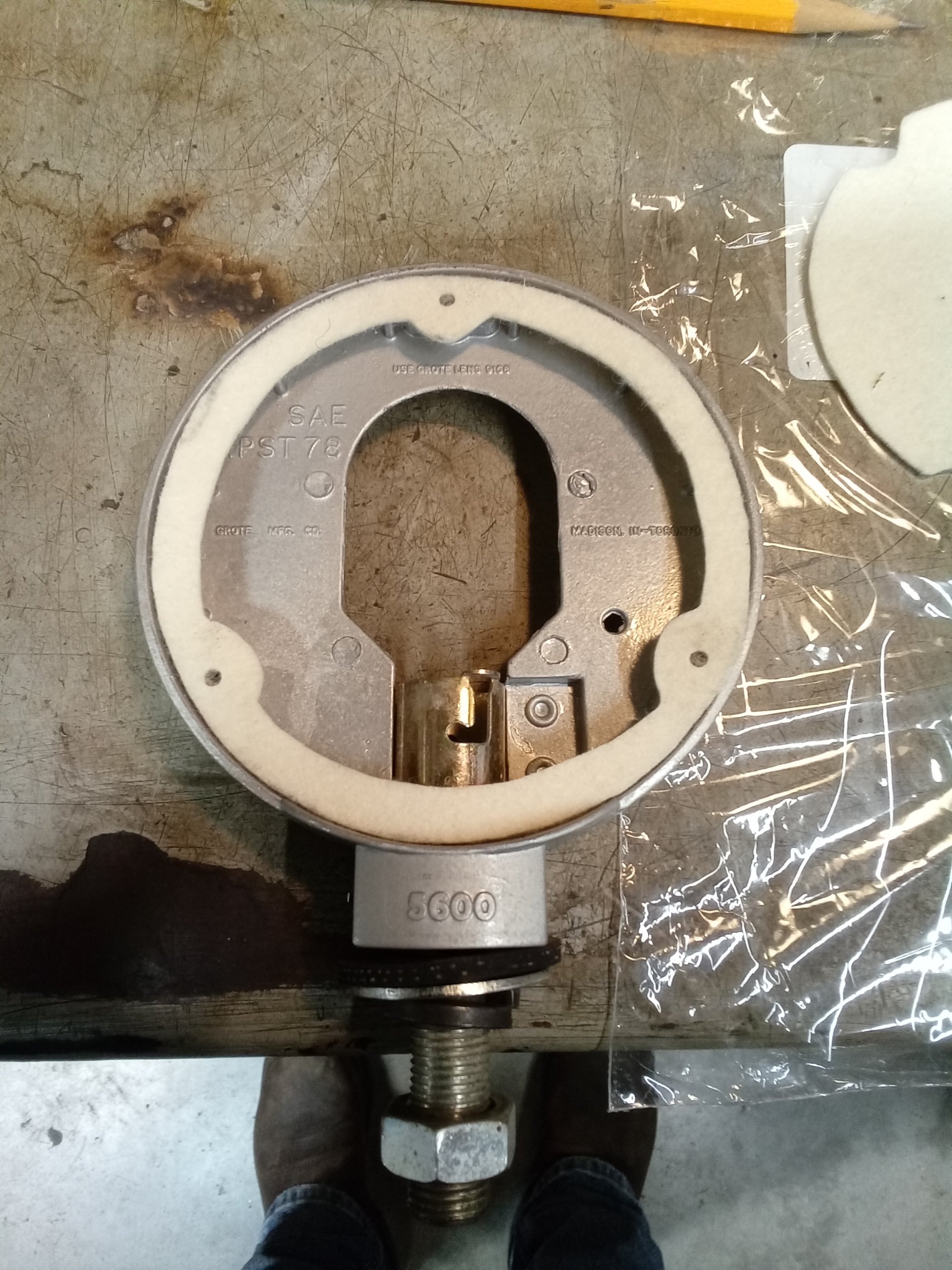

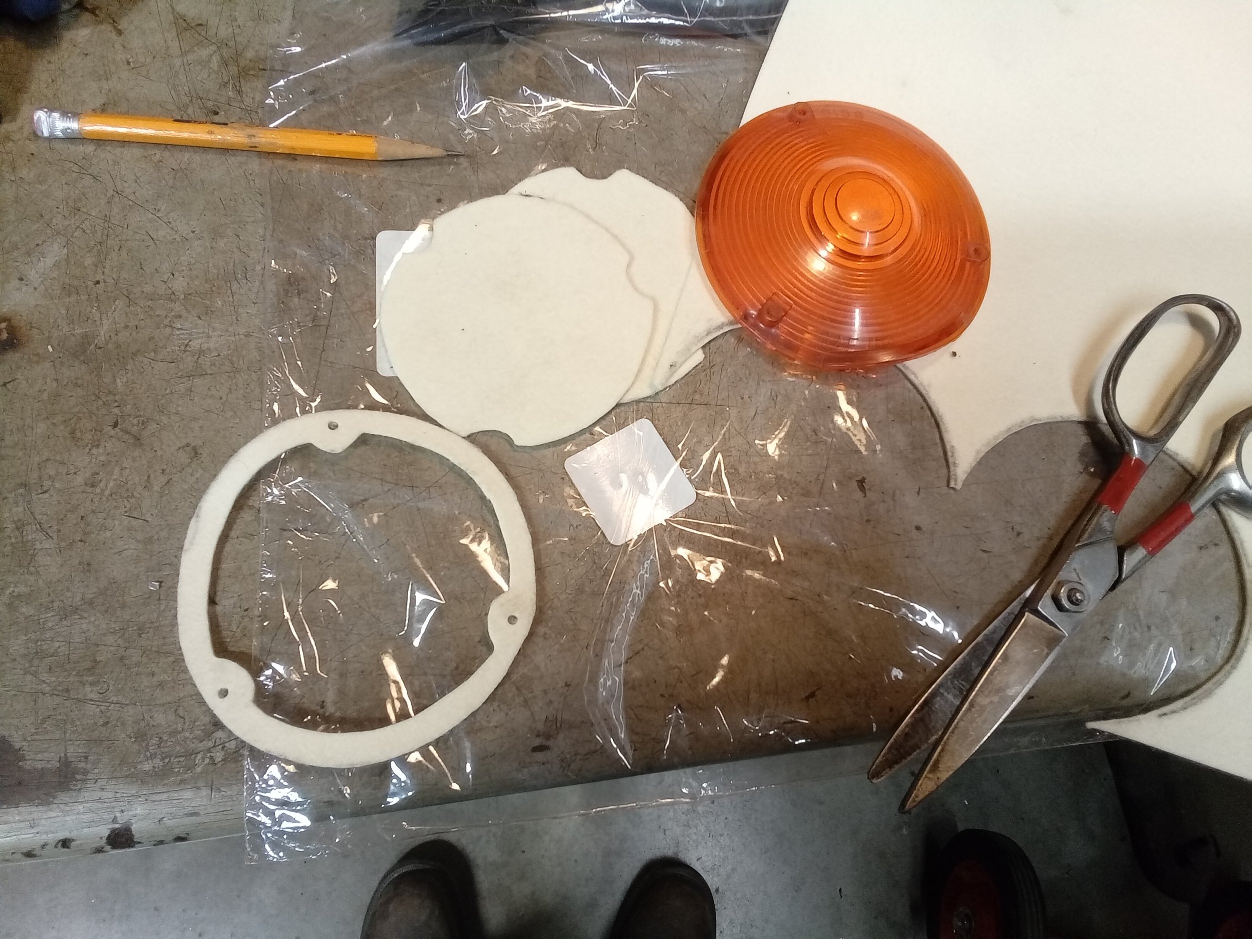

    Well, still no luck finding gaskets, so I got some material and cut some out. I used 1/16" felt (from McMaster Carr) as the old gaskets seemed to be more fiber than paper. The way the lens fit into the frame they're not directly exposed to the elements.
    I used one of the lens to trace the diameter and mark the holes and cut them out with a good pair of scissors and a leather hole punch.

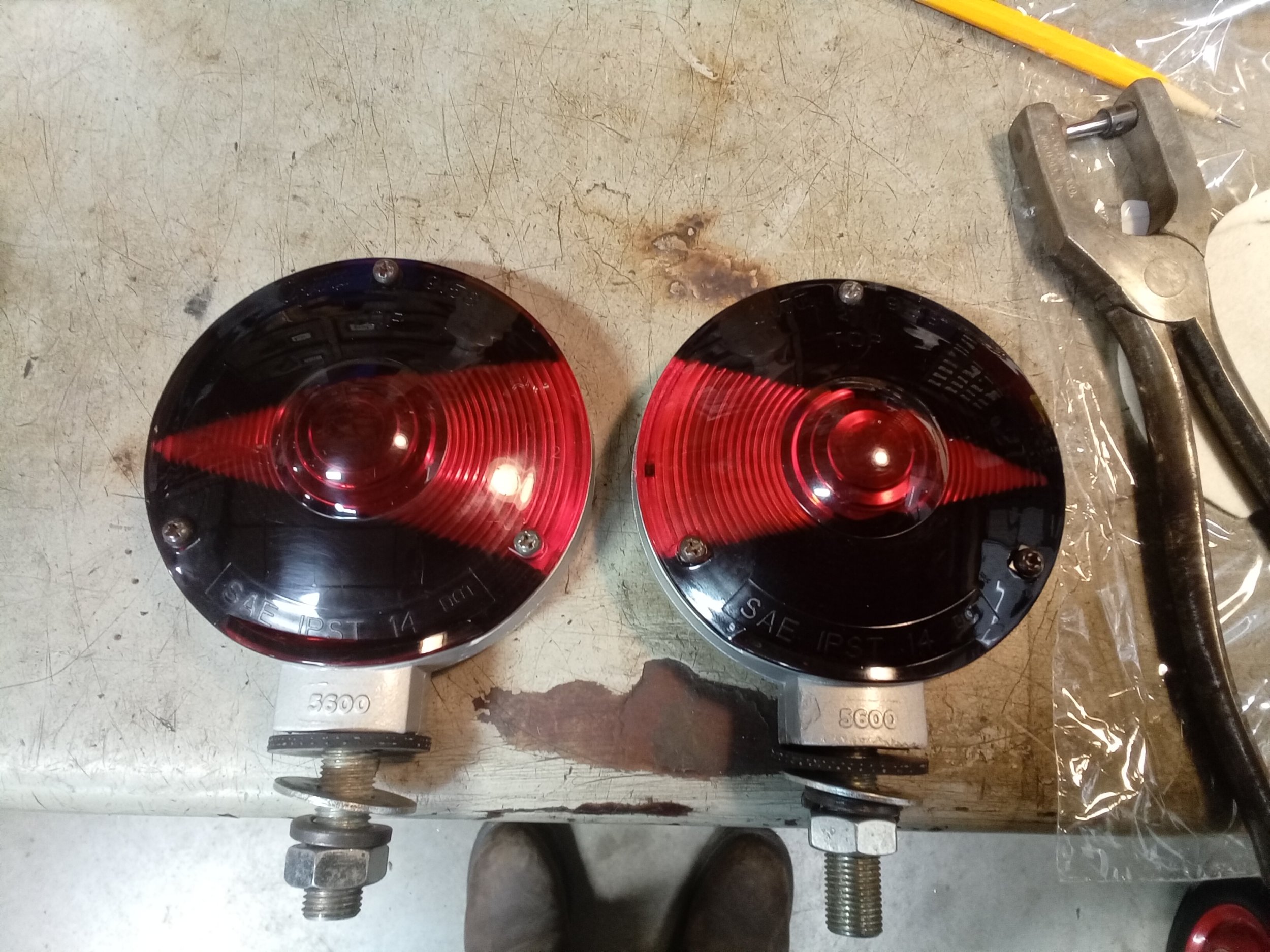

    The truck these lamps are going on is an old work truck I'm restoring. At one point we considered leaving them off and wiring the grill park lamps for signals, but the truck seems incomplete without them both in appearance and practicality. They were pretty beat up and I considered replacing them, but all the ones I've found had chrome bezels while the old ones had an aluminized type plating. The back red lens were broken so I replaced them, and they had also had arrows painted into them, which I added to the new lens. Last piece is I need to add new pigtails and they'll be done.

    what/how did you splice the arrow in?-cool!
  7. 1953naegle
    Joined: Nov 18, 2013
    Posts: 301
    1953naegle
    I just masked the center and spray painted the inside flat black.
