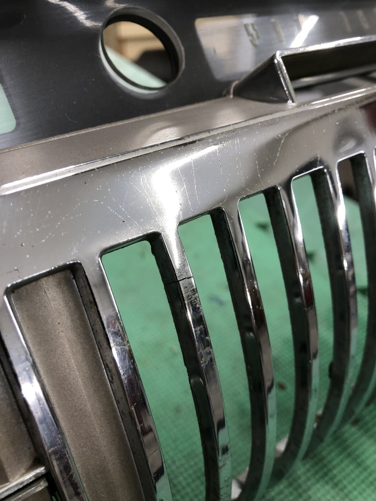

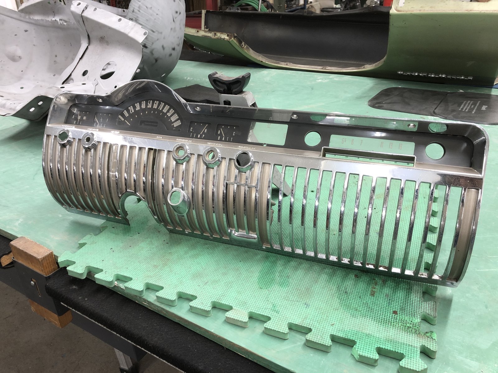

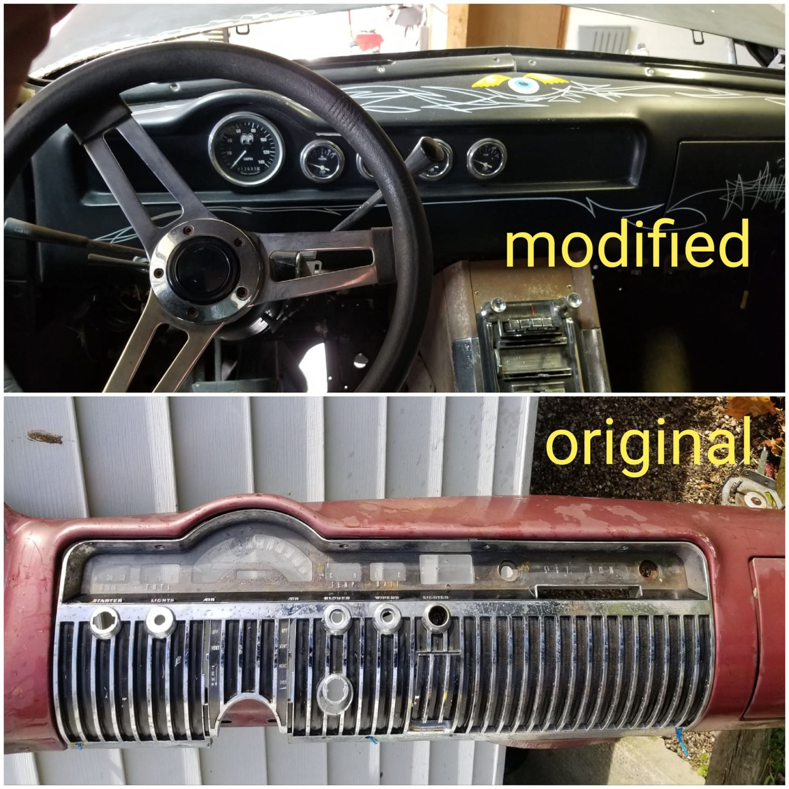

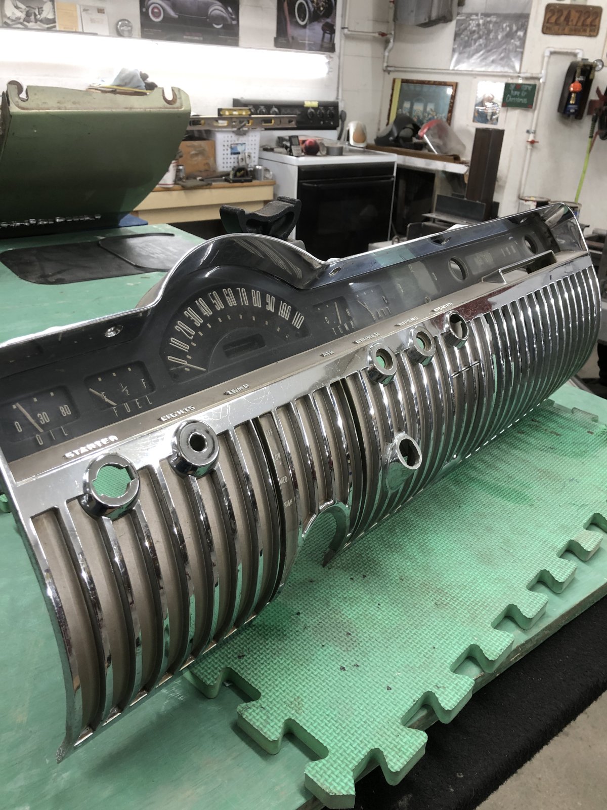

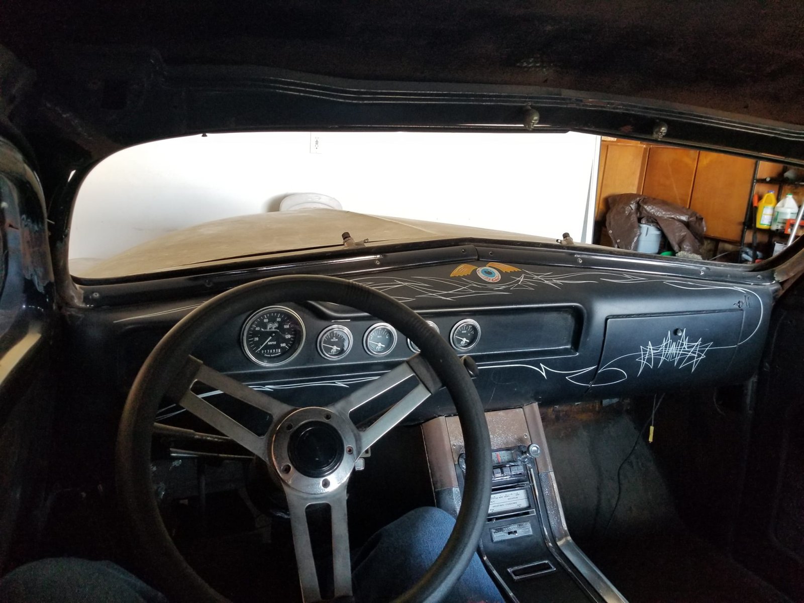

    My 51 has a dash that was filled, and round gauges installed. Looks too hotroddy to me. I found a 51 dash with the ribbed trim, which I plan on running .
    The issue is I have a Thunderbird interior, and the console runs up to the dash, right into the ribbed area.
    I am looking for ideas to clean this up and still look good.

    My only thought would be to buy a '64 Galaxie console top plate and cut it down as a filler panel to go between the T-bird radio and the dash. Could fit in that unpainted blank spot, and carry the ribbed theme into the radio area. You wouldn't be using a lot of it, so you could start out with a hacked up Galaxie piece. Also those little side filler pieces that run the console into the dash, if you can't afford to have them chromed, wrap them in HVAC foil tape or something so they look like they belong there.

    T-bird dash with swing away column to match the rest of the interior?

    Hard to say without the new dash in place and seeing where things line up. More vertical lines on the center console, if they don't line up with those on the dash, will just make it a bigger hodge podge IMO.

  8. Well, I'll throw my .02 worth in here... I've also got a couple of these '50-51 dashes I'm planning on modifying/narrowing to install into my avatar coupe. That factory radio location is the main issue...
    Personally, I'd ditch the console but if that's not possible I'd cut it back so it no longer 'flows' into the dash. The heater controls and radio can be moved into the dash proper as it has the heater controls if you have the bits, you'd have to come up with the heater cables. The radio is more of a problem. The OEM radio was too bulky to fit behind the dash in one piece, so it used a multi-piece ch***is. The faceplate/push****ons/volume and tuning knobs were one piece, the main amp ch***is was separate. I don't think any one-piece radio will fit there, but I may be wrong. I know one won't work in my application. Retrosound radios to the rescue. Their product can be separated into the faceplate, amp ch***is, and separate knobs. My plan is the faceplate into the OEM location (well, shifted to the left after eliminating the clock), the knobs below that in line with the other knobs, and the ch***is in the OEM speaker location. But the knobs could stay with the faceplate if desired.
    That leaves cleaning up the factory radio location. The cut-out for the push****ons is the main problem. If you remove that, it leaves a pretty big hole. My solution is to cut that out and grind all the tombstones for the starter, lights, etc that stick up down flat then t******* a piece of 18 or 20 gauge brushed stainless to cover that whole area. Superglue or epoxy will hold it in place. Cut the right side of the stock lens off then fabricate a new piece to fill it back in. You now have a place for a new radio. Or not; you could leave it blank, maybe install a Mercury script.
    One last note. If you're entertaining any thought of re-plating the die-cast bezel, be aware that the lower side of the instrument opening has a 'pebbled' finish to reduce glare or at least all the ones I have do. If there's ANY pitting there, it's all-but-impossible to repair without visibly altering the pattern. I picked up a very nicely replated bezel but that area is horrible. They tried NOT addressing the pits, which resulted in visible pitting and blisters in the new chrome, which is another reason why I'm grinding it flat and covering it.

    THIS one is staying

    if I am gonna cut one up, I'd start with the one I have.
    I think I will run the whole unit, and then waterfall the ribs onto the console.
