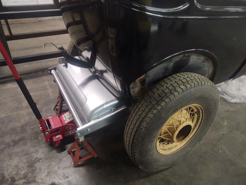

  12. 2935ford
    Joined: Jan 6, 2006
    Posts: 3,848
    2935ford
    Thank you. Much appreciated. It is a fun car to drive and I enjoy it a lot.
    It's a build me and my best friend Paul put together in my garage.
    I no longer have the rear bumper on it. Only reason I wanted on was for tank protection but without better support for it, it kinda flopped up and down while driving.
    Like I mentioned, I was not overly thrilled with the fit of the tank. There is nothing more I can do to tuck it further in as you are limited to the frame extensions and where they weld to the A frame. The tank does what I wanted it to do and I'm Ok with that. Dagel told me for some reason they fit better on the coupes?
    On another A roadster I had, I used those saddle tanks. Problem with those is filling as there is one on each side. A bit of a pain. I like the '32 tank much better. 28 tudor 004a.jpg
    2FORCEFULL likes this.

  18. ALLDONE
    Joined: May 16, 2023
    Posts: 3,227
    ALLDONE
    I ordered the tank and frame horns... but didn't get them yet... but I did measure... mine is 16'' from the cross member to the body.... but I also have shocks there... so that shortens it up to 12''..... tank is 17'' so I could mount it with only 5'' sticking out... but I could also move the shocks to the other side if needed...

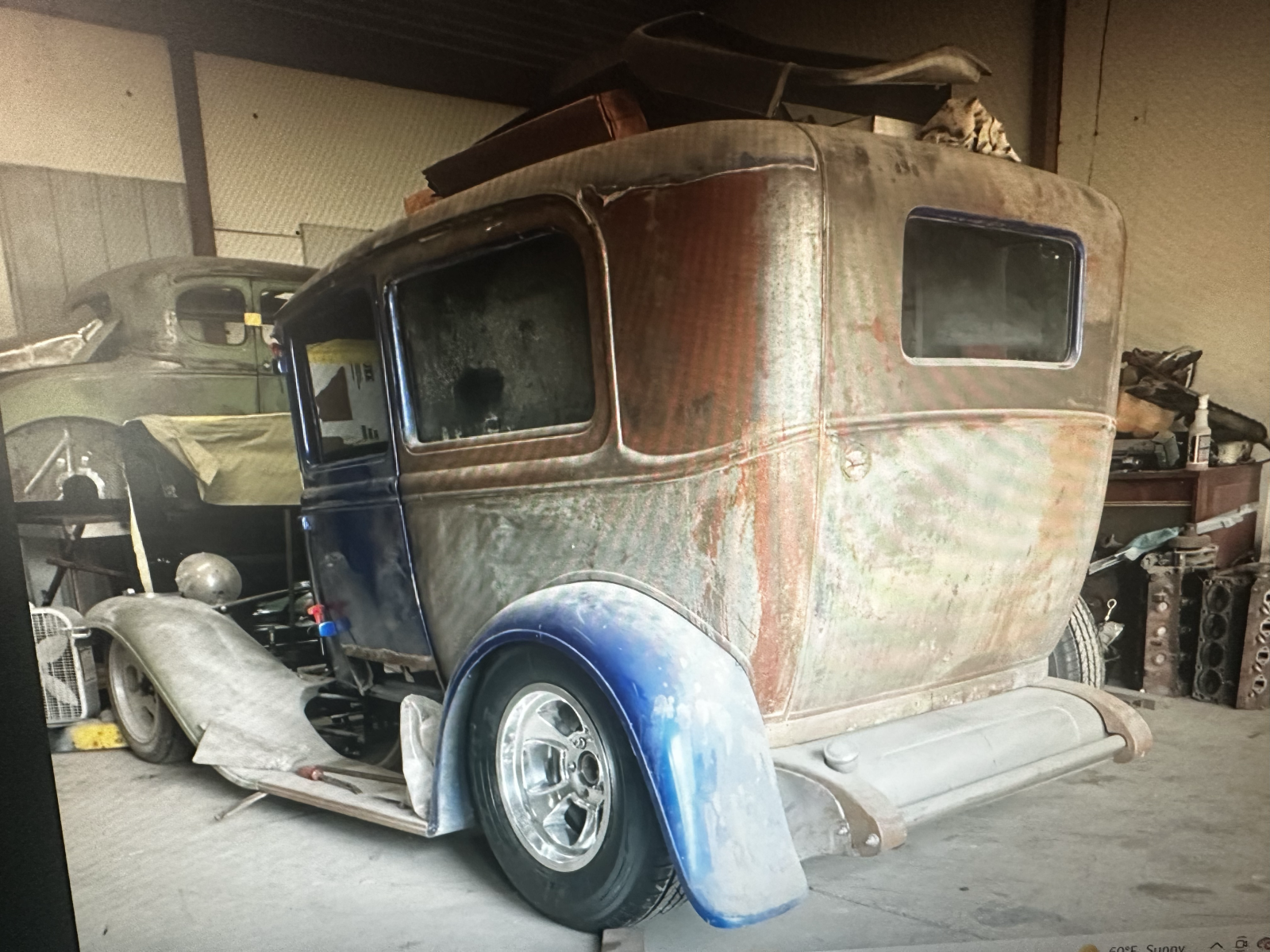

    Sitting at the cross roads.....one thing for sure...the fire wall gas tank is going bye bye....Pretty much sure that I escaped death with the big engine fire I had, and got very lucky...Soooo... what to do and how, is where I'm at...I ordered all the parts to do the 32 tank in a model A... got the tank, frame horns , spreader bar and such.... there's a lot of opinions floating around here... which I personally like as it gets options out there before you do something,... and can't turn back...
    I spent a good amount of time staring at the tank hanging off the back of my model A....not sold on the plan at all...and sitting there on a 5 gallon bucket.... all I can think is there has to be something better.. my direction of build on this model A was to build a weekend racer that a guy drove back and forth to work in the fifty's... took a lot of stuff off to give it the Ol Hot Rod look. .one of the first things to go was the bumpers....and the clothes hamper trunk on the back... I personally like the clean look of a C-dan with nothing back there...
    So,... I'm not gonna start Fabing, cutting anything that will make me wish I never did it when I'm done
    Being it's a Cdan.... there's tons of room In the back seat area...I was thinking, and again just a thought...
    why not put the tank under the back seat and french it down a little to where it hangs lower than the floor??? I would have to cut a round hole in the back corner for the filler tube... , kinda like a pick truck..
    or fab up a fuel door in the back somewhere.. I'd like to do it where there's no paint work involved on the body...
    so sitting on the cross rad bucket, here's where I'm at... I'm gonna start with removing the rear seat and rear floor board,... some thing that I was gonna do even if I use the 32 tank...
    So... flame away.... gimmie some Ideas and dirrection here....what would you do????

  27. ALLDONE
    Posts: 3,227
    ALLDONE
    here's the back of the car...but as of now, the bumpers and frame horns are gone...if you look at the bottom of the body,... theres a about 4'' skirt bolted to the bottom of the body... guess I never paid attention, but I've never seen this piece on any model A.. I used to own a hotrod paint shop,.. painted many model A's ,... all where hot rods that showed up in pieces... never seen this skirt piece ????
